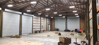

High bay LED's arrived today. $54 each, 14,300 lumens.
Platonic suggested a 3x3 set up, but I opted for 3x2 to save some $$.
I'm very happy the way this turned out! 4,000k color is so much better than the incandescent bulbs. Some shadows, but overall very bright. I like!

Platonic Solid
Nov 29, 2014
3,587
CT-USA
Looking at the report I posted earlier, it shows a 3x4 pattern as optimum for your 40x30 space. As long as you're comfortable with the 3x2 result then that's what matters. :thumbup:

My plan changed, and opted for a mezzanine in the last 10' of the 40x30 space. So eliminated the last row of lights. Then adjusted to fit the budget. Very bright compared to the incandescent 200w's...may need to dim the LEDs : )

Phone lux meter, dead center of shop, workbench height...
Feels almost too bright, but I'll take it...

You can still attach a cheap dimmer (link) to the violet and gray wires if you want more control. Just jump from fixture to fixture and end at the dimmer. On/Off is still controlled by your existing setup as linked control is for dimming only.
Recommended level for automotive mechanical is 93fc @ 30". This doesn't mean that it's the perfect level for everyone or every task. Someone with excellent vision in their 20s can get by with less. 50+ may prefer more.
