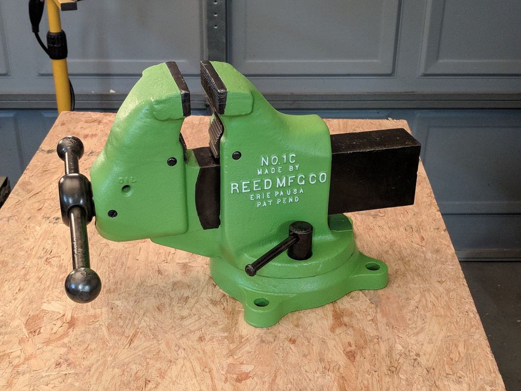

Looks like this Reed R-Series Date Stamp thread is diverging into a more general "Reed Vise" Date Stamp thread. So in that spirit, I'll post two Reed 1C dates:
Reed 1C #1 - Date Stamp "1/59":
Reed 1C #2 - Date Stamp "5/62":
One thing I find interesting about these two is that the first one has cast-in jaws, while the second one has replaceable jaws...so it's just a bit of information to help narrow the timeline for when Reed changed over from cast-in to replaceable jaws in the C-Series. Which matters likely only to me :)

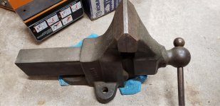

clubairth
Dec 24, 2014
263
Reed 1C. Don't know what year?
has 1072. has some other stamps on back.

I don't see a date but I do see EC on the static jaw. I painted it black so maybe I covered it up. The jaws are pinned in or am I mistaken?
could be on the other side also.
if you wire wheeled it, chances are it is almost gone by now and paint would have filled it in.
your jaws are cast in, or forged welded. sadly they aren't replaceable without milling them out and building new ones

I have a Reed 2C that I am currently restoring. The date stamp on it is October of 1977.
