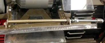

Hi guys, I restored a bench grinder but the guides to support the work were incomplete so I got to thinking how to make some that would make it possible to sharpen hand plane blades and similar things that I’ve always had trouble keeping a straight line on. I wound up making this full width track set up with a sliding sled.
The track extends 5” past the wheels on both sides and tilts up and down so it’s deck angle aims from below center of the wheel, past center, to up over the top of the wheel so your angle of grind is adjustable. It swings upside down to get it out of the way too.
The sled is a 5”x7” plate with 3 - 1/2” square bars tacked onto the bottom so it contacts the track on the outer edges and the inner surface between the 2 rails. There is a 1 1/2” overhang on one edge of the sled so it can be turned around to reach close to the wheel when the track is tilted up. It is tapped for 1/4” hold down fasteners. The big hole in the center (2nd photo) is for a rotator plate I've added.

In this shot (below) the track is turned upside down. You can see the left angle iron mount that join the 2 rails together. You can see how it was cut out in the center to allow the 1/2" square sled guides to pass through. It has a nut welded to it so a long piece of all-thread can pass through from the other side to tighten the track in position.
2 fiber washers are added for friction to help lock the track.
You can also see 2 bends in the grinder arm, one to the right and one back to the left. This arm was bent because the track was 1/32” further from the axis of the grinder shaft on this side and bending it out and back this tiny bit made the track parallel to the grinder shaft axis.
Here you can see the FATAL ERROR. You see the grinder arms have a spacer tube between them and the all-thread passing through. I just used a threaded 1 1/4” piece of round stock for a handle on the end to tighten the track into position. It is locked by a nut which allows the use of a wrench or ratchet but a big hand grip would be nicer. My phone camera has distorted the photo to make things look curved and out of square. The “fatal error” here is the fact that the track mounts have to squeeze in to hit the grinder arms and spacer tube to lock. This causes the track to flex and bind on the sled. Anyone making one of these should put the long spacer tube between the track mounts and make the track mounts fit inside the grinder arms so the grinder arms have to flex to lock the track. A nice thick spacer tube welded between the 2 track mounts would then allow the track to remain square. My other gripe is the all-thread flexes and I wish I’d threaded the end of a strong shaft or bolt instead or used a grade 8 all-thread.
