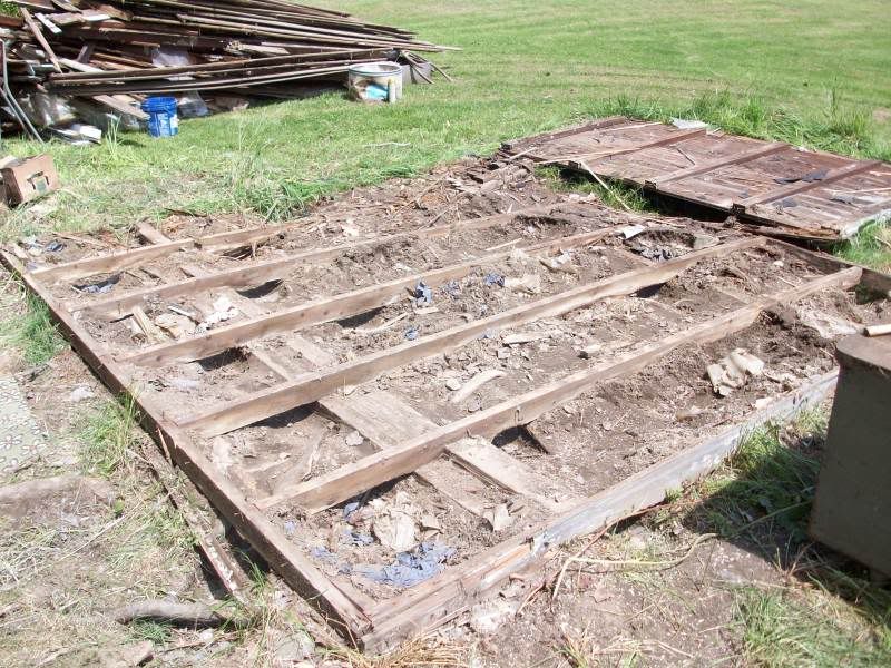

Ok, time for a quick update. This is not the most exciting stage of the work, I don't suppose, but it's some of the most physically demanding so it feels good to have it out of the way.
Horrible, cracked-up concrete floor is gone. I still need to rake up the smaller pieces and carry them out.
I carried the chunks across the driveway and piled them up on an old concrete slab that used to have a large shed on top of it. Another long-term project to bust that up. In the meanwhile, it's a staging area for construction debris.
Here's the old garage door, broken and defeated on the bottom of the rubble pile. I should have taken some pics of the tracks, springs, and hardware, but they are buried now and I didn't think of it then. Definitely a super heavy-duty setup that you don't see anymore.
This loft area is framed with dinky 2x4s across the span of the garage. Obviously undersized to go that far and also support weight. They will be replaced with 2x8s with 3/4 plywood glued and screwed on top for light household storage, probably of my wife's humongous holiday decoration collection. There was a floor of very old, wide planks. I carefully removed them and am saving them for use sometime in the future. I can't get rid of good, aged lumber!
Part of the plan involves changing the front gable end of the garage. Instead of one large garage door, we are hoping to install an 8' door offset to one side, and then an entry door next to that. My builder mentioned the issue of finding a siding to use to match what is on the garage now, which is old tongue and groove boards. Thankfully, I have a shed with the same siding that I had once hoped to save, but realize now it would be more prudent to take down. I am trying carefully to remove the siding to use for the front of the garage. It's old and breaks easily, but I found a method that by the end of the day was allowing me to remove most boards with little or no damage.
Here it is when I started:
Here it is at the end of the day. I would have gotten more done, but had to go slowly to save the siding and also needed to allow time to mow the back lawn.

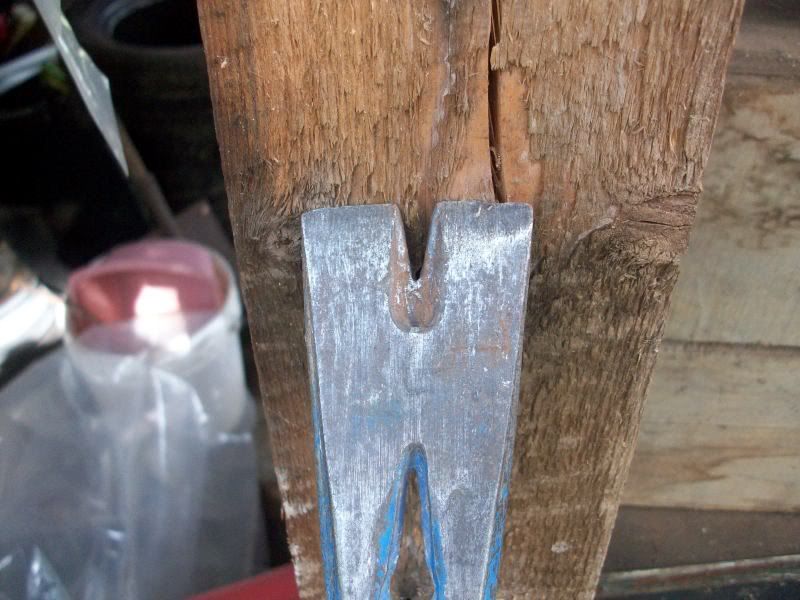

Not being anything more than an amateur, I am often surprised by what I learn about tools by using them. This knowledge usually consists of what must be elementary for other people. For example, I was using my pry bar to get behind the siding and pull it forward to pop a nail head, then pull the nail, and repeat until all nails were out. I then discovered that this V-groove on the bar, which I assumed was just for capturing the head and pulling the nail, works great to CUT them! That method works much better...slip the bar behind the siding, get the nail in the groove, whack the bar with a hammer to cut the nail, and repeat. Much better, and I'm glad I know now, because knowing is half the battle (G.I. Joe reference from my youth.)

i have the same kind of siding on my garage. i guess it was very popular in the 20-40's. but they do still make it. ive seen it at a few places near me in jersey, and i'll end up siding at least the front of my garage in it when i build a new one.(literally just gonna build a blown up version of the one i have)
also for a really easy time with the boards use a wrecking strap, they are much thinner and dont damage as much as what you appear to be using, but i could mistaken. also one of my fav tools is actually a siding/roofers tool. you slide it up under something, find a nail and hook it(hooks on either side of a long thin bar) then there is a bend in the bar. you smack that bend with a hammer and cut the nail. i use it to repair my slate roof

I don't think I've ever seem a wrecking strap or the other tool you describe. I'll look for them the next time I am in Home Depot.

Shed siding reclamation stage complete! It was a beautiful day here today, although I did feel like a cookie baking on greased pan during the high noon-three pm period. But, I saved what I hope will be more than enough siding to use on the front of the garage. Next step: remove old garage wiring so builder does not have to deal with it.
Here is the shed's "foundation" that I discovered under the floor boards. Sunken and rotted are the two words that come to mind. My grandfather pulled this shed onto the property from a neighbor's land maybe in the 1940s or 50s. I can't blame him for the way he set it up...it lasted him for his lifetime.
Demolition completely done and shed pad given a quick rake. I obviously need to spend more time getting the ground here into shape, but that's a pretty low priority at this point.
