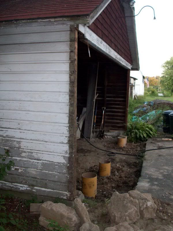

Ok, life has gotten busier for me since last week, but that just means I need to be more efficient and eat my Wheaties!
My builder started doing some other work on my house, so while he is doing that I had him show me where I need to dig for the footings for this project. We need three new footings in the front of the garage for the 8' door and the entry door. These need to be 4'8" down because of the frost here. He said we could get away with 4' since he knows digging these by hand will be a ball buster for me, but I told him no, if we need 4'8" then that is what I am going to provide.

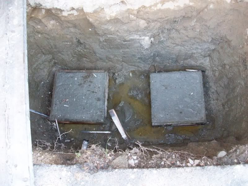

This is as far as I got today...this hole is not deep enough yet, but it's all I had time to do. Was busy with other things until about 3pm, then started on this. Two of the new footers will be going in here. Once I finish this, I'll move on to the other holes I need to dig.
There are a few reasons why the digging is hard:
1: 90 degree temps
2. The first two feet are coarse sand and rocks...lots and lots of rocks from big to small. Plus, old broken concrete chunks. This is what whoever built this structure in the first place used for fill.
3. After the rock/sand layer, you hit hard, hard clay. Got to break it with a pick before you can shovel it out.
Here is a small number of the rocks that I pulled just from that one hole so far. Many others, the smaller ones, were carted away in the wheel barrow to the back of the garage where I am piling the dirt for now. The trash can lid gives some sense of scale:

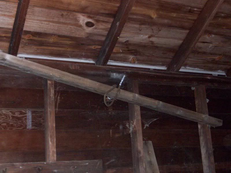

Some minor progress to report. A few days ago, I finished digging the giant holes for the new footings for the south gable end of the garage. Started digging the first of two holes on the east side of the building for my trash can storage deal.
My builder began fiddling with the garage today...just coming up with a plan of attack and doing some preliminary work. I was in the barn working on my car when he called me over to the garage to show me that he had gotten the back wall perfectly plumb...it had to be pulled to the west three full inches. He said it will be the easiest wall to fix.
Here are a few pics to show what things look like now:
Hard to tell in this pic, but the back wall is perfect:
He's set up two adjustable threaded rod things on the back wall...they are actually used for tweaking newly framed walls in new construction, but worked for this purpose, too.
Cable coming through the west wall and wrapping around a 2x brace that spans a few studs:

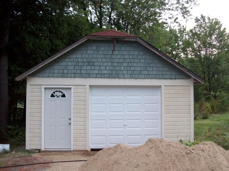

Well, progress has been made, although I have not had time to update each step. Here are some new pics.
Here is the new facade of the building. You can see that I have also stripped most (but not all) of the old paint, which I did with a pressure washer. Good enough for a garage, and waaaayyyy better than hand scraping. Wish I could use the method on my house.
Here is my pile of gravel (11 yards) for the base of the floor. The top will be a local product from a rock crushing plant just a couple miles up the road from me.
Here is a smaller pile of gravel (11 yards was too much!) and two coats of 100% natural linseed oil paint on the shakes on the south gable end. Still needs one more coat. This will match my house. The color (lichen) clashes with the red roof on the garage, but it doesn't leak, so I'm not replacing it just to color coordinate.
Gravel base for the floor. It's not pretty or glamorous, but I am happy with it.
