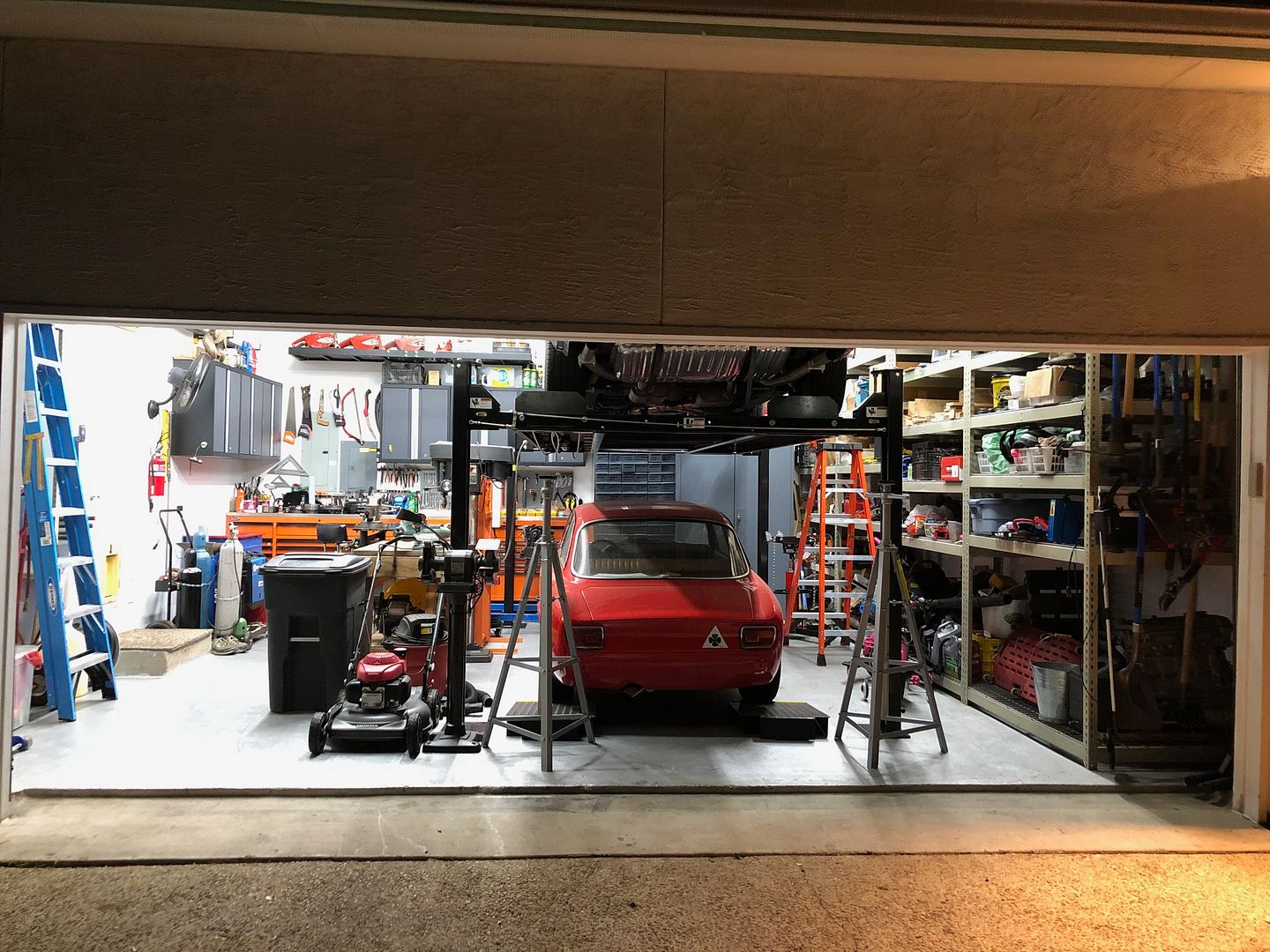

On the lift - hooray! I haven't had a lift in about 10 years. Really missed having one.
Shelf units in place. Have them about 1/3 of the way loaded up now.

Garage is a wreck now, but slowly getting organized. I try to spend at least an hour a day in there; usually in the morning before work.
I ordered two Homak 72" toolboxes - both bottom cabinets - in Competition Orange. Should have them in a month or so. Was going to go with the Harbor Freight boxes, but Homak seems to be better quality, lifetime warranty, and just a tad bit more expensive if you get them from Napa. There's an extensive thread in the Tool forum here with more details.

Today was a good day. Got the NewAge Pro tall wall cabinets hung and also moved the monster Durham cabinet into place. I'll start loading 'em up tomorrow and will get some pics once the dust settles.

bulletpruf
Nov 28, 2013
11,142
San Antonio
Finally at the point where I'm halfway organized!
From the outside looking in...
As you walk in the door and turn left, I have some storage for brooms, mop and bucket, etc.
Moving down the wall, I have my string trimmer (Milwaukee M18) and brush cutter hanging from the ceiling. Nice to have them out of the way. The water heater is behind the door. Next to that is a nice cubbyhole with my Quincy 80 gallon compressor and the water softener. The shelves hold car parts.
Then there's the man door, velvet Elvis, New Age Pro wall cabinets, parts washer, oxyacetylene setup, MIG, and hanging storage for long metal stock and lumber.
More to follow...

bulletpruf
Nov 28, 2013
11,142
San Antonio
Next up - Homak toolboxes with stainless steel top, York 6" vise mounted on top (please excuse the mess; that's a TH400 transmission disassembled on top of the box), more New Age Pro wall cabinets, and hanging shelves from New Age with a few vintage Jonsereds chainsaws.
Really like my Durham cabinet for hardware storage; took many hours of sorting to get some organization. Sure beats the hell out of coffee cans full of grimy bolts and randoms screws, washers, nails, etc!
Not a lot of room between lift and cabinets, but it's sufficient. Lift is not bolted down yet, so I may move it back a few inches.
B
bulletpruf
Nov 28, 2013
11,142
San Antonio
Along the far wall (to the right as you walk into the garage from outside), it's all parts, tool, chainsaw (I have about 70...) and materiel storage. I need to do a better job of organizing; may end up getting plastic totes to store stuff in.
Work area - welding/fab table with a restored Rock Island vise, and next to it is the "portable dirty room" with a restored Wilton bullet vise (it's on casters; gets wheeled outside for grinding and similar dirty work).
Bench is 2' x 4' with 5/8" top. I bought it used, and added the bottom mesh screen shelf and added the angle mounted under the top for clamp storage.
Plenty of room for a full sized car on the lift and one more below.
