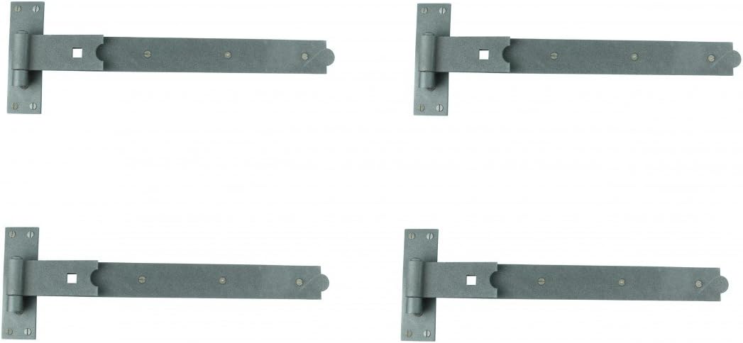

Plan is for a 4.5' x 6 3/4' opening with carriage doors made to match. Carriage doors right now are going to be 7/16 birch ply + 1/2 cedar ply + 1 x 6 cedar boards similar to design below:
Now I am trying to find strap hinges to work with the doors and settled on the ones below (https://www.amazon.com/gp/product/B06Y69R1LS/?tag=atomicindus08-20). I don't imagine the doors will be all that heavy so 3 x per door should suffice.

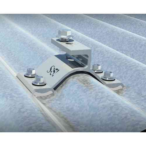

Anyone got any ideas on how to do that and prevent it from leaking? I would basically need to mount a piece of angle iron to the steel roof with 2 screws and the track would hang off that single mounting point.

Nice work so far. Those solar mounts look like they'll work great for your openers.
