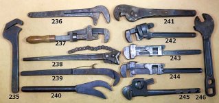

BTW, I found this link and picture of a similar Emmett Wrench #246.
http://wrenchingnews.com/2017-york-auction/catalog.html

Good catch. The 1,870,326 patent is very similar, but there is an extra screw holding the housing together, the throat is not square, and much more importantly, there is no release button.
I'm having trouble deciphering the patent as usual but fig. 2 appears to show a recess(1h) with a lever(15) on the opposite end of the wrench head from where my example has it located. It's confusing (to me) because I don't see it (15) in Fig. 1. Anyway, I'm thinking this lever IS the same thing as the "button", just on the opposite side and end of the wrench head. ....Whatcha think?
30,993
It clearly serves the same function. See lines 55 through 64 in the patent application.
There are a couple possible scenarios here:
(1) The "PATENT PENDING" on the handle could still refer to 1,870,326, if your wrench was built before the patent was granted, and some time between the application and receiving the patent, he changed the design for the pawl release from a lever to a button. There is a lot of precedence for minor changes like that in the tool patent world.
(2) The "PATENT PENDING" could refer to a subsequent patent, patent number unknown, precisely aimed at an improvement on the pawl release, replacing the open lever with an enclosed button, and moving it to the other side of the head.
I like #2, if only because the follow-on patent could've been several years after 1932, perhaps in the early 1940's, which puts my inkling on the strange steel composition back into play. :lol:
