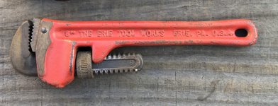

If you're familiar with pipe wrenches, the Long C pipe wrenches in question resemble the wrenches attributed to Ridge Tool Company (first patented in 1925, with subsequent defining patents in 1929, 1932, 1933, and 1940), but also resembling Erie Tool Works and Nye Tool and Machine.
Unfortunately, unlike Ridge, no patents can be found for Erie or Nye pipe wrenches.
Major features of this style pipe wrench are the adjusting nut located behind the housing (not inside it, as with Stillson) and the floating jaw stabilized by two bosses. The only obvious external distinctions between Ridge, Erie, Nye and Craftsman Long C era pipe wrenches are the size and shape of a bar or plate typically emanating from the pin for detachable jaw inserts in the lower static jaw and stretching up the housing (this is tangential, but Ridge actually trademarked the shape of theirs in 1938), and perhaps some slight differences in the size and shape of the bosses behind the adjusting nut.
The 1964 entry in a timeline on the Lakeside Forge (was/subsumed Erie Tool Works) website states that ETW supplied pipe wrenches to Sears for 30 years, which would include the Craftsman Long C era, and Erie pipe wrenches do resemble Craftsman Long C pipe wrenches, except for the shape of the swash plate discussed above.
It has been postulated elsewhere (old GG site, reportedly) that Nye Tool and Machine was the OEM. And this postulation has a lot of merit, since the swash plate on Craftsman "Long C" pipe wrenches and Nye pipe wrenches of this era are identical.
I would like to try to confirm that with examinations of the guides that are inserted into the channel of the housing to keep the floating jaw aligned and stable. These steel spring clips are not all the same across mfgrs.
Ridge patented several different designs. See Pics 1, 2, & 3 for the 1929 patent design, found in pre-war and wartime wrenches (i.e., the Long C era). It is a C-shaped band with three forked tongues on the bottom of the band and a coil-spring hidden in a recess at the top of the hump putting pressure on the band.
Erie had a different design. See Pics 4, 5 & 6. It is a plain oblong U-shaped clip that gets seated on top of a coil-spring in a recess at the bottom.
What we need here on this thread are photos just like these from Craftsman "Long C" and Nye pipe wrenches. Please, ONLY Craftsman Long C and ONLY Nye pipe wrenches that look like Craftsman Long C.
(If you have a Craftsman or Nye pipe wrench and you're not sure of the age, note that the adjusting nut on the Long C era Craftsman and Nye pipe wrenches is FULLY KNURLED and the end or back of the floating jaw is SQUARE. If the adjusting nut has a groove in the middle, two bands of knurling, etc, it is postwar. If the end of the floating jaw is rounded, it is postwar. These are industry-wide postwar features.)

Here are a few more pictures of the Erie spring clip.

Here is a 10” long-C (on the decal) I bought last year and a 10” Erie Pipemaster I bought today for this discussion. Except for the forged-in words and the different shape of the machined static jaw reinforcement, the bodies look nearly identical to me. The adjustment nut is different (Cman has finer knurl), but has identcal threads.
Now...the long-C’s been apart before, and I may have lost the pressure plate at that time, or maybe it was lost before it came to me, or I actually lost the one from the Erie today - I need to be more careful...but I think the Cman is the one that’s lost.
Anyway...the recess for the spring is in opposite sides in these two wrenches: jaw side in the Erie, bulge side in the Craftsman.
Update: picked up a C’man 8” to confirm construction. Seems a match for the 10” I posted here, EXCEPT, the spring recess is on the jaw side!

The clip is the same as Ridgid on the fixed jaw side of the opening but there is a coil spring in a recess on the opposite side of the clip exerting pressure on the top of the moving jaw.
That sounds like the Ridge stabilizer, Don. Just to make sure, see the chart I created below to summarize Ridge stabilizer patents. The 1929 design is the mechanism that is inside all of the wartime RIDGID pipe wrenches, and I thought it was the clip in your prewar RIDGID pipe wrench as well. If not, please clarify. It is C-shaped. The bottom of the C is where the three split tongues come off longitudinally to the channel, that the bottom of the floating jaw rides on. The side of the C squeezes up against the wall of the channel. And in a recess in the hump or top of the housing there is a coil-spring applying pressure against the top of the C, and therefore, the top of the floating jaw. In essence, the floating jaw is being squeezed by two pressure points, the bent spring steel tongues underneath, and the spring-loaded part of the clip up top.

Yes, that's the Ridge patent. If you click here, I posted photos of one of mine on the Long C thread, where this discussion started. If you look at the chart above, you can see the coil-spring in the patent drawing, inside the hump of the housing, to the left of the drawing of the actual clip, which is oriented in the patent drawing relative to the wrench. And you can see that they patenting three other stabilizing clip designs between 1932 and 1940, but it's not clear that they ever implemented any of them. Then, in 1954, they re-patented the 1929 design. They even used the same drawing of the clip from the 1929 patent in their 1954 patent application. So it's not at all unusual to see it in a postwar pipe wrench. I suspect it is in all 1950's Ridge pipe wrenches as well.
Even though your Nye wrench is postwar, I think this is a huge data point. What it means for the Craftsman Long C era, we can't yet be sure, but it clearly establishes a connection between Nye and Ridge. I have been saying from the very beginning that at the big picture level ALL of these pipe wrenches (Erie, Nye, and Craftsman) are Ridge pattern pipe wrenches, in the same way we identify Stillson pattern pipe wrenches regardless of the OEM, and those are the only two patterns there are. It doesn't mean Ridge was making them all, but, like Stillson, there may be fees or licensing or something involved.
I didn’t realize that there was a hidden coil spring in the top of the C.
You must have missed my description of it in post #812 from the Long C thread when I first launched this study. And I posted this patents chart in the same post.
From that thread and post...
Basically, it's a spring steel strap wrapping around three walls of the channel. There is a hidden coil-spring in a recess inside the top of the hump putting pressure on it and those three tongues on the bottom.

I’m not suggesting that Ridge is the OEM for Nye and Erie. But again, I do think there is a connection between Ridge, Erie, Nye and Craftsman. Irrespective of Nye and Craftsman, you know I’ve been postulating a connection between Ridge and Erie for years, going way back to discussions on G503.com. After studying Ridge patents at the doctoral level (HAHA!) for so long, I just don’t see how it’s possible there couldn’t be. Erie, Nye and Craftsman pipe wrenches are Ridge pattern pipe wrenches. There is nothing that distinguishes them other than cosmetic differences (the swash plate, perhaps the size of the bosses behind the adjusting nut, etc). These are not patentable differences.
d42jeep said:
It still seems that the preponderance of the evidence points to Erie being the OE for the long C Craftsman rather than NYE. We need some early NYE wrenches to make sure.
Agreed. As I postulated, Erie may have been the OEM for Nye. And maybe they were also making them for Sears & Roebuck with the Nye-style swash plate. (And maybe Ridge was getting fees for all of those pipe wrenches.)

Ridge was obsessed with stabilizing the dynamic jaw because that was the chief criticism against them from the Stillson lobby. I'm not showing it on this chart, which is focused on the parts of the patent drawings illustrating the stabilizer clips, but the 1929 patent is what added the bosses behind the adjusting nut, and their purpose was also stabilization of the floating jaw.
Those bosses - and then the angular raised plate running parallel to the static jaw, with the pin for the detachable jaw inserts (shown in the 1940 patent drawing, not visible on this chart) - are what give RIDGID pipe wrenches their classic signature look. Early RIDGID pipe wrenches had no bosses, no plate, then the bosses and a trapezoidal plate. As I have said elsewhere, they actually TM'ed the shape of that plate in 1938, and I think it stands to reason that's why we see so many other shapes for that plate on so many other Ridge pattern pipe wrenches branded Erie, Nye, and Craftsman.
The 1929 patent added the three split tongues to the 1925 clip. The 1925 patent already had the clip and the hidden coil-spring. I don't know if any of the other stabilizing clip designs were ever implemented. All wartime Ridge pipe wrenches have the 1929 design stabilizing clip. And Don has a prewar Ridge with the same stabilizing clip.
