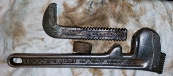

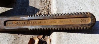

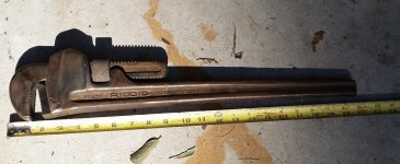

I think I can play the game now, got this 24-incher with a bent handle today.
Jaw: Notice the dots in the "B[dot]8[dot]8" and the "V".
Handle: "Trade Ridgid Mark", "Pat. 1727823", part of the the handle end was cut off.
== EDIT: "Pat. 1727623" ==
Nut: Solid knurled.
My 18-inch rounded-jaw end "Heavy Duty" is not 18 inches and my 10-inch rounded-jaw end "Heavy Duty" is not 10 inches, so I don't know what the measurements actually measure. Both of them have dual banded knurled nuts.

This one I picked up Saturday week ago might be one you want to see. It has B[dot]4[dot]6 on the jaw, a "C" stamped into the jaw housing (your Note 3 pic seems to show something there too), and a fully knurled nut. Wartime I guess.
Be sure to let us know what your research reveals when you can.

This was given to me a few days ago.
I hope to clean it a little soon.
It looks like it was painted yellow at some time.
24
