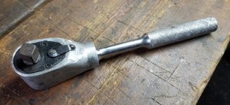

I just picked this up at the flea market this morning. It is not quite vintage by classic standards (minus 50 years, nothing later than 1969), but it's certainly not contemporary, and will be more appreciated down here than on the General Discussion forum.
The name refers to James L. Hudgins, an inventor from Cedar Crest, New Mexico. Perhaps not at all ironically (since I seem to be attracted to alternative ratcheting mechanisms!), the Hudgins ratchet works very similar to the Onli-1 ratchet wrench from the 1920's. (If you're not familiar, see my thread dedicated to the subject and its inventor, here).
That large head has a set of beveled gears inside it, and his first patent for the idea (4,086,829, granted May 2, 1978) actually had a little crank at the **** end of the handle, just like the Onli-1, to turn the gears. His second patent, which is what you see here, eliminated the crank on the back. The gears, and hence the drive stud, are actuated by turning the entire handle. This design is patent 4,311,072, granted Jan 19, 1982.
Unlike the Onli-1, the Hudgins can also be used like a conventional ratchet. When you're in close quarters, and there is no room to swing the handle, you just twist the handle instead.
Ingenious.
I don't know if he made it in other drives sizes, but this is 3/8-inch drive.

The unit is not functioning properly, and I'm having trouble getting it apart.
The two screws in the face plate imply that the entire assembly lifts out, and it does lift out at the top, but it's getting hung up on something internal near the direction selector. Probably whatever is jamming it up.
There are two retaining rings sitting on top of each other in a recess in the head where it meets the neck of the handle, implying the entire head comes off. I'm not sure what that would get me anyway, but I don't have any snap ring pliers that will fit the holes in the lock rings. I tried two different K-D, a Snap-on, and a Waldes Truarc. Very frustrated right now!

This is just a wild guess. but the pawl may be broken and is hanging it up. You might try the old trick of placing the rat inside a clear plastic bag to catch any flying pieces and try a little more persuasion on extracting the assembly.

I guess you need smaller tip pliers.
I was about ready to start grinding the Truarcs! But lifting the head off the handle wouldn't give me access to the pawl and main gear, anyway. It would expose that little beveled gear (33) and assembly.
I'm hoping it's just dislodged or gummed up.
I have had the whole thing soaking for a few hours now.

Success!
Frankly, I think the batman pawl was just stuck in place in its cavity. It's a very tight fit. Too tight. So tight that it won't fit back inside that cavity. Not even squeezing it hard with two thumbs. I literally had to tap it back inside fairly hard a few times with a mallet. And that was just an experimental fitting, without the spring and detent ball in place. There is no way I would be able to hold the detent ball and spring in place and hammer the pawl back in place.
There is a spring steel clip in there, like a spacer, that is not shown in the diagram. It has a hole in it that goes right over the recess for the spring-loaded detent ball. I have seen these before and I have removed them before. The pawl fits perfectly without it. I may experiment with it out.

Lugs, that spacer may be a well-intentioned "repair" to address a percieved weakness in the design. It may be that there is not enough clearance for the pawl with the spacer installed.

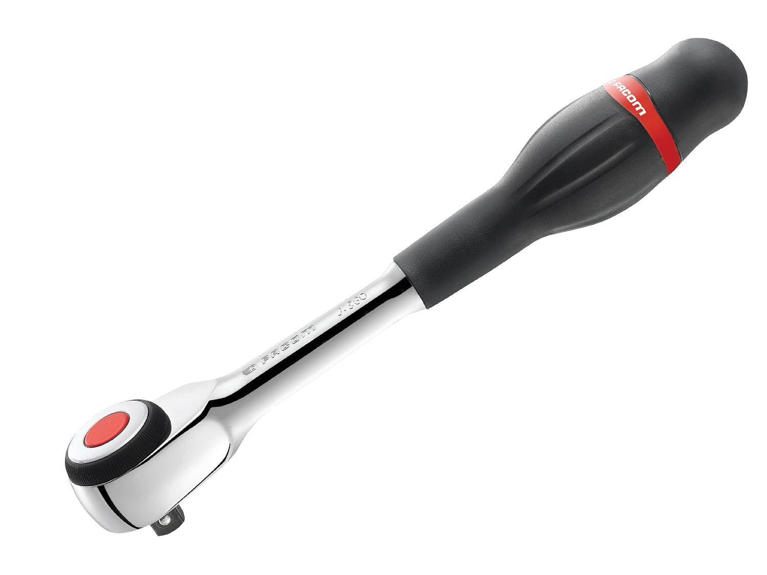

Hi bonneyman. After following 4xdog's lead above, I discovered that Stanley, Blackhawk by Proto, Facom, and Ko-Ken all make a modern version, and they are available in 1/4-inch drive. Search by those names and Rotator Ratchet or Twist Ratchet. They will all come up.

Voi-friggin'-la!
I put it back together without the spacer. I lubed up the beveled gear in the back of the head, jammed the spring and detent ball area with lube to help keep those in place. I used a #11 feeler gage blade to hold the ball and spring down in the recess while I popped the assembly back in place, then slipped the blade out lickety-split. Spins like butter. Changes directions without a hitch.
