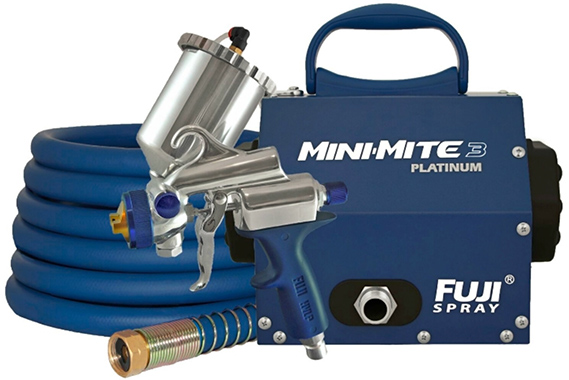

In my experience, a 3 stage HVLP system just can't handle the finishes that are popular today. Natural wood finishes are on the way out and most people want color on their cabinets, built-ins, etc. I have sprayed a lot of Sherwin Williams paint - primarily their Pro Classic line and never got satisfactory results with my 3 stage hvlp. Very frustrating and I could never really get used to having a garden hose attached to the spray gun (even bought the whip, but it was not much better)
I made the decision to sell the Fuji and was looking to go one of two ways. Either with a stage 4 hvlp, like one of the Apollo Models, or since I already had a compressor, a system with a pressure pot that literally could force just about anything to the spray tip. Went with the pressure pot setup with my compressor, and have been very pleased with a pressure pot, not much harder to clean and you can position the gun any way you want.
You might want to try Benjamin Moore Advance. It sprays easier, the only drawback is it has a long recoat time (16 hours or so) and it takes a while to fully harden
https://www.benjaminmoore.com/en-us.../product-catalog/awiap/advance-interior-paint
Thats the Fuji I sold and the gun I use now:

Ryan, I totally get the brush vs spray thing. Been there. I've been using a plastic Wagner Flexio 590 setup that should be a piece of ****, but produces amazing results when compared to my Devilbiss HVLP setup. It's basically a hair dryer with a siphon gun attached.
My brother sprays and really likes Benjamin Moore Advance..but as the previous poster said..it takes forever to dry.
My new favourite for spraying is PPG Breakthrough which is dry in 20 minutes and flows out beautifully.

I paint for a living and train other pros when I'm not doing that. Ninety percent of what I do every day could be done with a three stage with VERY similar results to what I get with my five stage. It would just take more coats due to more thinning.
I see a lot of garage guys buy into HVLP with a two or three stage and then throw their hands up when they can't achieve the finish they want. And most if not all of these guys just were not patient enough or didn't thin appropriately.
That's really why I recommend a 4-stage for beginners. It masks a lot of inefficiencies with air pressure.

This is kind of hard to photograph, but this is the finish I’m getting with SW all surface oil paint using a 1.5 tip thinned to 20 seconds:

Looks pretty damned good to me. Is that a slight hint of orange peel? Hard to tell from the pics, but if so thin a little more. Or if you're already at 20 seconds make sure you have the gun far enough from the part. Stay consistent at 8" or so.

There is a slight texture to the surface, but I don't know if I would call it orange peel or not. I'm actually pretty happy with it.
The only problem I've had is with tiger striping - I think that's what you call it anyway. You could see my strokes with the gun after the first coat.
I think this was due to me having undisciplined control with the gun - too close to the cabinet, too far away from the cabinet, and not overlapping consistently. Since the first coat, I've gotten better and the striping has disappeared after the third coat (I think - it's drying right now).

The stripes and the slight orange peel (if any) leads me to believe you are too close to the part with the gun. Or you were on your first coat.
I always have guys setup an 8" piece of scrap next to the part being sprayed. It helps you visually stay consistent. But it sounds like you have it licked now.
