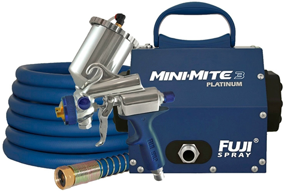

Fuji Mini-Mite 3 Platinum
I like making stuff, but I’ve learned through the years that I don’t enjoy finishing stuff at all. Painting, sealing, staining, etc… it’s all laborious work that requires a kind of fastidious patience that I often don’t have when I’m just excited to be done with a project.
Right now I’m working on a set of built-in cabinets for my wife. It’s the project that got me interested in learning woodworking really… and I’m just now getting to it. The build part of the project as gone by fast and easy and I’ve REALLY enjoyed it. However, the finishing aspect has been a nightmare for me. We were planning on brushing/rolling the satin black color that my wife picked out, so we chose a Sherwin Williams oil-based paint and got to work. No matter what roller cover or technique I tried, I ended up with a finish that I just wasn’t happy with.
After priming, painting, sanding, etc… to no end, I finally gave up and bought an HVLP spray system. I chose the Fuji Mini Mite 3 and thus far I’ve been incredibly happy with it. It works really well obviously, but even better – it’s not a pain in the ass to clean and maintain. And for some reason, that was the one thing that has always kept me from pursuing a spray system of some kind.
In any case, I’m working on a video for this project and once done (and after I get some more experience), I’ll do a full review on the Fuji as well. I just wanted to drop a quick note of relief of sorts. This cabinet project is finally back on track!
If you are interested, I bought my Fuji system here. They seemed to have the best price and their service was great.

Been there, done that, and sold it.
In my experience, a 3 stage HVLP system just can't handle the finishes that are popular today. Natural wood finishes are on the way out and most people want color on their cabinets, built-ins, etc. I have sprayed a lot of Sherwin Williams paint - primarily their Pro Classic line and never got satisfactory results with my 3 stage hvlp. Very frustrating and I could never really get used to having a garden hose attached to the spray gun (even bought the whip, but it was not much better)
I made the decision to sell the Fuji and was looking to go one of two ways. Either with a stage 4 hvlp, like one of the Apollo Models, or since I already had a compressor, a system with a pressure pot that literally could force just about anything to the spray tip. Went with the pressure pot setup with my compressor, and have been very pleased with a pressure pot, not much harder to clean and you can position the gun any way you want.
You might want to try Benjamin Moore Advance. It sprays easier, the only drawback is it has a long recoat time (16 hours or so) and it takes a while to fully harden

Ryan, I totally get the brush vs spray thing. Been there. I've been using a plastic Wagner Flexio 590 setup that should be a piece of ****, but produces amazing results when compared to my Devilbiss HVLP setup. It's basically a hair dryer with a siphon gun attached.
My brother sprays and really likes Benjamin Moore Advance..but as the previous poster said..it takes forever to dry.
My new favourite for spraying is PPG Breakthrough which is dry in 20 minutes and flows out beautifully.

Ryan, I replied to your FOG thread too. Fellow Austinite here. Air pressure is a great mask for beginners as it can hide inefficiencies in proper thinning and spray techniques. However, if you are patient and pay attention to what's going on that spray system you have is fantastic. If you are already successfully spraying that All Surface oil paint, you are well on your way.
I would have rather you bought the 4-turbine unit just for flexibility, but what you have is more than adequate to learn and have great success with. Don't read the internet. Instead, spray spray and spray some more. You will learn quickly.

I paint for a living and train other pros when I'm not doing that. Ninety percent of what I do every day could be done with a three stage with VERY similar results to what I get with my five stage. It would just take more coats due to more thinning.
I see a lot of garage guys buy into HVLP with a two or three stage and then throw their hands up when they can't achieve the finish they want. And most if not all of these guys just were not patient enough or didn't thin appropriately.
That's really why I recommend a 4-stage for beginners. It masks a lot of inefficiencies with air pressure.
