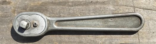

A few months ago on my nightly stroll through eBay, I saw a New Britain made 1/4" Craftsman set with an unmarked Plomb WF ratchet in it. I figured it was a cobbled together set and kept scrolling. Recently I've been spending entirely too much time looking through the catalogs from Mrcraftsmantools DVD set and came across this image. My first thought was that it sure looked like a WF rat to me:

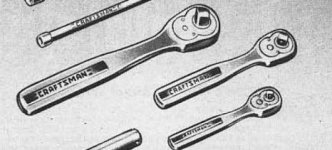

This set is offered from 1945 to 1948. The artists depiction remains unchanged with the exception of the Heritage logo being drawn on the inside of the lid in 47 and 48. It's packaged in the square corner case from the Long C era in all 4 years. It's impossible to determine the maker of the other components from the artists rendering. The open gear NB 1/4" rat is still being offered in sets during this period. I'm guess this was a period where they were off loading NB stock to make way for the Moore dynasty that was to come.
I considered the possibility that the artists rendering just lacked detail and that this could be a Plomb Circle U rat. I discount this as I believe this is what the artist came up with to represent Circle U rats:
Further along, the artist nails the image of the MDF boxheads:
Going back to the original image, it still looks like a WF to me. I don't believe this to be a bad drawing of a Circle U set. I have a 1/4" Circle U set from the original owner and it's in the rounded clamshell box that shows up in the mid 40s. Plomb was in bed with Sears by now and I'm wondering if Plomb struck a deal with Sears to unload some overstock WFs from the war. I was still on the fence about it until another collector told me he snagged a 1/4" set at an estate sale that had all NB components with an unmarked WF rat. That set, along with the one I've seen on the Bay, strengthens my belief that this was available as a catalog set.
At any rate, I've put together this set. Not counting the WF, all the components are NB and marked with the later =CRAFTSMAN= logo (minus 2 Long Cs I have holding spots till I find replacements).
Any input, knowledge, opinions or disagreements are greatly appreciated.

Yes, the same rat Don showed a pic of. Interestingly, my unmarked WF had the selector lever oriented upright like his as well. I "corrected" that to orient it downwards but...
Anyhow...I'm well aware of the Circle U presence at this time but I'm leaning towards Sears sticking unmarked WF rats in these sets to burn up their stock of NB tools. If not, the artist did a damned good job of drawing a WF rat over this four year period when he should have been drawing a Circle U.

I appreciate the challenges to my assertion as it makes me dig harder to figure it out. The presence of one screw really doesn't do anything to pin it down as both WFs and Circle U's had that one screw. I see these differences between the two. Face plate on the U is oval, the WF plate is more of a figure 8 shape. Screw is countersunk on the U, not countersunk on the WF. The contour of the handle differers between the two. The WF contour is a straight line from thin to thicker as the handle widens. On the U, the handle widens initially then goes straight until it rounds at the bottom.
It's difficult to determine the shape of the face plate in the drawing, the screw looks to me to be not countersunk but could honestly go either way but the contour of the handle looks purely WF, not U.
Another thing I've noticed, and this goes to dispute my mixed set assertion, is the hinge handle. The U is a bit shorter, a bit thinner but the most telling difference is the hinge itself. The NB hinge has exposed heads on the outside of the joint, the U does not. The catalog drawing doesn't show exposed heads. I went back to the 43 drawings of NB hinge handles and the artists includes the exposed heads.
I dunno, maybe I'm overthinking this thing. I can't find any obviously Circle U 1/4" midget sets in the gray, rounded clamshell box like the one I own in the catalogs, that would push me to think this drawing in question is just a bad job representing the product. The near perfect representation of a WF rat along with the square corner box the set comes in throws me for a loop and makes me wonder.
Do any of you have a square corner 1/4" case with any part of a Heritage logo remaining inside? If so, what color is the box?
One thing I'm reasonably certain of, this is not what's depicted in the catalog drawing:

Per the catalogs, the midget sets had no 12-point sockets in 1948. They offered 3/16" through 7/16" in 6-points, and the 1/4" and 5/16" came in 8-point in a 15-pc set, and in several different combination drive sets. In 1942, only the 7/32", 1/4" and 9/32" came in 6-point, with 3/16", 11/32", 3/8", and 7/16" in 12-point, and 1/4" and 5/16" in 8-point. The wartime sets and orphans I have had bear that out. I don't have enough postwar sets to confirm that, and I don't have any catalogs in between 1942 and 1948 to know when the broachings switched exactly. The 1945 and 1946 Christmas catalogs, which only show a 1/2-inch drive set, are no help for midgets. You guys with the CD may be able to suss out that immediate postwar era in more detail.
JoCo,
From what specific publications are you getting the 1945 and implied 1946 and 1947 dates from in this statement above? I don't have the CD. I have the 1942 catalog and the 1948 catalog, and, for helping to make some informed assumptions about the in between period, for which no Sears annual catalog is available for free as an open source resource, I have a 1945 and a 1946 Christmas catalog, care of the generous people at Wishbookweb. Please let me know what specific publication(s) the CD is citing for its 1945, 1946, and 1947 sources. There is no midget set shown in the 1945 or 1946 Christmas catalogs. The 1945 Christmas catalog shows a 1/2-inch drive set that is NB-made. The 1946 Christmas catalog shows a 1/2-inch drive set that is not NB-made. It could be Plomb-made. Do you mean that midget set 9 PC 4414 is shown in 1945, 1946, and 1947 annual catalogs?
I am not here to argue. I have no stake and I am completely indifferent to the question of whether Sears was putting Plomb-made WF-pattern (unmarked “WF”) ratchets in factory midget sets or not. In short, it would be cool to confirm that, and no skin off my nose if it is not resolved.
I do have a caution, though. I don’t think any definitive conclusions can be made about what Sears was doing with any of their drive sets in any size in 1948 by using the 1948 catalog.
My copy has an ad for a 115-pc set between the cover and page 1. If you look at that ad page and the first five numbered pages (Page 1 through Page 5), you will find a midget set ratchet shown six different times in six different combination drive sets. It is clearly shown as an NB open gear pattern ratchet in a few (as you alluded to above), clearly as MDF in a few (as you alluded to above), and in the 15-pc set you have shown above on page 5, perhaps as a Plomb Circle-U, perhaps as a Plomb WF-pattern.
For the 115-pc set (99 PCM 4346) on the insert page, the 1/2-inch drive ratchet looks like a Plomb Circle-U (maybe it's an MDF? but it's not NB), the 3/8-inch drive ratchet is an NB Circle-H or BE, and the 1/4-inch drive ratchet is also NB. I don’t think every 99 PCM 4346 set that was sent to customers was outfitted that way.
Now look at Page 3. The 35- and 49-pc sets on the left show all NB rats, including the midget sets. The 90-pc set (99 PCM 4345) on the right shows 1/2- and 3/8-inch drive ratchets as MDF, and a 1/4-inch drive ratchet as something else. Not NB. Not MDF. Could be Plomb Circle-U. Could be Plomb WF-pattern. But again, I don't think that image means that all 90-pc 99 PCM 4345 sets that were ordered came outfitted like that. Or, conversely, that everyone who ordered the 35- and 49-pc sets on the left got sets with NB-made ratchets in them.
If you’re saying it’s possible that some NOS ratchets made by Plomb for the US Army Air Forces with “WF”-pattern dies but no “WF” markings made their way into some Sears socket sets in the early Circle-U contract years, I’d agree. It's also possible that Plomb continued making them with the "WF" pattern dies to satisfy early Sears orders before they went with the Circle-U dies. We know they did that with other customers.
I just don't think the catalog image and the empirical data (sets bought 70+ years later) are enough to definitize it.

Here are captures from the 1945 through 1948 catalogs depicting the available "midget" sets.
What's frustrating is the ad descriptions do not match up to the illustrations. That is, all of the ads describe 6-pt sockets (7/32" to 7/16") but all of the illustrations show 12-pt sockets. If you throw the human condition into the equation, there's no telling what socket type you were going to receive!

I have WF8 with both shapes and countersunk or not. My feeling is the oval is newer than the racetrack, but I have no proof.
