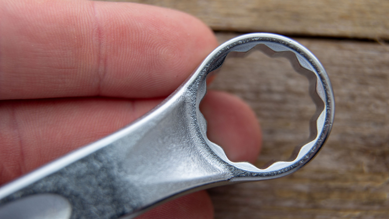

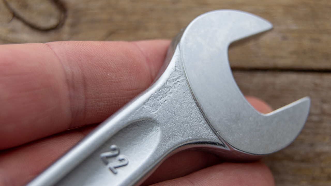

I just got a small set of Stahlwille’s Stabil 20 spanners (20/7N), and to my dismay they are pretty poorly made in vaunted Germany.
I have other Stahlwille spanners, so I knew not to expect a high finish quality. I even called the roughness of German tools charming in another post. This time the charm has worn a bit thin.
In the images below, I’ve used thick and thin blue arrows to show off-centre (non-concentric) broaching, although this is easier to see with the tool in your hand against the light. Try comparing the thickness of the chamfered area around the circumference and, in the case of the 8 mm, the thickness outside the chamfered area.
Red arrows point to flaws in the chrome plating or underlying steel, not that you need my arrows.
Click an image to see it larger.
These are on top of the usual (for Stahlwille) slight asymmetries, grind marks, etc., on the sides of the spanners.
Can’t say I’m impressed.

Off-centre broaching compromises the strength of the head. Put another way, parts of the head are needlessly thick for the strength on offer here.
Chrome plating is used to inhibit corrosion. If there are holes in it, that’s where corrosion starts. You can see that’s already happening on the 15 mm.
Nicks in the surface act as stress risers. Probably negligibly in the case of the notched 14 mm above, I admit.
I will say this: Stahlwille has a premium name but I did not pay a premium price for these tools on Amazon Italy. And perhaps that’s part of the problem here: people like me are using the internet to shop for the lowest prices, putting great emphasis on saving every penny. Is this the outcome of that?
I haven’t touched a fastener with these and won’t: they’re going back so Stalhwille knows that some buyers will not accept anything as long as it has a posh brand name and COO.
(I’ll end up losing money to ship these back to Italy on my own dime, of course. Hopefully that will teach me a lesson.)

Back on topic. They look rough to me. I have the 13 and 14 spanners. As you say a few lumps and bumps on the beams is normal but the box and open ends are well finished. No lumps, bumps or inconsistencies. I would assume that the Stabil 20 should be the same quality as the combination spanners.
Example of what is to be expected on the beams (but was the worst example I could find).
Box ends all look ok to me.

I have a set of lightweight Open Box 13 spanners and a couple of them look like yours, i.e. a bit rough in places. But the box ends are all broached concentrically as in your example. I’d be happy with that.
Not happy with an off-centre broaching.
Maybe there’s something about the deep-offset spanners that makes them harder to centre? I have no idea how these things are made. The Stabil 20 shape looks impossible!

The 8 I might take issue with. ALL brands can produce off centers, my worst is a snap on 16mm. Never really looked too closely until all the SK threads here. On an 8mm, it's likely is irrelevant.
I see no issue with the 15. Matte finish usually produces defects like that. I wouldn't be concerned about it. Little nicks in the finish, again I'd probably be fine with. Ask the vendor if they can swap out the 8mm if it bothers you.

They aren't perfect, but you also got them cheaper than most Taiwanese sets. The offset broaching doesn't make for great closeups, but none of them look like they're so thin they'll break.
The only one that worries me is the 15mm. Those rust spots line up perfectly, which makes me suspect an impurity/flaw that penetrates the entire thickness of the wrench. If I had to pick which one is going to break your knuckles, it's that one.
I thought those marks may have been where the spanners were pinched to hang them from the rack in the plating bath. There’s a mark on the 8 mm where the plating is incomplete in the same area.

my 600lg 10mm Hazet has incomplete chrome plating in a few spots never thought anything of it.
All my german sets, Elora, Padre and Hazet have this ring of non chrome plating where they were pinched while chroming I guess.
It's really noticeable on the Hazet, not so much on the Padre and on the Elora it's just peaking tuough.. their not defected.

Holes in the plating are of course defects, whether by design or manufacture; the only question is how much they matter and whether you let the company away with it because it’s German and prestigious.
However, the defects in the chrome plating are the least of my worries in this case.
