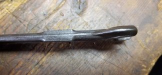

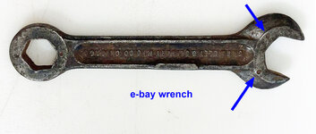

Found this wrench at a flea market this morning.
The open end is 21/32” and the 6-point box end is 1/2”.
According to this Wordpress blog on Gormully & Jeffery linked here, and this Chicagology article linked here, G&J started making bicycles in 1878.
When they split up, Mr. Jeffery went on to form his own company, making automobiles, in Kenosha, WI, under the "Rambler" name. Yes, that "Rambler." Counting these early cars and the later versions that AMC made, Ramblers were made without interruption from 1909 through 1969. In fact, my first thought was that this was an auto kit wrench.
The OEM is unknown. If I had to guess, it would be a Chicago area mfgr, but there is some merit for Billings & Spencer as well. The wrench is a substantial, serious tool, very well made, smartly finished, and the panel, the meeting of the shank and the head, and the beveled jaw exhibit a handsome design flair.
It is actually my second Gormully & Jeffery wrench. I have this tiny (3” long!) adjustable bicycle wrench marked with a logo that reads “a G & J Product” inside a rhombus.
Hard to believe the combination wrench is older than 1900, which is forged and annealed, or that it was made in the same timeframe as the tiny adjustable bike wrench, which is pressed steel and nickeled. But it is dated by G&J aficionados to 1894 to 1899 G&J bicycle toolkits, and an example with a similar and similarly marked wrench (with a pry bar end instead of a 6-point box end) is shown in this forum here.
Any ideas on what the boss on the edge of the shank would be for? Thumb stop? Prying?
There aren’t too many examples of G&J tools on GJ.
four.cycle posted a 3” G&J bike wrench like mine on the ‘Tiny Tools’ thread, linked here. Nklamerus also posted one on its own thread, linked here.
I haven't been able to find any other combination wrenches like mine, or any other G&J tools.
The name shows up in the ‘List of U.S. Mfgrs’ thread, linked here, and the ‘Old Logo ID Markings Guide’ thread, linked here.
If you got ‘em, post ‘em. Maybe we can collect a whole virtual kit. :)

That's cool that you got it with the cardboard packaging! Billings & Spencer made an adjustable similar to these, with the screw open like that, with no stabilizer, which is why I am guessing they may have made the combo wrench. But that's just pure speculation. I have not been able to find much about it, or many other examples.

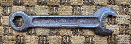

I found one this week. Just like yours except it is missing the Gormully & Jeffery marking on one side. It looks like it might have had letters forged on that side that were ground off. If they were ground off, I wonder why?.
Also curious about the 4 partially drilled holes around the open end jaw. I assumed it might have been an owner's ID marking. However, it was weird to see one on e-bay that also had holes in that same spot.

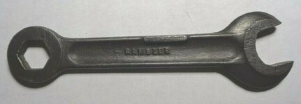

The little 3-inch adjustable is the extent of my own Gormully & Jeffery collection, but for educational purposes, here are a few other examples from a website everybody loves to hate:

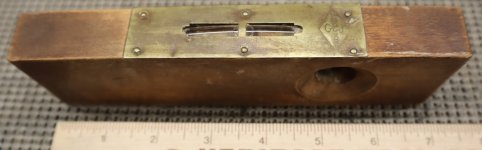

Something to think about. I have some G&J tools made in Germany and Japan. Could it be that G&J Products was not related to Gormully & Jeffery? First is a 7" Level made in Japan that simply has G&J Products on the brass plate. Then I have several ratchet screwdrivers that are marked With " A G&J Products Germany". The ratchet is similar to what Yankee used. Searching I also found a whistle.

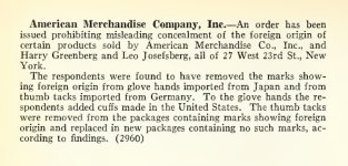

And, according to a 1933 query, Greenberg & Josefsberg made a pair of 3-inch calipers marked "G&J Products Made In U.S.A".
Very interesting!
If the attribution of the ubiquitous Little Crackerjack Wrench and Screwdriver to Gormully and Jeffery does turn out to be an old pervasive case of mythinformation, I will find it hilarious. The entire hand tools websphere has made that association for a long time.
Thoughts:
/ It's not just seeing the initials "G&J" or the whole term "G&J Products" on these various objects that is startling. It's the fact that the term is inside a diamond or rhombus-shaped outline! Too much to be a coincidence. And note that the whole logo is apparently trademarked (Gesetzlich Geschutzt) in Germany.
/ When do we think most of these other G&J Products were made? They certainly don't all look antique. Why is that important? Gormully & Jeffery were only a business entity until 1900. There was no G&J after that. Jeffery formed the Jeffery Company to make Rambler automobiles in Kenosha, WI.
13,514
I think Eric just debunked this one. We should've questioned it earlier. The yellow NOS carboard packaging (see post #4) is not old enough for G&J to be in reference to Gormully & Jeffery despite the vague bicycle connection.
I was going to say the same about the ratcheting screwdriver noted above. I see many Yankee looking screwdrivers stamped Germany and West Germany, and they seem to pick up the later (newer) features, making me wonder if they were part of war reconstruction factories. Did maybe MF send outdated equipment there when they upgraded (just a pet tin foil hat theory of mine)? Would then make more sense as the second company than a pre 1900 company.
P
31,049
None of the products look 19th century. That's what I was referring to here...
My point was that Eric thankfully posting all these other < G&J Products > (which none of us have ever seen or noticed before) broke the ice, but that well-known bicycle wrench in a yellow cardboard pkg that had been sitting here on the thread never made any of us go, 'Uh-oh', and it should have.

I haven't done any further reading than the FTC blurb I found, but it wouldn't surprise me to see G&J Products to be very much like a Spiegel Brothers type outfit.
Spent about 30 minutes on Google Books this morning and I lost count of the periodicals, journals, and law reviews of them being cited or involved in some litigation surrounding them skirting or bending the rules on tariffs or customs in the 1930's, and then again in the late 1940's and 1950's, including Occupied Japan, Occupied Germany, and China! Also, several patent infringement cases. These guys were classic NYC importers and distributors. I also lost count of the articles, from watchbands to cigar lighters.
