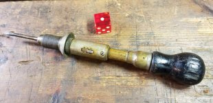

Picked up this 1908 patent North Brothers "YANKEE" No. 35 at the flea market this morning.

Those with the conical collar are a bit rare. Here are some images with references from a tool pusher I know.
https://swingleydev.com/ot/get/270511/single/
There is a picture in Joe Ward's North Brothers' Yankee collectors guide, published in 2000 (no known updates), on page 186. He says that feature probably appeared on each wood handled model, but he didn't know what its purpose was.
https://www.amazon.com/Brothers-Manufacturing-Company-
Product-Handyman/dp/B002VF29QU
