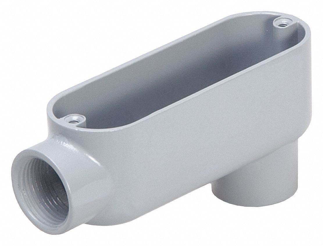

It's on city water. About 60 ft as the wire flys. 6 is fine to supplimental rods but does the city water call out a number 4 egc.
Last one I bent thru 2 inch lb was copper. I remember doing one about 25 years ago 4/0 alum but I can't remember how difficult a double lb was?

I was questionin the difficulty of 4/0 thru 2 lbs. I don't need to run the ground thru them but it is 60 ft to city water entrance from the electric service. I believe the water is considered primary in this case and the rods suplemental. Does primary require a 4?

You sometimes need an interpreter for sberry!
LB: it's a conduit fitting for 90 degree corners.

a 60 amp existing service entrance is being upgraded to a 200 amp service. The existing box has room to be upgraded. The supplemental ground is a city water service. Code says a 6 ga ground wire to the supplemental is adequate, but city wants 4. How hard will it be to route that #4 copper through two 2" diameter LB's?
I might have missed it, it may be 2 questions: Will the city require #4 ground conductor or is the code minimum #6 okay? Can I route a 200 amp service 60 feet underground through 2" conduit with two LB's?

If I have lead time I have it delivered etc My helper was no poster child of ambition for part of the day but well worth his keep when we had a problem bending the wire thru a couple joints. As I mention earlier its been a couple decades since I did it al. When I did mine I used a trough and had enough drops to do it no cost. I did one customer a while back copper and it was a little work but could be done and he already had the wire.
