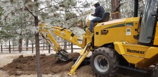

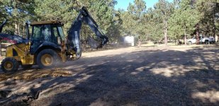

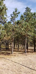

Then what follows is some photos of Site Prep:
- removal of 3-rail fence (before and after)
- moved 6 trees rather than cut them down
- Initial site prep -- bringing in 40 tons of fill dirt (of a total of 1,200 tons)

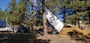

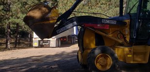

The above photos showed the size of the trucks bringing the dirt. The below photos show the heavy equipment moving the dirt and making dust.
At the end of day one the ~350 tons of fill still is 2-3 feet short of filling the end of the site that requires the most fill.
The blue tape on the T-bars mark the required height of the pad.

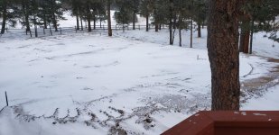

Well, the GC saw the weather forecast for Thursday 10OCT19 and decided to push hard on Wednesday. Good Call.
The temp in NE Colorado Springs at noon Thursday was 12° with an accumulation of 3-5" inches of snow. On Wednesday, the high was 81° -- that's a 69° swing in 24 hours.
GC figures he is within an inch of the target grade and will made that up with the dirt that he pulls out of the holes for the poles -- some of the holes will be 36" in diameter. Ought to be about right.
GC moved, compacted, and graded 1,147 tons of dirt in 3 days. He said he's done more dirt but not in that period of time.

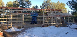

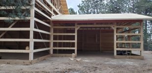

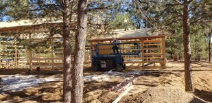

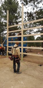

Two weeks of clear weather and I have significant progress
-- Windows Delivered
-- Pedestrian Doors Delivered
-- 90% of Girts Attached
-- All LVLs Attached
Photos below
Trusses to be erected in week of 28OCT19 to 01NOV19 weather permitting.

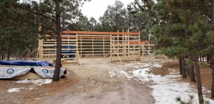

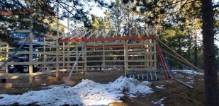

Well - the plan to erect trusses during the last week of Oct (28OCT-01NOV19) was pushed to the right when Colorado Springs got snow on Mon, Tues and Wed of that week. And the temps those days were in the 20s.
The crew showed up Thurs when the weather broke a little bit and shoveled all the snow out of the footprint of the Hobby Shop and for 10 feet around the perimeter. This gave them a nice firm and dry surface to work on rather than a muddy field. It paid dividends.
On Mon 04NOV19, the crew erected the 13 trusses on the 24x24 storage building

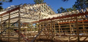

They said the 25 trusses on the shop area (48' wide and 36' deep) would be finished the next day (Tues 05NOV19).
I was doubtful -- not because of the quality work they were doing but -- I watched them erect the first truss. Lots of hard work. That wall is 14 feet tall and the truss has 2 feet of soffit on each end so they are 40 feet wide.
I made a 30 sec video as they installed the first truss. It's way too big to post, though. These four guys are brothers; dad owns the construction company. They are Amish and it shows in all they do

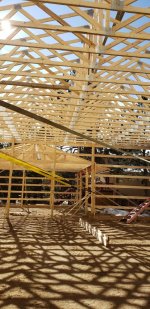

They were true to their word. At 3PM I came home from part-time job to see this.
The second pic was taken with my back against the wall of the shop looking back toward my house. It also shows the turnbuckles used to square up the walls. They had run a sting along the top of the 14' walls and snugged up the chains until the three center poles were within 1/4" of that string.
The last two are about the same. They show the 24'x24' storage area with 10 foot walls and a 8x9 garage door. Behind that is the 48'x36' hobby shop with 14' walls (tall enough for my 2-post asymmetric lift

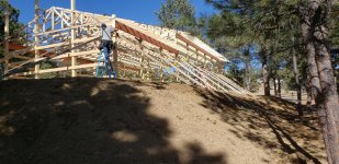

I did want to post a shot of the back of my structure. This perspective also shows just how much fill needed to be trucked in to level the construction site: 1,154 tons of dirt. The near corner in this pic has 7 to 7.5 feet of fill.

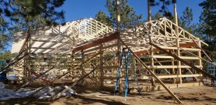

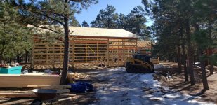

The last week (04-08NOV19) has witnessed continued visible progress.
Monday the 4th of Nov through Thursday, the crew placed half the roof on the large shop, covered the entire roof over the 24'x24' and placed two courses on the back-side of the large roof.
The weather in Colorado so far is really playing havoc with the schedule for the floor to be poured. After the roof is completed (on Mon 11NOV19) and the exterior sheeting added to the walls (the rest of next week), the plan is to:
  1. Lay 10-mil vapor barrier
  2. Install 2" close foam insulation
  3. Run the lines for the in-floor radiant heat, along with manifold
  4. Pour concrete
The "interior" photo is angled upward showing half the roof being covered

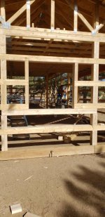

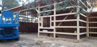

Nothing much visible has happened on my build lately. The technical stuff is that stiff backs were added to every girt to strengthen the structure -- necessary to provide rigidity and to support the stucco.
Extra vertical boards were also added onto each post between each girts.
Not very exciting but necessary.

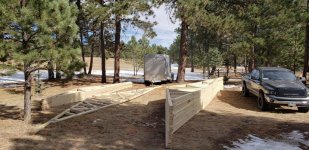

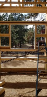

Lot's of movement in the last several days -- 13 thru 16 November 2019.
First window framed - a view from inside and out.
The long view shows windows framed along the long rear wall:

Did they compact the fill?
Yes. Good question
They brought in 1,154 tons of fill in 46 loads (~25 tons per load). As each load was delivered and spread, it was compacted using the tracked Cat and wheeled John Deere back hoe.
The pad is very firm. Prior to the pad (et al) being poured, they are doing a final grade and fill to get everything level and smooth.
I wasn't expecting the fill to be as deep / as tall as it turned out (see photo posted on 06NOV19). Next spring I am having pavers laid in layers to provide support to the steep slope of the fill.

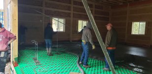

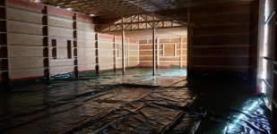

I enlisted the help of a neighbor and installed a 10 mil vapor barrier (https://www.wrmeadows.com/en-ca/perminator-underslab-vapour-barrier-canada/) across the entire floor. That was Saturday 30NOV19 and my knees are still aching on Monday. The real pain-in-the-a$$ was taping around all the poles and the tape itself. I didn't realize I needed to tape the vapor barrier to the walls so I was really really short on tape.
Of course I made this discovery at 4PM on Saturday. Bought two more rolls of tape (at $38 each) on Monday (02DeC19) morning and finished the job.
Another contractor is scheduled for Thursday (05DEC19) to install foam insulation and lay the lines for the in-floor heating system. Concrete scheduled to be poured on Saturday 07DEC19
The first photo clearly shows the depression for the extra concrete to be poured for the 2-post lift. Since I haven't yet decided on the lift I had an extra large area dug out to maximum placement options of the two-post lift posts.
The second photo looks in the opposite direction and is a stage for my latest change -- made after a friend with 40 years of wrenching in his own shops and others gave me some new ideas. The key to the latest change is the three spaces between those poles you see in photo 2.

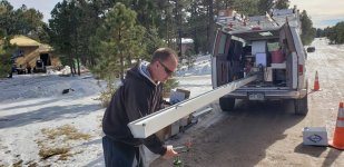

Monday 02DEC19 saw the gutters/down spouts being installed and the soffits being installed and readied for paint.
The soffits have all the vents installed and the holes drilled for the LED can lights (9 lights on the front and rear of the building).
Assuming the weather holds (forecast says high 40's to low 50's° F) the plan is to paint the entire exterior of the structure on Tuesday 03DEC19 -- fingers crossed.
shortykorte
Sep 1, 2014
8,039
Tallahassee, Fl
You’re off to a nice start. I’m amazed at the amount of fill since the before picture looked somewhat level. What is the loft going to be used for? Just wondering because the stairs can take up a lot of space.

Right on schedule - Thursday 05DEC19 the contractor arrives to install Crete-Heat insulation and heating tubes.
Pictures tell the story.
