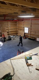

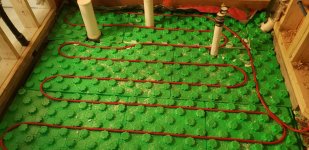

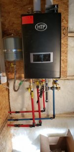

The last week of February saw some progress. Not much to see but significant strides forward:
  • Put sheeting on ceilings
  • Insulated walls (R19) & ceiling (R49)
  • Installed boiler for in-floor heating. Boiler also heats domestic water and includes the pumps to circulate the glycol.
Pictures show details

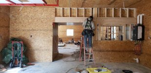

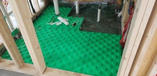

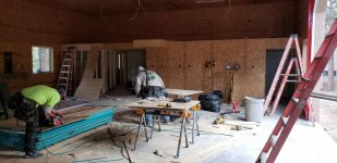

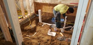

I had a short gap in any work while my work crew did some work on another garage/barn they are putting up. The weather was too mild to miss the opportunity to work outside.
The first few days of March saw the rough-in of the bathroom and installation of the boiler.
The second photo of the bathroom shows placement of the features:
left-rear = toilet
right-rear = shower
left-front = sink
off camera to the left = outside of bathroom will be a janitor's sink

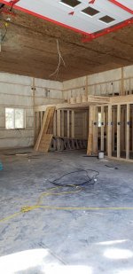

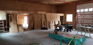

A week later (10-11MAR20) the work crew returned and installed the sheeting in the high bay and loft. On 12MAR20, they started sheeting the the smaller room and trenching for the propane line.
The next focus is plumbing the propane line from the tank to the boiler and getting the in-floor heating fired up. Once the building is warmed up, the wall seams can be sealed and the walls painted, and then the ceiling lights can be re-installed.

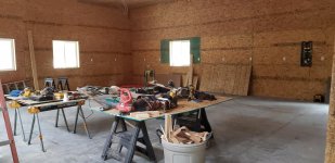

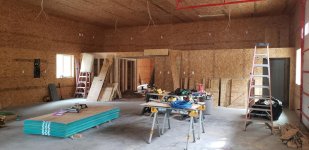

Right on schedule, the crew worked the last few days and on 16MAR20 they had sheeted all interior walls except for the bathroom (it still needs some plumbing stuff before walls are closed in)

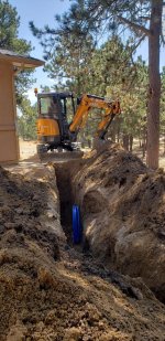

The past coupla days saw lots of work that resulted in really very little: I now have water flowing into and out of my bathroom. No sink, toilet or shower in there yet -- that happens next week.
One day for each line to be dug in and connected.
Water In on TH 09APR20: dig down to level of water line from well and tap into it. Oh yeah -- then ya gotta put the dirt back

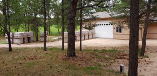

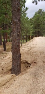

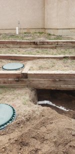

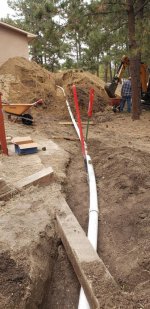

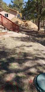

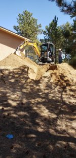

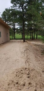

Then on FRI 10APR20, the same crew assembled to tie into the septic tanks and ultimately to the leach field.
Same process: dig a hole, put pipe in and replace the dirt. The process was a bit more time consuming to get the proper drop over the run for the gravity feed. The red spray painted marked both the path to dig along and marked existing under ground obstacles

But here are the specs on the three different types of lights I installed
MAIN SHOP – 14’ Ceiling
• 7x HB 150001 50
• LED: 18” x 30” 150 Watt (Dimmable)
• 18,500 Lumens
• 5,000° K
• $150 each
STORAGE – 10’ ceiling
• 4x TCPGPS8UZDA840K
• LED: 8’ Strip
• 8,500 Lumens
• 4,000° K
• $75 each
DIRTY ROOM & BATHROOM
• 3x LVT 5600140
• LED Vapor Tight
• 7,300 Lumens
• 4100°°K
• $85 each

Shovelhead
Thanx -- I appreciate it.
I didn't measure it nor do I have a tape measure long enough to cover it, but I would guesstimate 115' - 120'.
Odd question -- -- -- why?
Craig
Shovelhead
Dec 22, 2018
397
DEEP EAST TEXAS
Shovelhead
Craig
odd question because I'm an odd feller.......
Because if ya ain't got the right drop in that distance, yer **** gonna be coming back at ya. :D
Actually I'm going to be building a shop before the house, on our retirement property. Trying to gain as much info as I can, considering sharing the same septic.
I know I can go with a grinder / macerator pump to move the goods to the tank but would rather not.
There's a "standard" drop per foot for a solid septic line to the tank but I can't remember it right now. Country boy plumber would know.
Just curious how far yours was.
C
Craig Balzer
Sep 21, 2005
876
Colorado Springs
Shovelhead
I used a 35' tape measure along the terrain, so this may not be exactly accurate, but figure 140-145 feet. The tightest corner was right at the exterior wall -- two 45° angles about 3-4' apart formed a right-hand turn. It was a fairly straight, slightly curving run to the septic tank. The line had a 45° angle as it passed through the wall of the tank.
While my GC was able to get the proper drop along the run for a simple gravity feed, I may ultimately end up with a grinder pump. The last 30-40 feet is a close thing.

Took the next step in completing the bathroom in my garage. The contractor worked (28-29APR20) on
  • Correcting errors made during initial rough-in
  • Replacing and taping down 10-MIL vapor barrier
  • Installing Crete-Heat insulation
  • Running Pex Lines in bathroom floor
NEXT UP -- pouring 4" concrete pad in 7.5' x 7.5' bathroom floor.
Craig

Baby steps now as I move toward completion.
Not much to look at but just sorta connecting things
On 01MAY20, the downspurts were buried and the drains extended away from the building
On 05MAY20, the black pipe was hung from the NW corner of the building to the boiler (that is mounted 2/3 of the way down the east wall). I also had the guy install a small extendion off the verticle pipe for a future, if-needed feed to a Reznor (or similar) propane heater.
The punch list is getting pretty short:
  1. Pour concrete in bathroom and driveway
  2. Trim around windows and doorways
  3. Epoxy floor
  4. Mount staircase to loft
  5. Install fixtures in bathroom
  6. Mount sheeting on bathroom walls
  7. Move In

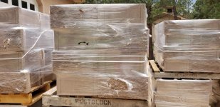

Haven't had much to post in nearly a month. Got side-tracked while working an issue with all the fill I needed to bring to level the site pad. I trucked in 1,147 tons of fill (or was 1,153 tons?); that resulted in one corner (the SE) of the site having 7.5 feet of fill.
The next step was to pour the concrete apron and a patio on the south side of garage. My GC really felt a retaining wall was needed before bringing in all that additional weight.
That slowed me down a month+ while I got bids from retaining wall contractors, made my selection, and then got on his calendar.

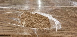

The build of the wall will begin on Monday 08JUN20. I'm not sure if these pallets represent all the blocks for the retaining wall or if more are coming. The contractor said he would need 888 linear feet of wall. The retaining walls (there'll be two of them) will be 4 feet high; the double wall ought to begin near that large tree at the back of the garage and wrap around the corner likely near that other large tree.
Craig
