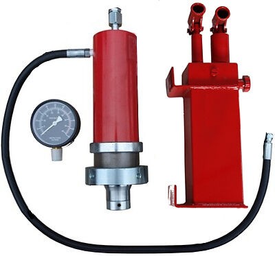

I'm planning to build a 30 ton hydraulic shop press & I'm looking for the hydraulics.
This is the style of Hydraulic Set-Up I would like to use!
However I haven't been able to find anything reasonably priced.
Does anyone know of a source for a reasonable priced hydraulic ram & pump?

Not suggesting you are going to save a lot but have you looked at Surplus center?
https://www.surpluscenter.com/hydraulics/
Any reason you don't want to go electromechanical?
I'd be looking at an automotive power steering pump if I wanted to go cheap. There's not a lot of flow, but along these lines there is not a lot of flow with a hand pumped setup either...

Yeah I have looked at a few places like that, But I really don't know that much about hydraulics to figure out the pressure & flow rates needed.
For rough numbers the ram force (tonnage) will be the hydraulic max pressure * piston area...which is pi*(d^2)/4.
To calculate the speed, there is a "cubic volume per rev" rating on the hydraulic pump which could be expressed in GPM (gallons per minute).
So you can equate gallons to cubic inches with the factor of 231. The volume of the cylinder is its area * stroke in cubic inches. Eventually the X-gallon cylinder will reach full stroke in some number of minutes.
Some examples..using a 4" dia x 8" long cylinder, it has a piston area of pi*16/4 = 12.56 sq in. 100.48 cu in volume.
Suppose pump has 2500 psi and 0.8gpm. Cylinder will develop a max load of 2500*12.56 = 31,400 lbs or ~15 tons. Cylinder has 100/231 = 0.43 gallons, so roughly 30 seconds for max stroke and 30 seconds for return. Slow by some standards but if not used much who cares. More GPM always requires more motor HP and gets more expensive.
You also need a tank and a directional valve.

I used THIS CALCULATOR & figured out that I would need a cylinder with a 5" bore and a 2500~3000 psi pump to get the tonnage I want.
That size cylinder would probably take way too long with a hand pump like this one which is on the order of what I'm looking for.

I found these items listed locally on eBay which I thought were pretty good deals.
eBay item number:183773621715
eBay item number:263208185049
Just copy the numbers only into the search for anything box and the items will appear.
Remembering these are listed in Aussie $'s so you can roughly multiply the amount by
a factor of 0.7 to give you a US$ match.

The second pump is what I've been looking for!
Other than the expensive one I mentioned before, I haven't had any luck finding one.
I found a air/hydraulic pump
That may work, But I'll still need to find a cylinder to match the pump.
I'm hoping to find a complete hydraulic set-up.

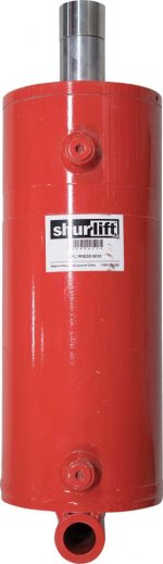

I did find a big cylinder (6" Bore 2" Ram) designed for making a hydraulic press & it would work good with the 3600 PSI hand pump I mentioned in post #12, But it looks like it's only available in Canada?

Nice, it sound like you need to take a drive north then.
Exchange rate will help you as well.
