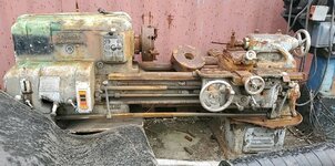

Decided not to pollute / dilute my main shop build thread with too much on the Lathe so i'll put most of the work here. I also post on Practical Machinist for some of the more heavy duty hitters are over there.
Been wanting a lathe for many years, but just never found the right one for me. Occasionally checked my sources, craigslist, facebook, want ads, local sources, etc, and came close a few times, but never saw the right one/deal. Until one day i checked for lathes on facebook marketplace and found this little :)wtf:) gal:
At a shop in Fort Wayne, IN, shop was getting cleaned out and there was a time limit for removal. I also had logistics to deal with as this thing is HEAVY. Much heavier than any other anything i'd ever moved. But as an engineer, i understand mass and forces quite well, i just needed to be creative.
Went down on a Saturday for inspection and found this:

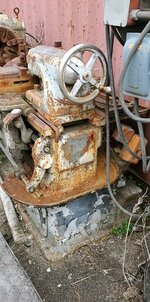

So what we have is a 1943 vintage, 18 speed, American Tool Works Pacemaker in 16x30 size. The owner had it listed as best offer. I offered 500 sight unseen, with caveat that the headstock couldn't be locked up. My searches on PM showed it weighed about 5500 lbs, and at current scrap prices it was worth about 300 as scrap. As i inspected and found that the tailstock was frozen and the carriage didn't move, but the headstock seemed fine and it shifted gears fine, the headstock, being completely sealed, should be ok. I offered 400 and he said he had an offer at 400. I offered 450 and he took it. Reality is he wanted it gone and didn't want scrap price. He had nothing big enough to move it and would have paid someone to lift into his dumpster. Win win for everyone.

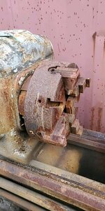

So far, the only stuff i've seen that's a problem is the tail stock is frozen, that's a gotta-have, and the apron has a broken lever. That can be fabricated. The taper attachment has a couple missing pieces but those hardly ever get used, so it's not a problem. This particular model is so bullet proof, they rarely are irreparably broken. You simply can't hurt em. They're so rigid you can't push em hard enough to break the machine without breaking the part, the tool, or scaring yourself so badly you back off on the cut.

Looking at it again, I think the extra chuck is missing the external threads on the backplate; assuming it is an L series spindle. I have an L1 on one of my lathes. Here is a couple charts I found and saved.

I thought the same thing. I don't know what is going on there. Open to ideas or suggestions.
It's still got the taper and keyway.

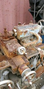

Anybody know what the lever does? Doesn't appear to do anything. I am also ecstatic to report my tailstock is no longer frozen. It spins a full 360 degrees.

The lever on the off side of the tailstock from the operator should be both a lock and a drag for the tailstock ram. You can use it to adjust feed feel for drilling to keep a drill from being grabby in softer materials, and to lock the ram when turning between centers.

As far as the chuck, I wonder if it had the threads bolted on with those 3 holes somehow. I would think that the bolts would have to go down through the ring as close as they are to the center hole. Weird.
I bought a brand new 3 jaw for mine that is a plain back so I need to decide whether to remove the backing plate from the old one or make a new one or buy one. I have not found a new one for any less than what I paid for the lathe, so rather not do that.
