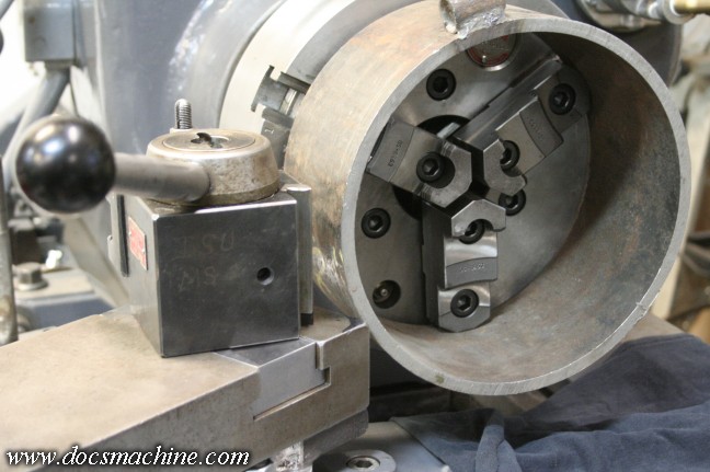

CPCO has a package for 213 for CA size. Just have to decide if i want to go with a standard type or something more esoteric like a dickson style.
-CA might be a touch of overkill. I have a slightly smaller CXA on my 16x56 Springfield (actual swing being closer to 18.5".)
Here's a pic of the CXA compared to an 8" piece of pipe in a 10" three-jaw:
And just for the sake of the argument, I'm a big fan of the Aloris dovetail style. It's fast, repeatable, easy to swap blocks, blocks are easy to make if you want to go that route, and dirt-common, so extra blocks can be had easily and if you buy import, pretty cheaply. (I splurged on real Aloris pieces for my monster- bought used, of course, I'm not made of money. :D You can occasionally find a score on eBay, and you almost don't have to worry- you basically can't kill or wear out a real Aloris.)

-Neither could I, that's why I found a good used one on eBay. :D
On the CA/CXA thing, it's kind of a toss-up. It's nice to have the potential strength of the slightly bigger CA, but on the other hand, how often are you planning on taking a full-power, full-depth cut?
There's also the tooling to think of- CXA takes up to 3/4" shank, CA takes 1". Used 1" shank insertable-carbide holders go cheap on eBay, since industrial places don't want used-and-abused, and few home-shops can take tooling that big.
But back on the other hand again, the big inserts those things take can cost $40 each. Plus, the big inserts tend to have minimum depths of cut- it's hard to do small detail work with a big 3/4" IC negative-rake insert; trust me on this one, you smear the metal off, rather than cut it. :D
Assuming this is a machine for a home shop, doing day-to-day fab on trailers, trucks and hotrods, chances are you're going to wind up preferring a lot of 1/2" and 5/8" shank tooling, for easier detail work on smaller pieces (and not, say, trying to peel 1/2" chips off a 350-pound casting. :D )
It's easier to put a smaller shank tool in a 3/4" slot in a CXA than it is to fill in the 1" slot in a CA. (You run out of height adjustment, have to use shim blocks, etc.)
Really, either one will work, I just think the smaller of the two- which is still a gigantic, beefy post- is better suited for general day-to-day use.

I thought i read somewhere that the CXA was at the upper edge of the adjustment with the center distance on a 16" pacemaker? Might have been a different forum, not sure.
-As I said, I have a 16" with an actual swing of closer to 18.5", and a CXA puts the tool on center right in the middle of the tool block height adjustment.
However, not every lathe is the same, and for that matter, mine has a custom-fitted compound off a different machine, as the original was missing when I got it, and had been replaced with some import piece.
Go to the Aloris website, they have full drawings and measurements so you can measure from the top of your compound to the spindle centerline, and see for yourself which would be the best fit.
(Mine came with the undersized compound and a BXA toolpost, which had been mounted to a 1" thick block to get the tool height right. A bigger compound and a bigger CXA solved that. :D )
