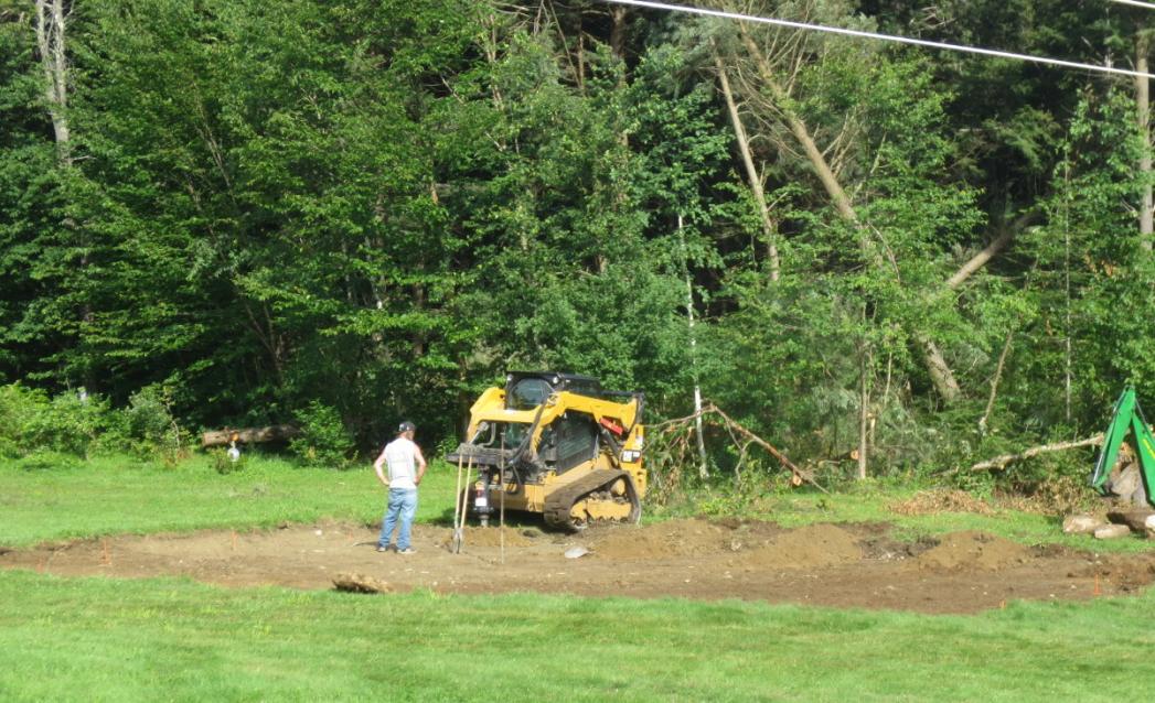

Bought my house in the Berkshires Hills of Western. Mass in 2001 and have dreamed of building a barn/workshop since then. Three summers ago I finally broke ground on a 25x35 pole barn. Besides the cement slab, I have done all the work myself...taking my time and doing my research. I am a high school teacher by trade. But I've got some decent skills I've picked up over the years. My summers off is when I really made most of my progress. The barn is 90% complete. Thought I'd introduce myself with a build thread.
The barn is 25x35 with 12' walls and a 12/12 pitch roof.

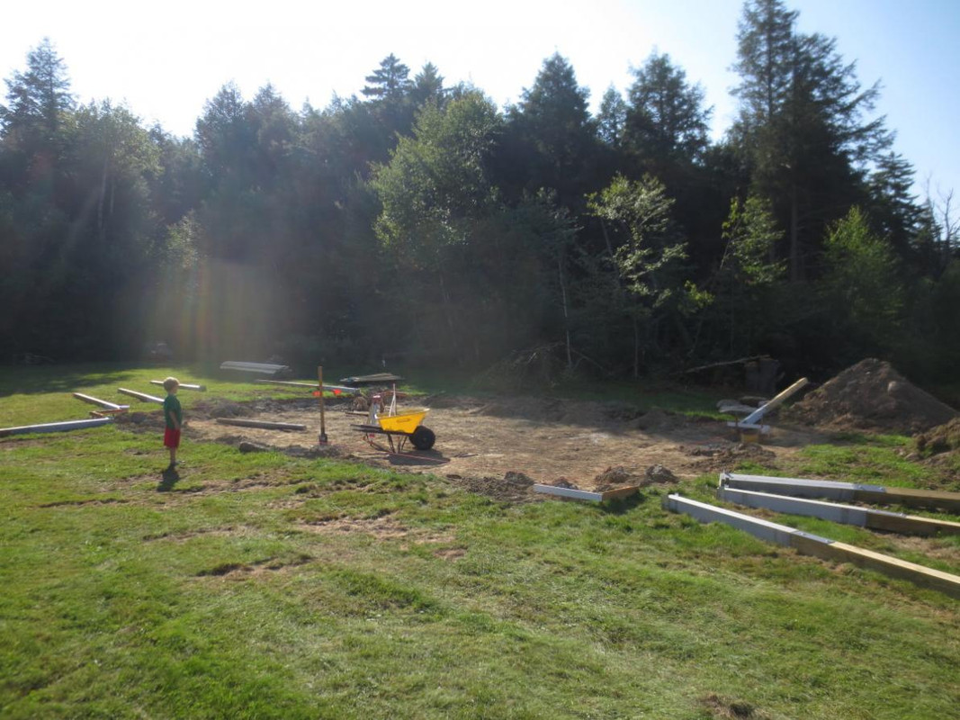

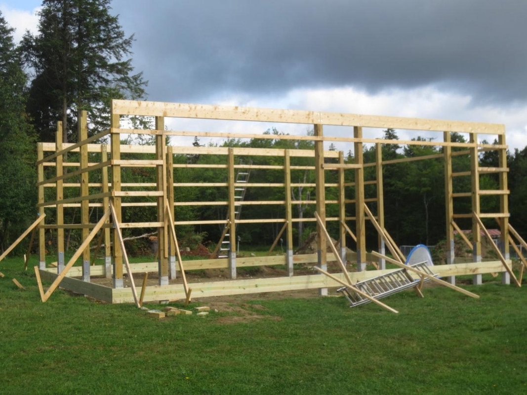

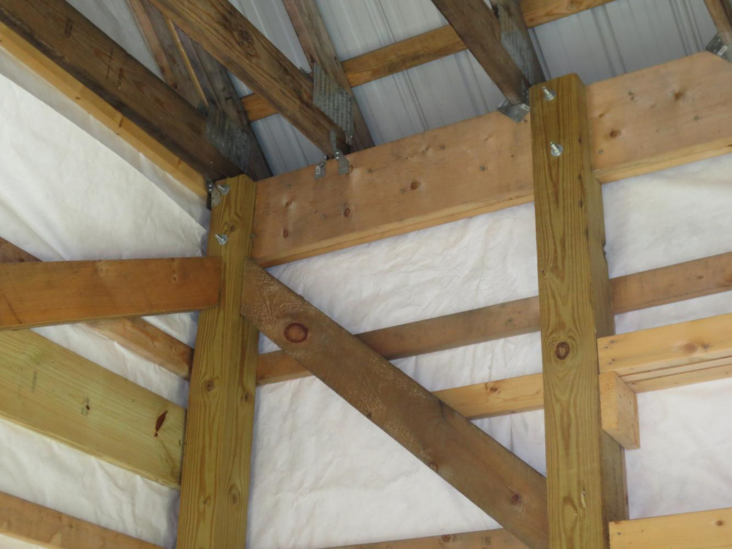

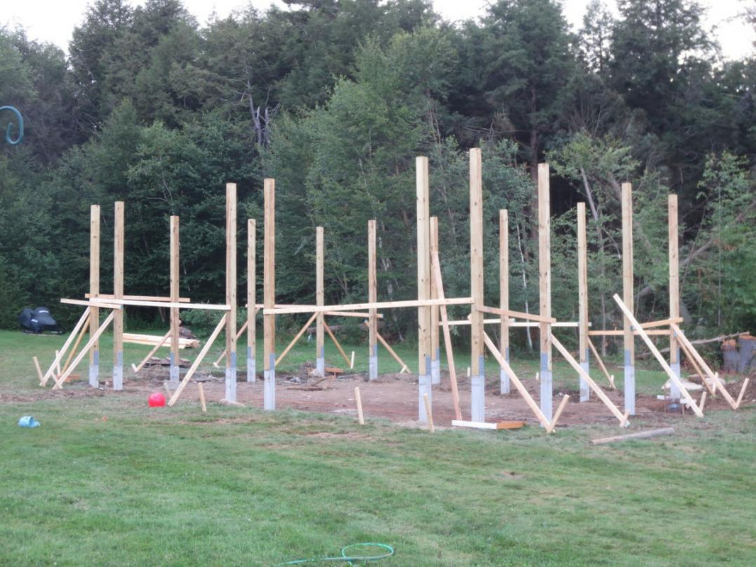

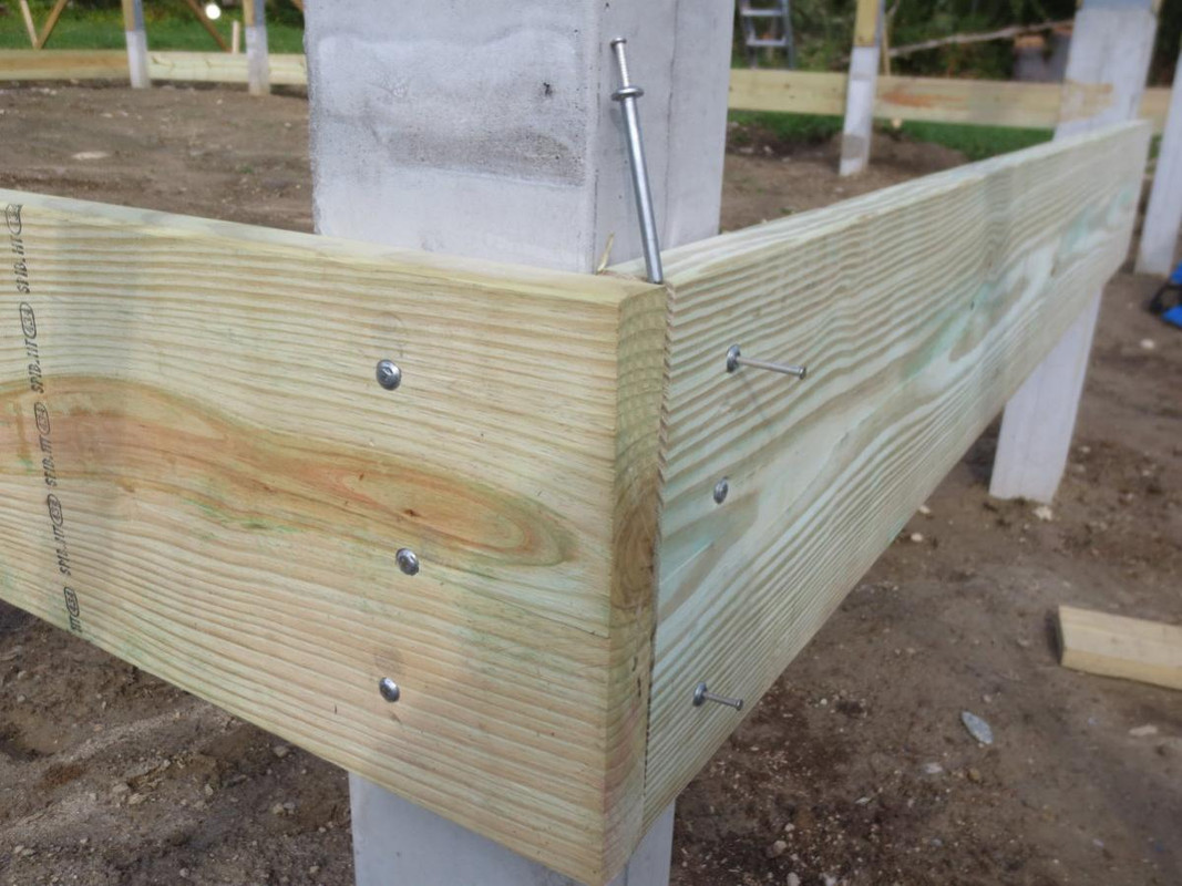

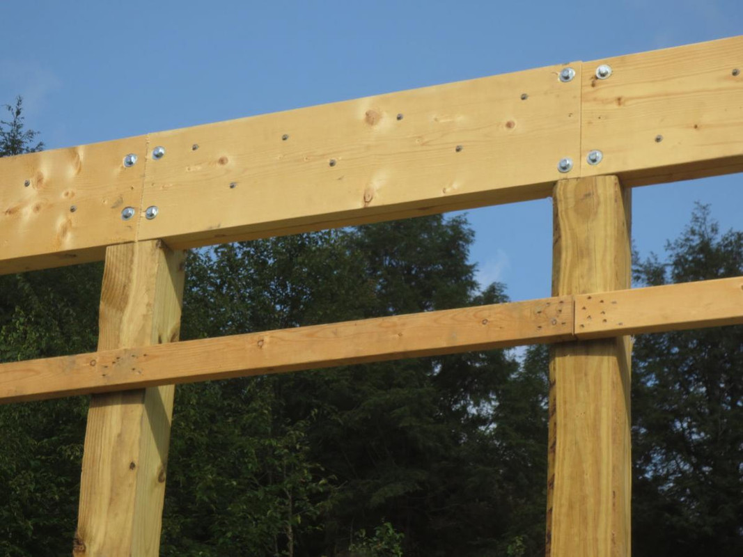

This set shows the holes being drilled and my posts going up. I did not want the 6x6 PT posts to be in contact with the ground. I know they are PT, but I've seen 6x6 PT posts here in New England rot off at ground level. I used a product called Perma-Columns. They are 5' long pre-cast and reinforced cement piers. The 6x6 post bolts into these and the wood sits above ground level. Drilled 16 holes and only had to pull one massive boulder. Got lucky. I notched in and bolted the double 2x12 top plate and used stainless fasteners for the skirt board.
Summer of 2017.

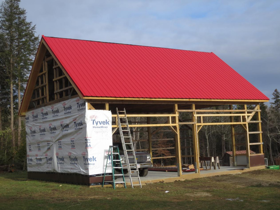

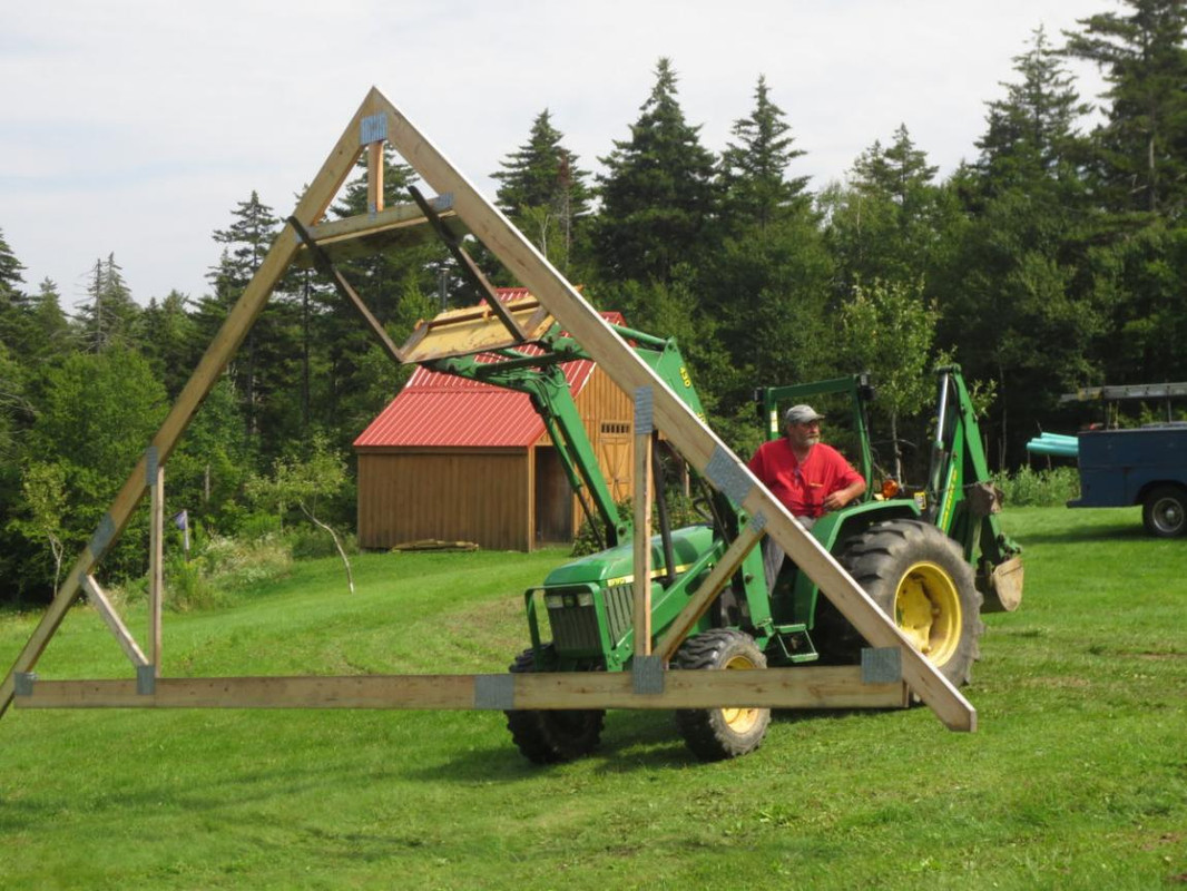

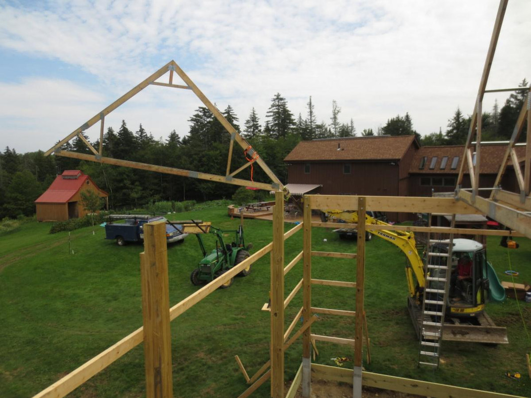

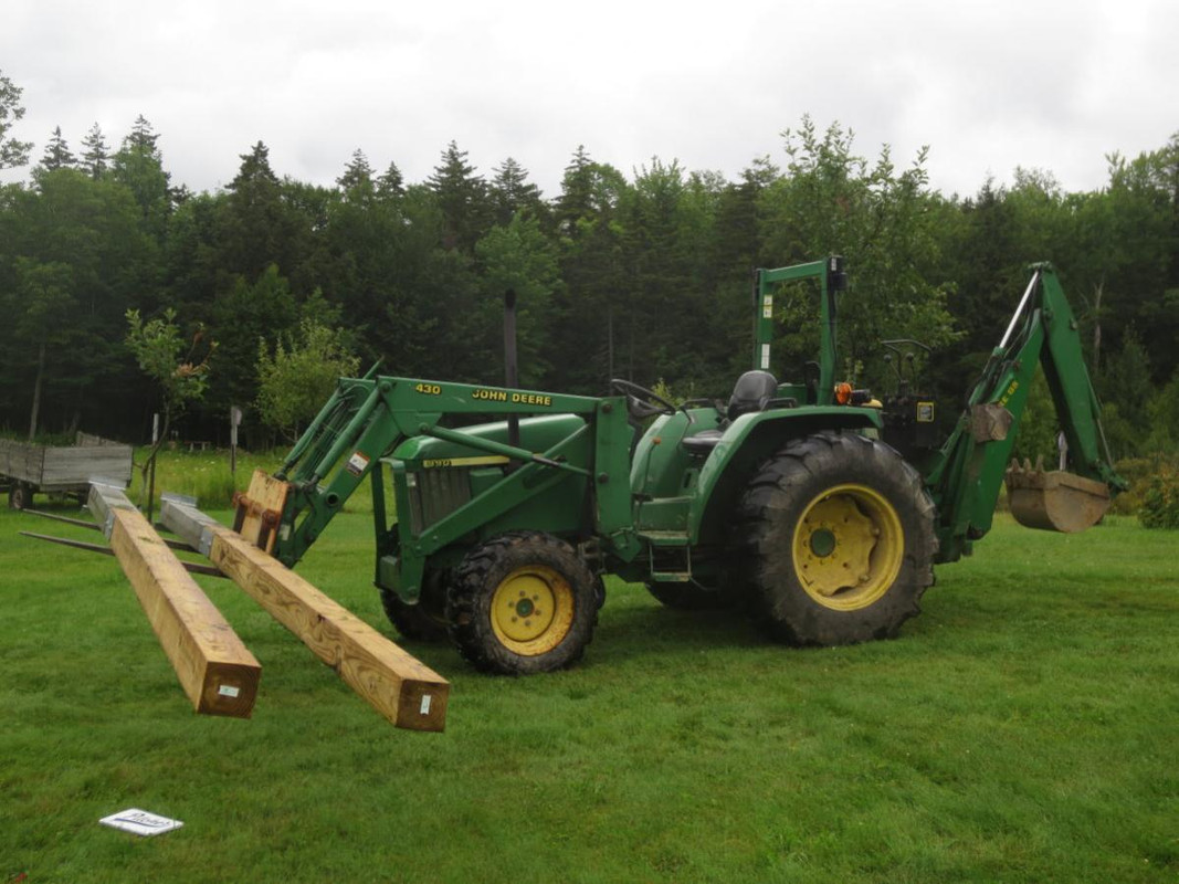

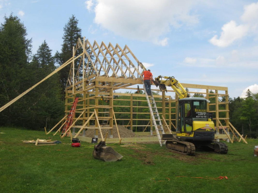

This set shows the trusses and metal roof going on. I used my JD 990 to pick up and carry one truss at a time to my buddy's mini-excavator. He made a jig that would clamp on to the trusses and then we used it to pick the trusses up to the top plates. It was a little sketchy, but it worked. About a day and half for the trusses and another day and half for the metal roof. The only thing I couldn't figure out was how to get the ridge cap on. 12/12 pitch on the roof and I had no clue how to get up there and work safely. Ended up renting a man-lift for a day.
Also had a 6" cement pad poured. It's reinforced with wire mesh. Wish I had put in drains. Didn't think of that for some reason.

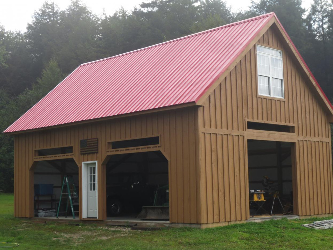

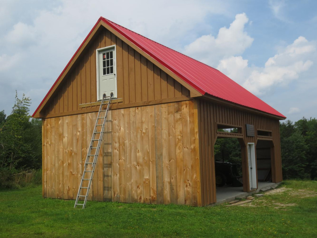

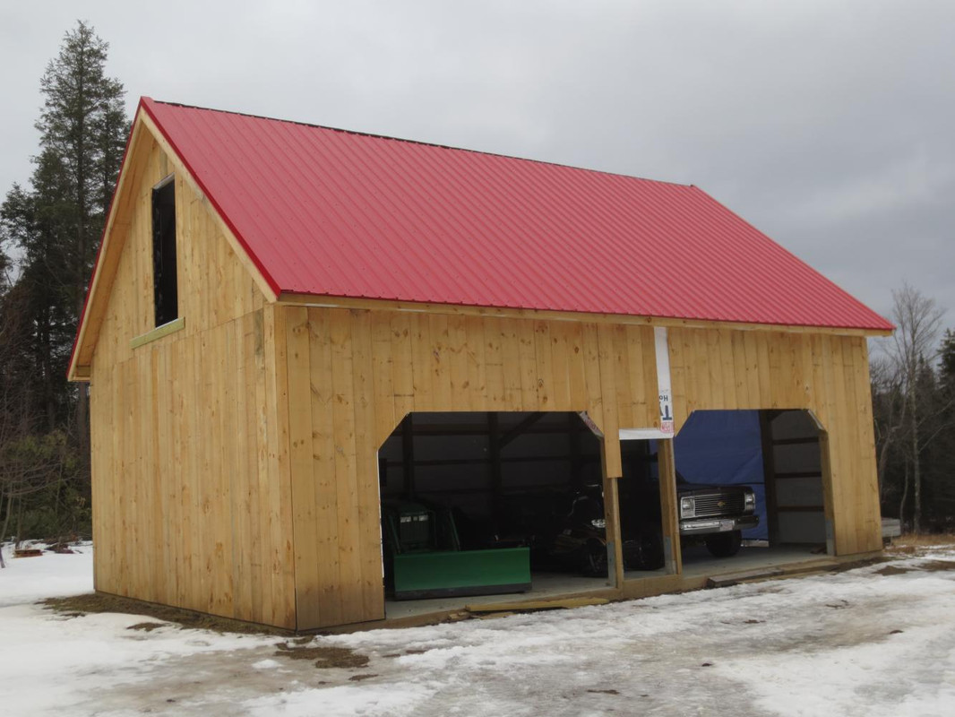

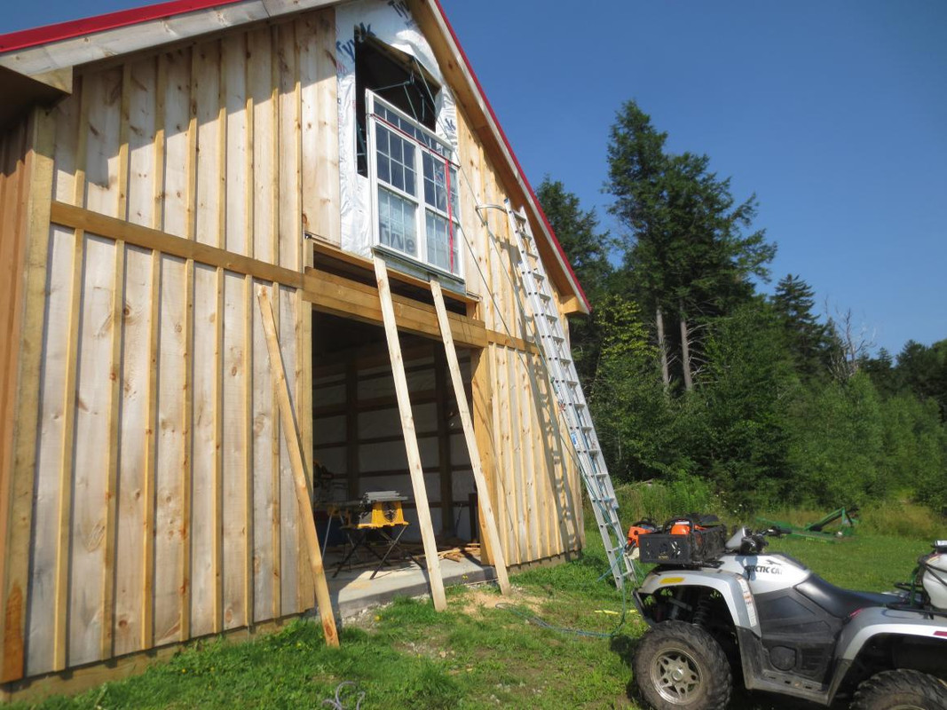

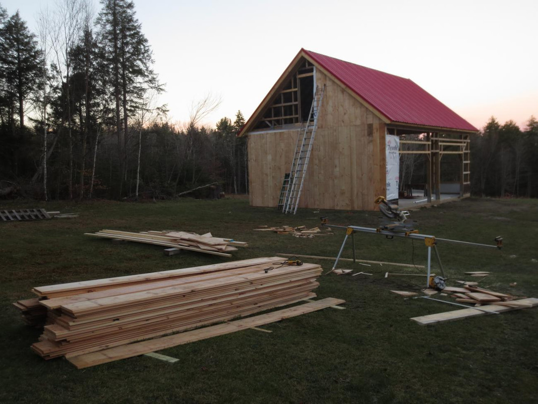

This set shows some of the pine board and batten going on. I wrapped the barn in Tyvek and nailed the 10" ship-lap boards to nailers placed 2' OC. Found a great window on Craiglist for one of the gable ends. Used a pulley and my ATV's winch to lift it into place. I've got attic trusses with a ton of storage upstairs. This window will let some nice light in.

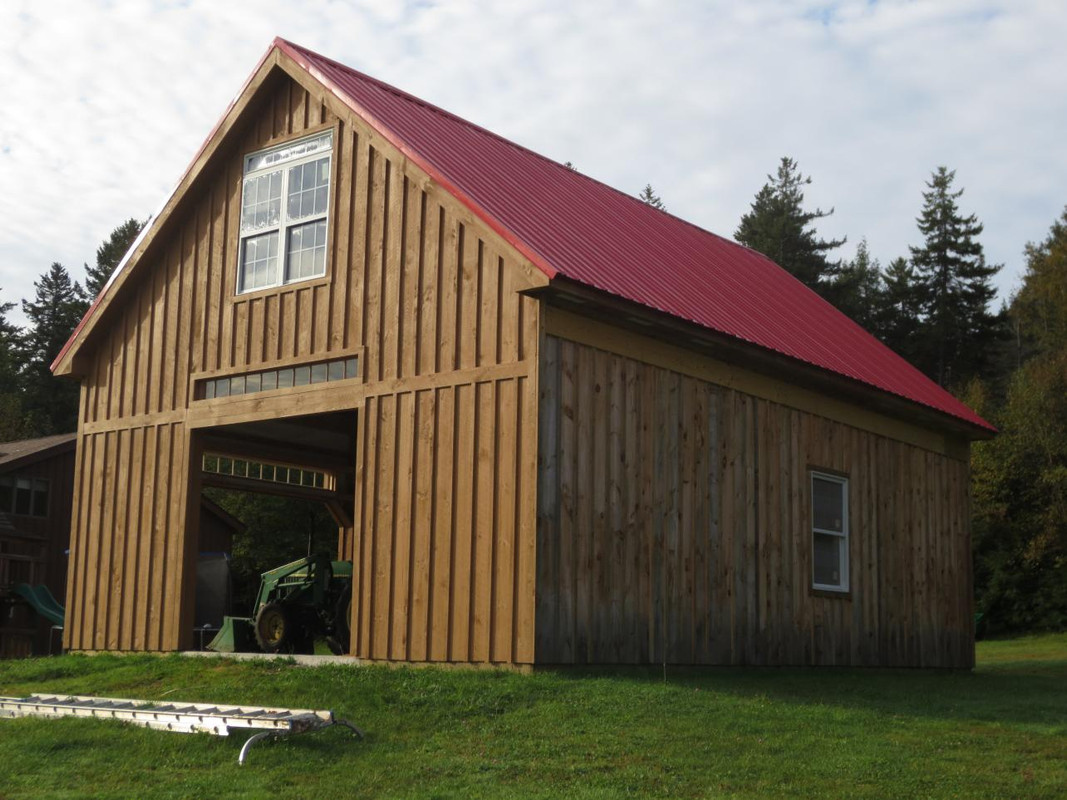

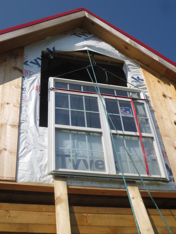

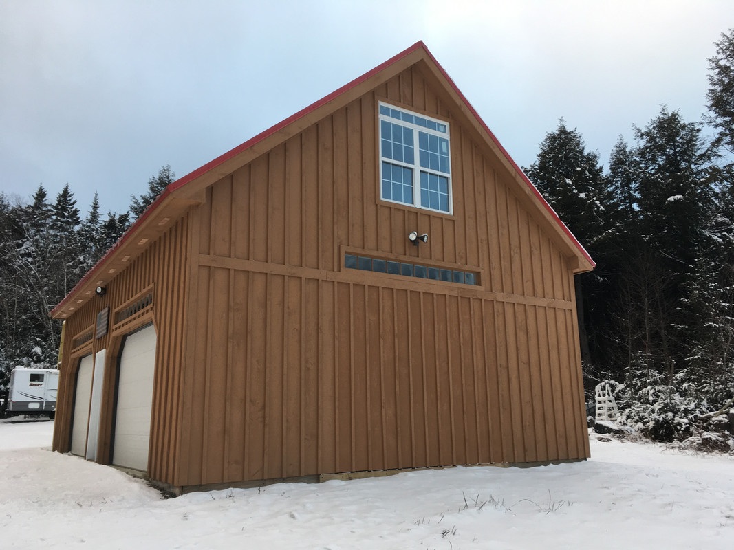

Some stain going on the pine. This was last summer...summer of 2018. Had some transom windows custom made in New Hampshire. Also a few pics of the interior bracing I used. I lagged pine 4x6's into each corner.

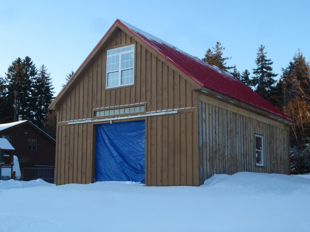

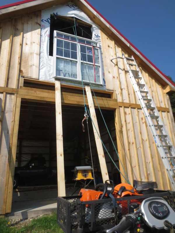

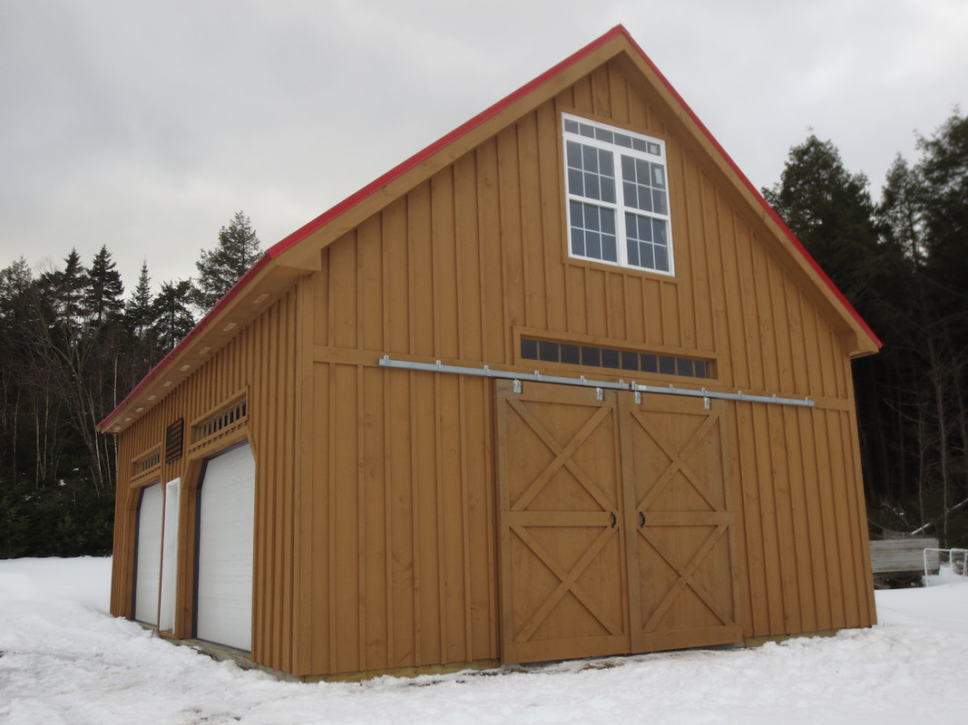

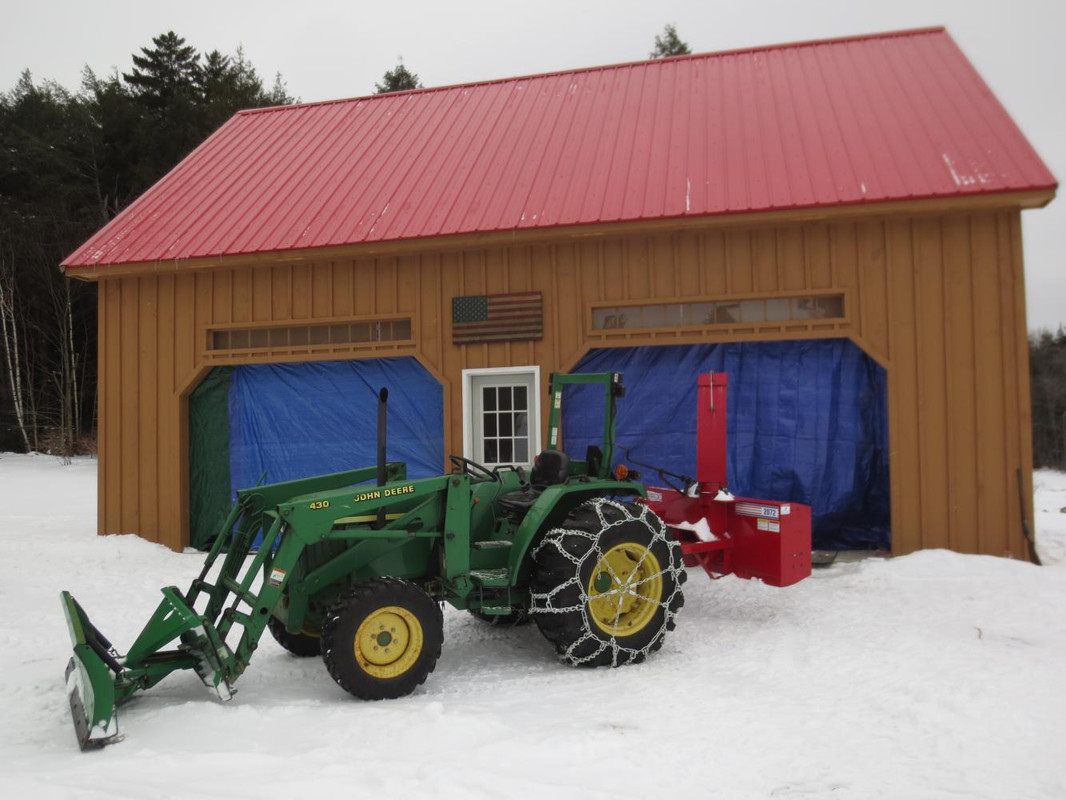

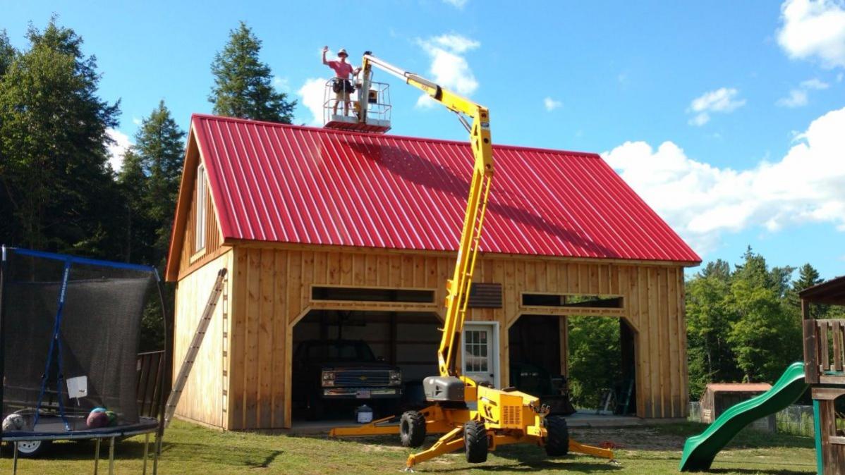

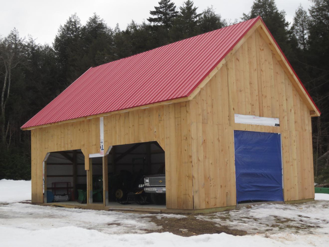

Spent my first winter with tarps covering the doors. Last summer I finally installed overhead doors....high-lifted them. On the gable end I built barn style doors. But I am now realizing these are terribly drafty. I plan to heat this barn in the future so I think I am going to have to do an overhead door here too. They look great. Just really inefficient at getting a good tight seal.

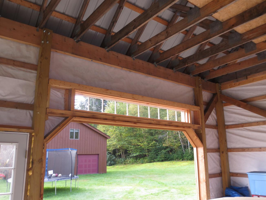

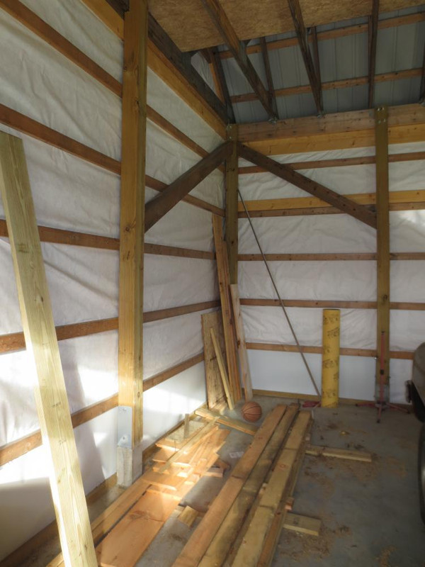

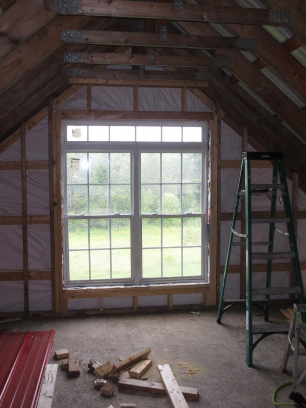

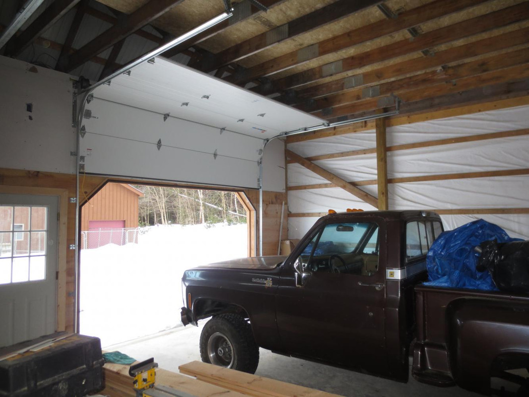

This past summer was mostly all interior work...insulation, electrical, and interior walls. I used 2" polyiso in between the posts and on the ceiling and foamed sealed all of the seams. Sometimes I wondered if I was going overboard, but I want to be able to work out there on cold New England days and not freeze my **** off. I then wired the entire barn and brought power out from my house to a 100 amp sub panel....wall outlets, hot outlets for drops, switched ceiling outlets for LED lights, 30 and 50 amp circuits for future welders and air compressors, a 30 amp outlet for a lift, etc. I was dreading driving the 8' ground rods, but much like my 16 holes for the posts, I didn't hit thing. Had them both in in about 10 minutes. Got lucky.
You can see some of the interior work in these pics. On the walls I used 10" ship-lap pine up to 8'. From 8' to the ceiling (which is 12') I used OSB. OSB is also going on the ceiling.

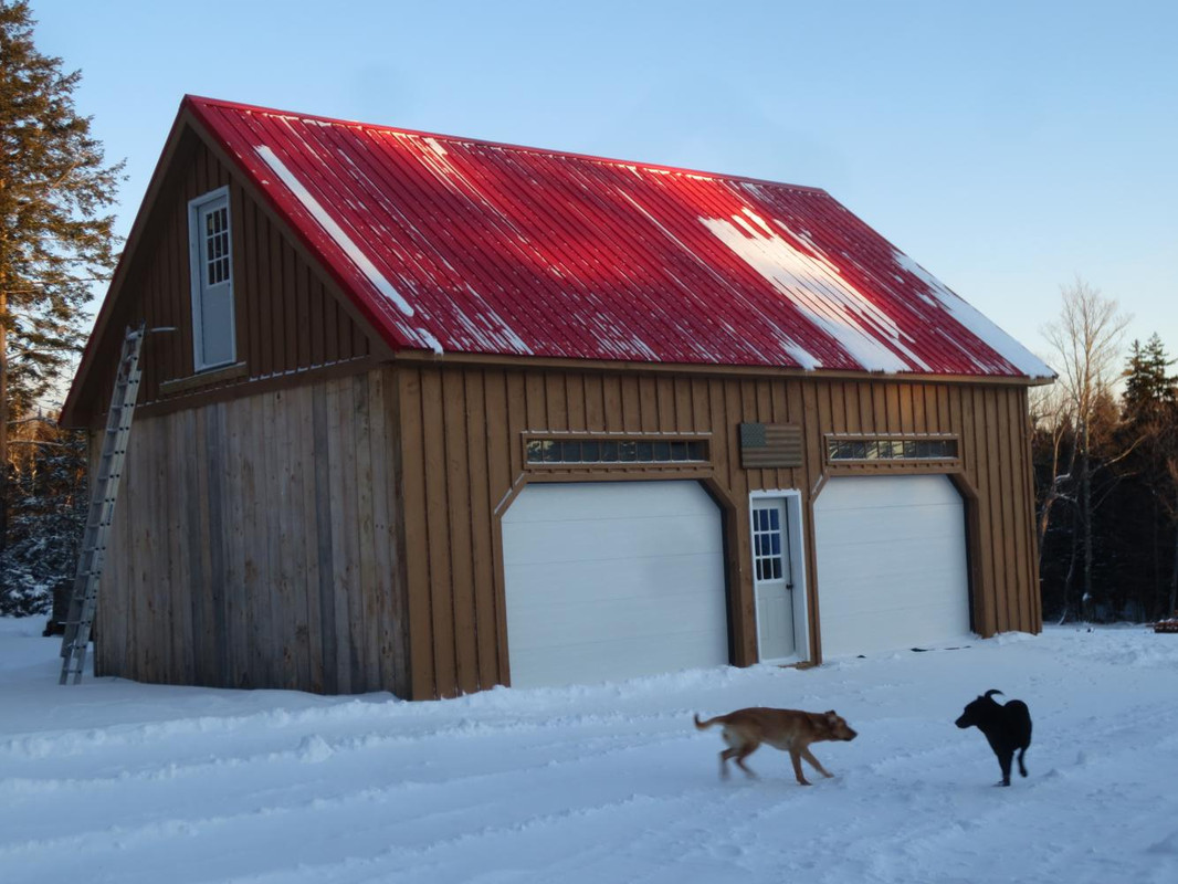

And here it sits today. Took this picture this afternoon. I have been using a small portable buddy heater to work in the barn and it gets nice and toasty. I am currently working on installing an 80,000 BTU Mr. Heater Big Maxx on the ceiling. Hope to have that up by Christmas.
Next summer, my fourth working on this, I'll build a set of stairs and a deck to that second floor entry door to the attic space. Think I'll also add a shed roof to the rear of the barn for my implements.

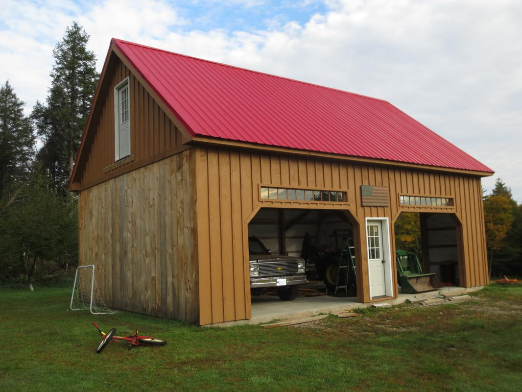

Hey guys....been home on lock down for the last 6 weeks now and used the time to get some serious work done on my barn. Thought I'd post an update to the build.
I borrowed some scaffolding with wheels and had a few friends help me put the ceiling on. I used OSB that I prepainted white. Got it up in about 3 days. Once that was in place I added some basic pine moulding, finished all the electrical, and began to move in. I added some reeled extension cords and work light drops, a ceiling fan, and LED ceiling lights. I made some shelves and work benches. Most importantly I found a small mini fridge for my cold beverages, and a used FM receiver and wall mount speakers to bring in my favorite radio station.
All this was supposed to be my summer project. I'm way ahead of the game. The only thing left is a set of stairs and a deck to the second floor. Should be able to knock that out by mid May.

After much consideration, I also removed the barn doors on the gable end and sealed up that wall. The barn doors looked great. But as far as functionality, they were drafty and hard to seal. I lost a ton of heat out of those doors last winter. Thought about installing an overhead door behind them, but when I put my lift in the far vehicle bay the whole point of the barn doors was moot. So, I took them down and sold them on FB, and sealed up that wall. I also gained a ton of work bench and storage space inside by doing so.
Before....
After....
