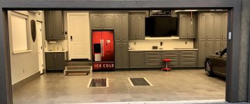

Houtan- That came out great. You are going to love that floor every time you walk out into your garage. Your tile guy looks like he did a great job. You tile is very similar to mine and so is the grout. Only difference is I went with 12x12 tiles and did a straight lay pattern.

Thank you!
Yours looks phenomenal. I was starting to love my garage.... until I just saw yours lol!!! I would love to have that lift one day. Any additional info? Brand, install cost, etc?

Houtan - Thank you; I love my garage. The lift is a mid-rise Bendpak and all of the hydraulics run through a 2" chase in the floor and the actual electronics/pump go in a bottom cabinet and are actually quite compact. The control panel for the lift is mounted to the side panel of the cabinet where the refrigerator is. All you see is the lift ramps in the floor and the 10"x10" control panel with 3 buttons on it. The lift is 220 Volts and works very well. Raises cars, including my brother's Honda Ridgeline, his Audi SQ5 and our Macan GTS with out any trouble. I think it raises them about 54" off the ground. I can't walk under them, but I can roll under them on a stool. Makes maintenance and cleaning very easy. That was my second BendPak lift. I had a 4-post in my last home and it was great. My needs changed so I changed to a mid-rise scissor. When it is down it is flush with the tile. I used a lighter tile border to accent the lift because I wanted to make it "pop". I then did the stair edges in the same tile accent so I don't trip on the stairs. Enjoy your floor. Cheers, Michael

Thanks Michael. I don’t know what else to say other than your entire garage is badass! I will probably resort to something like a quick jack for now then maybe invest in a lift like yours down the road. They also have an above ground version that would be nice.
Is that a wrap on your refrigerator?

Your reply regarding the wrap disappeared for some reason. I am even worse off than you. I needed to buy a fridge asap and the only color available was white!! So a wrap is on my future.
Big update. Single car garage is done!!! Well the floor is at least. Still have to paint. But the floor came out great!
Also, my cabinets came in which is awesome. Hoping to get them installed this week. They are big. The amount of shipping trash was even bigger!
