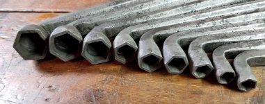

Here are some views of the set cleaned-up and some views of the largest and smallest just to get a better perspective of the construction.

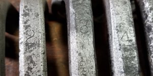

Here are some close-ups of the markings, all of which include the name “GRUBER” and a number on each wrench, from "00" to "9".

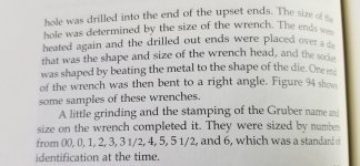

Attached are some excerpts of articles from various issues of The Carriage Journal in the 70's and 80's talking about the history of the Gruber Wagon Works and the socket wrenches.

They have some wrenches on display (see the photo of them hanging on a board in the blacksmith shop and read the text from a book called The Gruber Wagon Works – The Place Where Time Stood Still by Carol Hunsberger) - but they don't have any with the personal initials of William P. Gruber.
