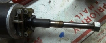

The early Blocks (pre-Blocks, ++ ?) do not use a start-up relay. Rather, they use a mechanical centrifugal-switch (CS).
Levers on the arbor shaft attached to weights press a low-friction, non-conductive sliding collar that presses against a plate with a set of electrical contacts, which is mounted to the RH end frame. At start, the collar is pressing on the CS plate, closing the contacts and connecting the start winding. Full description, here. --> https://en.wikipedia.org/wiki/Centrifugal_switch
Centrifugal-switch (CS), removed from RH end frame. The brown mounting plate is quite fragile and care needs to be taken when disassembling.
If the RH bearing is stuck to the arbor and the arbor is removed with the CS still attached to the RH end frame, the CS can be damaged/destroyed.
In this case the bearing stayed in the RH end frame, so removing the CS first was not necessary. I cut the white wire from the start-up winding to the CS. The other white wire from the CS goes to a splice with the power cord neutral (white) and the run winding (red) wires, under the grinder cover.

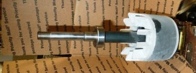

After removing the LH end frame, where the bearing stayed on the LH arbor shaft, I was able to maneuver the winding assembly enough to remove the 2 mounting screws holding the CS to the RH end frame, so the CS was free to be removed with arbor & winding assemblies. As mentioned, it turned out the bearing stayed in the RH end frame.
Here is the arbor assembly, RH view, showing the mechanical weights and lever of the CS.
RH end frame with bearing. Dark looking wet spots are Kroil penetrating oil.
LH bearing/arbor.
Detail of LH bearing mounting hole in the end frame.
Detail of RH bearing mounting hole in the end frame.
Note the ridge on the inside of the bore. This keeps the bearing in the RH end frame when the arbor assembly is removed. Greatly simplifying disassembly. This must have been a manufacturing revision, earlier pre-Blocks did not have this, IIRC.
I haven't detailed the LH bearing removal from the arbor shaft. It has been posted previously. I will look for the link and post it here. https://www.garagejournal.com/forum/showthread.php?p=5722705#post5722705

Once the arbor and winding assemblies are removed, the RH bearing is removed from the inside of the end frame using a Sunex Tools bearing/seal driver tool.
I first used the 1.25" (31.75mm) to remove, but to temporarily re-install I noticed the 1.375" (34.925mm) was a better match to the OD.

The bits 'n pieces have been cleaned and some de-rusted with Evapo-Rust. Waiting for reassembly.
A hole was drilled for a self-tapping ground screw - lower left.
New bearings are being heated on a coffee warmer, prior to installing on the cold arbor. The flanges are used to keep the bearings in close contact with the warmer. Temperature was about 110F.
Arbor shaft assembly fresh out of the freezer.
The 'hot' bearing dropped right onto the 'chilled' arbor, no force needed. More information about this LH bearing later.
Because of the inner-most ridge in RH bearing bore, that bearing was installed into the RH end bell from the outside.
The 2 'U' shaped power cord strain-reliefs and plastic bushing were removed from the power cord and the grinder.
The original hole was enlarged to a bit over 1/2".
The modern Heyco strain-relief is a better choice. The red handled pliers were used to install the Heyco (to the left of the pliers) and power cord.
The black bushing and ring above the pliers are alternatives that were not used, due to space limitations.
View of the power cord and strain-relief installed - outside of bell end.
