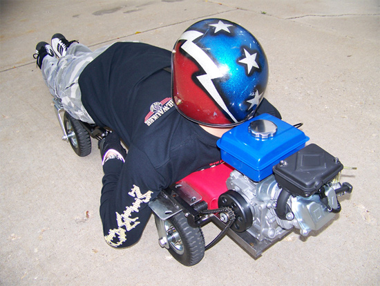

We built an electric barstool to race at World of Speed at Bonneville. We broke the exisiting record of 49.972mph with an average speed over 2 runs of 53.557mph. Similar drivetrain as the drafting stool mentioned earlier but in a CNC frame with custom everything. Rules, video and...

There is a video:
Dowie it looks like you put some thought into it...could probably improve it immensely by lowering it and using something different for a wheel and tire setup, though (wider, go-kart style wheels and tires)??

This design is actually very stable at high speeds. I designed a two bar steering linkage with spherical ball joints and adjustable toe in. Currently it's aligned with .188" toe in. The design also has a mini friction damper for the steering lever that I made from an old die spring and some fiber washers. So no speed wobbles. I modifed the 8.50" pneumatic tire casters by pressing in high speed radial bearings. I also machined new wheel bearing spacers for a perfect .010" preload on the radial bearings. This thing is designed and engineered for speed. The best thing about it is that it only cost me $200 to build.

Need options:
Brakes
Chain Guard
Head Rest
A chain guard adds weight which decreases speed.
A brake system adds weight which decreases speed.
A brake system is redundant because I have shoes that can stop this light rig.
A head rest adds weight which decreases speed.
A head rest is redundant because I have to lean and turn my head in the corners.
