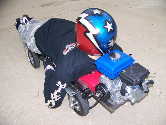

If you hit the wrong thing at speed, the fuel tank ain't your only problem! We built a motorized drafting stool as a shop project in HS. It had a car battery and a modified starter motor. It was amazingly fast and totally uncontrollable!

However, this dude needs some more protection. One unexpected divot in the road surface or a caster bearing seizes and his face is grinding directly on asphalt, and he's eating through a tube and talking to Oprah about how he recovered from a jaw transplant.
I was raised in and around fast cars, dirt bikes and later, military hardware, and I've pushed the envelope way too far at times. However, from early on I was taught to wear effective safety gear and that safety gear has saved me from serious injury (the not funny....oh **** type of injury) on a few occasions.
This dude, especially going face forward, just makes me cringe.
That having been said....dude...I want one (building parts list in his head).

We built an electric barstool to race at World of Speed at Bonneville. We broke the exisiting record of 49.972mph with an average speed over 2 runs of 53.557mph. Similar drivetrain as the drafting stool mentioned earlier but in a CNC frame with custom everything. Rules, video and...

Dowie it looks like you put some thought into it...could probably improve it immensely by lowering it and using something different for a wheel and tire setup, though (wider, go-kart style wheels and tires)??

This design is actually very stable at high speeds. I designed a two bar steering linkage with spherical ball joints and adjustable toe in. Currently it's aligned with .188" toe in. The design also has a mini friction damper for the steering lever that I made from an old die spring and some fiber washers. So no speed wobbles. I modifed the 8.50" pneumatic tire casters by pressing in high speed radial bearings. I also machined new wheel bearing spacers for a perfect .010" preload on the radial bearings. This thing is designed and engineered for speed. The best thing about it is that it only cost me $200 to build.

Need options:
Brakes
Chain Guard
Head Rest
A chain guard adds weight which decreases speed.
A brake system adds weight which decreases speed.
A brake system is redundant because I have shoes that can stop this light rig.
A head rest adds weight which decreases speed.
A head rest is redundant because I have to lean and turn my head in the corners.

Dowies, with all due respect for your need for speed: Use your obvious skills and fab up a brake system for that thing.
I don't care how good you are at stopping it with your feet.....Somebody is gonna back out of a driveway in front of you or something, and then we will all be sitting here saying,
"Hey, remember that guy with the motorized creeper?? I wonder what happened to him, he never posts here anymore..."
