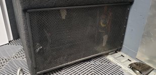

Putting the final touches on an insulated enclosure. Need to insulate the doors and find a place for the fan switch box. Anxious to see how much the noise level drops.

The air intake/filter is about 6 inches from the 14x18" vent. The 12" fan is more then sufficient to move air. It is totally enclosed with 1.5" Roxul high temp insulation. I don't foresee melting the enclosure and it will be as cool and quite as possible.
Sitting in all day shade couldn't hurt either.:thumbup:

Outside air temp 84, Inside shaded shed 82.5 before start.
Ran it 30 minutes.
Hottest spot inside the box on a bracket 10" from the exhaust exit on fan side 111.
A brace directly above the center of the generator 89.
External engine temp above drain plug 140, intake vent side.
It appears the fan and vent size and position are perfect.
The temps here will increase a lot but seems the unit will run in an acceptable range.
Decibel readings, next to open doors 85. Shut 74. Sitting on patio 20' away 66-68.
5 stars for Roxul insulation.

I would be very concerned about the interior temperature, even with the fan.
It appears by the numbers posted above and another good run today it will be just fine.
With fresh air forced around it, top bottom and sides with wrapped exhaust and an outside exit it's not much hotter then sitting outside in stagnant air.:)
