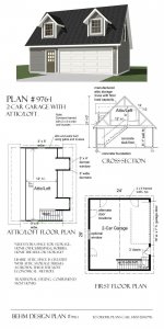

I am figuring the materials are around $10K with the plumbing fixtures and the 6 inches of concrete. I do have a contractor that is doing most of the stuff. I am do some stuff by myself but not alot. Also, most of the plumbing and the trench to the house with the elctrical is being done by my cousin who is a plumber.
I never considered a dormer on the back side. The space is really not needed. We have a 2 care attached garage for our two vehicles. This will be mnostly used for mowers and a work shop/man cave. The second floor will probably start out being a kids play area but will someday be finished for a poker room or something. I will post some pictures of the second floor. I amazed at the size of it. I didn't expect there to be so mouch room. Here is where we got the idea.
I am not sure if there is a Menards in your area, but they have a kit that is similar to this and that is where we got most of our supplies.

Nice work lpigg. I started with a behm design such as you and then modified
it to my needs.
What did you run for ceiling joists? Are those 2x12x24' ?
