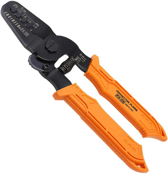

5,779
Boulder/Koloa
I have a pair of these too but haven't used them much. Purpose-specific crimpers are better and often easier but you really can't beat the flexibility of how many types of connectors these can crimp and the price is good and they don't take up a ton of space in my box.
I can't believe how good these things work. It's changed my opinion on 2.54mm connectors completely...

did you have to get used to crimping with them? Any techniques to share? :) (I probably just need to use mine more)
I don't think so? I just squeeze the handles and the dies do the work... I did watch the first few to figure out how much pressure was adequate.

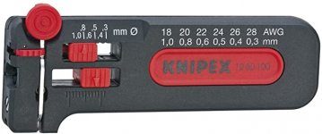

JBH
Jan 17, 2018
812
Plus, thin wire is difficult to strip. What tools do you like there?
This little yellow plastic thing from Jokari is inexpensive and works well on small wires. It's easy to judge depth, too. (I've used it down to 28AWG):
View media item 93704
I'm sure it's available from a US source, but I imported mine from amazon.de.
Elora also sells a neat little Euro-style stripper. It is a nicer tool but you have to judge depth by eye. I believe it is made by Schmitz but I have not seen that wire stripper directly from them or from any other known rebrander.
View media item 94296View media item 94297
A Pressmaster Embla with the PTFE (blue) blade works in a pinch as well. I suspect Stripax is similar, though I've never used one.
Stuey
Jan 8, 2008
11,034
28m above sea level
The Knipex 1280100SB looks identical and is easier to find, but I'm not sure how the price compares. I ordered my Knipex from Amazon UK or DE.

BTW, on topic: I have the Engineer PA-09 crimpers as well. I agree they are fantastic. I struggled crimping small wires for a long time with these bulky cheapo ratcheting crimpers, and on a whim/recommendation, I bought a pair of these, and it's made doing electronics work so much easier. It's hard to explain, and almost one of those things you have to feel. I initially balked at the price, and there's a cheaper set of crimping pliers that are similar, made by IWISS. Supposedly people get decent results with those as well. But I've learned over the years, if you plan on using anything a lot, buy the higher quality tool.
And I haven't completely sworn off ratcheting crimpers. I recently bought a $25 IWISS 3220M ratcheting crimpers. And they do some fantastic crimps in one stroke (as opposed to two on the PA-09). These aren't really necessary to own if you already have the PA-09, but eh... we're on the tool forum for a reason. :lol:
Both Jokari and Knipex rebrand are available through Amazon, Zoro, etc. so it's hard to say one is easier or harder to find. Knipex is a much better-known name, so in that sense one is more likely to search for them.
Knipex rebadges a few Jokari wire stripping tools. The Knipex brand and colorway adds a predictable price premium to this stripper. From amazon.com:
Jokari, $38.85 - https://www.amazon.com/dp/B00BMER574/?tag=atomicindus08-20
Knipex, $57.50 - https://www.amazon.com/dp/B005EXNXJI/?tag=atomicindus08-20.
Is the Jokari twice as good as the Klein stripping pliers above, as the price premium would imply? At least, I think. The Kleins have no depth stop, for starters.
