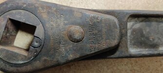

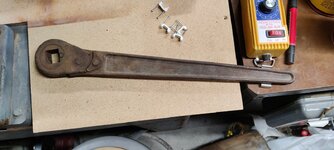

Anyone run across the "Large Series" sockets? Just got a 357 (heh) ratchet, that uses the larger drive opening. Will post pics in a bit.
I've never seen or heard of a No. 357 ratchet, Cruzer. Are you sure it's not a No. 355? The No. 355 was a female only ratchet with an 11/16-inch opening that drove the standard pressed steel sockets from the outside. I have a set that Mossberg made for Syracuse that operated like that.

Me neither! Or the ratchet, extension and universal joint. It's interesting that the O.D. of the drive tangs are the same O.D. of the regular sockets. The drive tangs are 1/2" inside - for all the 1/2-inch drive male handles (extension, universal, etc) and 11/16" outside, for the 11/16-inch drive opening in the No. 350 and 355 ratchets.
My guess is that the 348 extension and 337 universal are specific to this larger drive size. I can see the extension has a smaller step-down, so it can be used with the 1/2 stuff if needed. Just measured, opening is 1.025" on the ratchet. The universal is a different number than the one supplied for the 350 ratchet (#336 vs 337).
