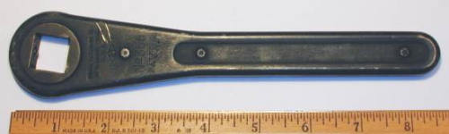

Hi All: I didn’t find another set but I did find a #360 Ratchet to add to my collection.

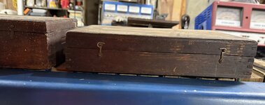

I managed to find another Frank Mossberg #14 pressed steel socket set. This one is slightly different than my other sets where the wrenches are on a tray that fits inside the box. These wrenches fit on the inside of the lid of the box. I did a quick search on the internet and The site Alloy Artifacts has a section on Frank Mossberg. I attached a page from Alloy Artifacts at the end of the pictures. It says that the first #14 set started with have the wrenches on the lid of the box.
The set is not 100% complete yet. I need to find a couple of pieces to complete it.
Also the height and width of this box is not the same as the other #14 box sets that I own. This box is slightly wider as well as about 1/2” lower that the other #14 boxes I have.

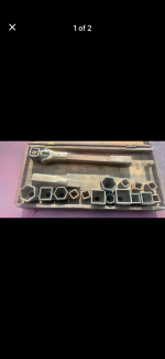

Here are 2 more of the #14 sets that I own. They both have the wooden tray. The first set still has the 3 slot bits as does the set that I just acquired. The last set also has the wooden tray but doesn’t have the space allocated for the 3 slot bits. Also this last set, the stampings on the sockets are much bigger than the two earlier sets. There are more pieces in the trays that actually do not belong there. Because I don’t have much space I put those extra pieces in these sets. I greatly appreciate all of the input and help I’ve received on supplying me with information about the Frank Mossberg Pressed Steel socket sets from the garage journal members. Hope you enjoy the pictures.

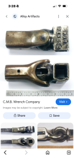

Trying to piece together a No10set. Maybe missing the 1-5/32 sparkplug socket, though I don’t see how it would fit in the metal box. Every piece but the universal is marked <M>.
And that brings me to my question: how does the universal fit anything but the sockets?
IMG_0334.jpegIt does not fit into the extension, and the square hole in the ratchet is too large. The only solution I see is to use a nonexistant 1/2square socket.
Am I missing something?
30,871
...the square hole in the ratchet is too large. The only solution I see is to use a nonexistant 1/2square socket.
11/16" to be exact, for turning the sockets from the outside like male drive tangs. You were onto the solution. You use another socket as a shim. Insert the drive tang and it sits inside the female drive opening flush. Insert the universal joint drive tang inside that.
Incidentally, that's not a Mossberg universal joint, or not one that I am aware of anyway. However, the actual Mossberg uni joint has the same design. Same solution. Shim socket.
EDIT: I would take photos, but I'm not home, and, I think you'll see what I mean without photos.

Here’s a description and picture off of alloy artifacts. Org. Hope it helps

Thanks to you both. I had read AA, and did not see anything addressing the issue. I had a 15/32sq socket that sort of worked. I’ll see if I have a 11/16sq. The guy who invented the male-female universal was a hero.
I have two shiny universals like that and a heavier plain steel one. None are marked.
30,871
I thought I posted photos years ago but apparently not. Just this...
As you surmised, and as far as I know, Mossberg, Walden, Miller, Syracuse, and Hinsdale all made double-male universal joints in the early era. Most of them, including the Mossberg, required the use of a spare pressed steel socket as an adaptor. The socket would be plugged in from the top, and the other male drive end of the uni joint (the end not plugged into a socket) would be plugged into the inner drive opening of the socket inside the ratchet, acting as a shim.
:headscrat
You don't need a socket with a square service opening. Any socket, including hex, will do. You're using the 1/2-inch square female drive opening.

I intend to make a top for that wood box, but want to be positive what it should look like (the No14 set makes me think of the cotter pin tool and a few pressed-steel DOEs hung inside - maybe that’s for another box.)IMG_0305.jpeg
30,871
I pulled out my early Auto-Cle (QMS) set, a later Mossberg No. 14 set, and a Triumph-branded set (interesting thread in its own right) that I suspect Mossberg of supplying all pieces for, including sockets, ratchet, and extension.
Pic 1: Brighter steel finish pieces from early QMS Auto-Cle set on left, blackened finish pieces from Mossberg No. 14 on right. Note how "identical" the knuckle joints look! The male drive studs on the later Mossberg universal joint will fit inside the female drive opening of the earlier Auto-Cle sockets, but the female opening in the later Mossberg extension will not accept the male drive studs of the earlier Auto-Cle era universal joint or extension.
Pic 2: The male drive stud of the later Mossberg extension will fit in the female drive openings of the early Auto-Cle sockets
And yet the sockets, universal joint and extension of the Mossberg No. 14 set all fit each other.
Pics 3 & 4: The male end of the Triumph extension will not fit inside the female end of the Mossberg extension, but the male end of the Mossberg extension will fit the Triumph sockets.
Crimping that 11/16-inch square outer drive into the end while preserving the 1/2-inch interior drive seems to be the culprit.

Funny, I was going to bump this thread when I brought this No. 355 ratchet home on Friday. It's the first one I've seen with an 11/16" opening. It came with a 27/32" socket and a No. 101 combination 27/32" 21/32" socket. I also bought a 7/8" socket I'd previously seen/left at a Habitat store. The finish on the ratchet/socket is remarkably fresh for such an old tool.
It's pretty cool, the way the sockets also work with a half-drive ratchet. I have one of those as well as a couple of speeders, but that's about it for my assortment of Mossberg tooling; aside from a few wrenches.
EDIT-
Here is what AA has to sAy about the 355 (although there are other examples discussed on that page).
No. 355 11/16-Drive (Non-Reversible) Ratchet​
Fig. 68. Mossberg No. 355 Ratchet, ca. 1915-1916.
Fig. 68 shows the Mossberg No. 355 non-reversible ratchet from the No. 30 set, stamped "Frank Mossberg Co." and "Attleboro, Mass. U.S.A." with the M-Diamond logo, and with a "Pat. Pend." notice.
The overall length is 8.6 inches, and the finish is black paint.
The No. 355 ratchet is similar to the well-known Mossberg No. 350 Ratchet, but is slightly shorter and does not have a reversing mechanism.
The patent corresponding to the pending status is probably patent #1,165,995, filed in 1915 and issued late in that year. This patent describes the construction of a simple and inexpensive ratchet and is best known for its use with the Mossberg 645 Ford Reverse and Brake Ratchet.
The identification of the patent for the No. 355 model is somewhat uncertain, as no examples of this ratchet are known to have a patent date marking. However, since the No. 355 ratchet was intended as a lower-cost model, and the ratchet is known to have been offered as early as 1916, the #1,165,995 patent seems to be the likely choice.
A later example of the No. 355 ratchet can be seen as the Mossberg No. 355 Ratchet from a No. 13 socket set.
Excerpt taken from here--

I really really want to buy this set. I this a Mossberg flex handle?
This is the picture from an ad. The gentleman won’t answer my inquiries.
A
Ayrhead
Feb 23, 2020
589
Ontario
After a quick search on the internet, Alloy Artifacts.org identified this as a flex extension made by C.M.B wrench company… it’s pretty sweet!!
I’m wondering if the sockets are Mossberg or perhaps a different manufacturer… it’s definitely a nice piece. Just not sure on its value.
A
Ayrhead
Feb 23, 2020
589
Ontario
A little further dig and I think that is a socket set from cmb
