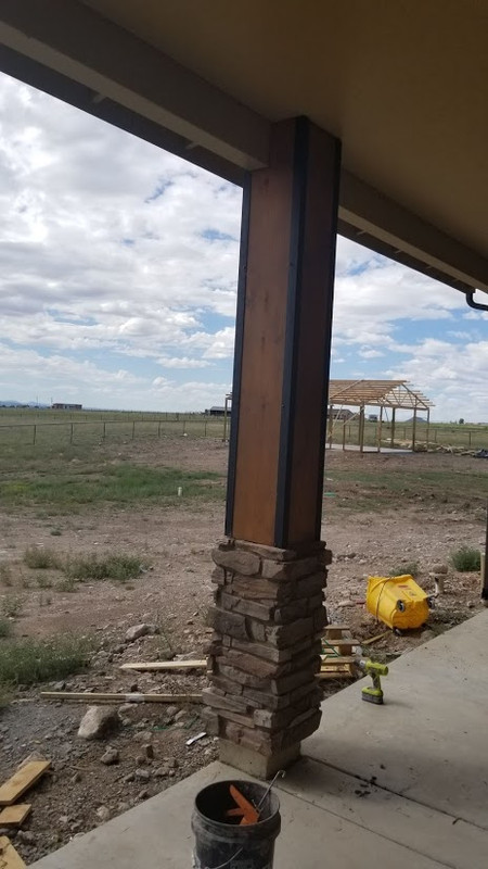

108" x 44" opening for the door. My wife is 5'7"
Lots of stone

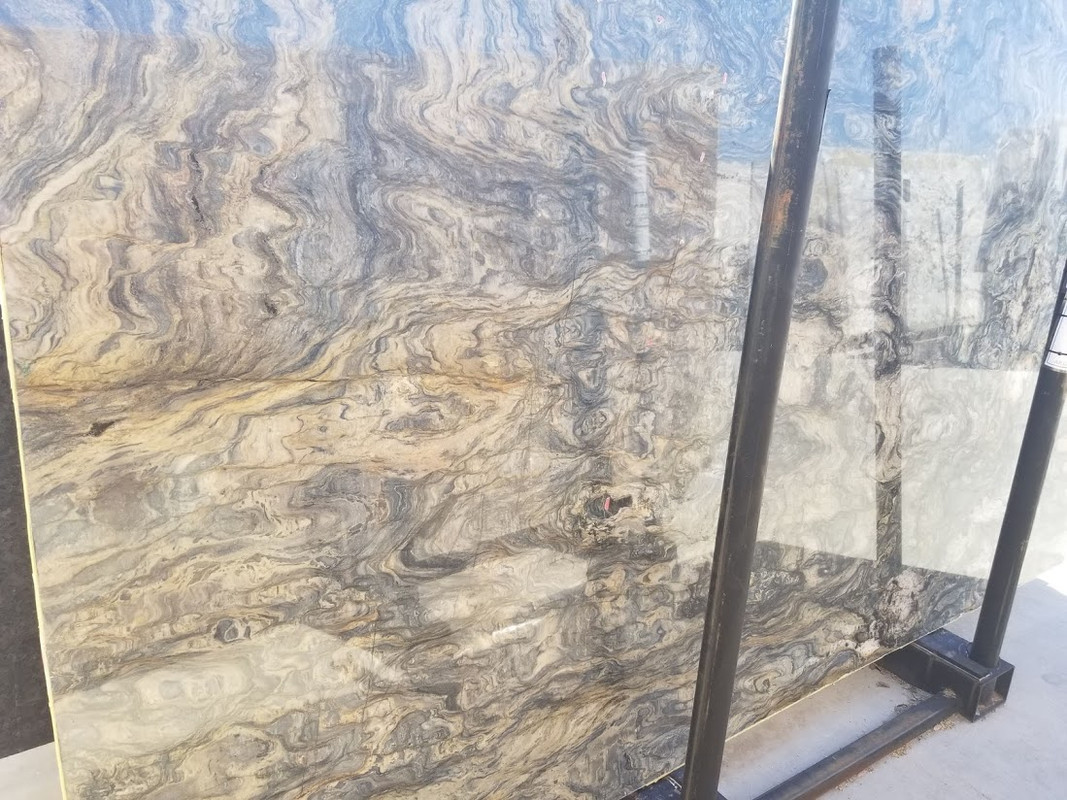

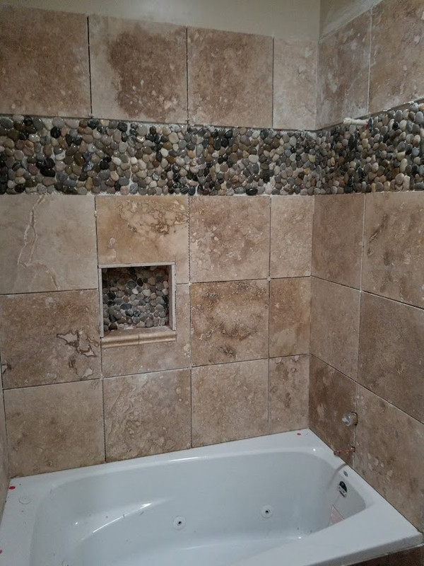

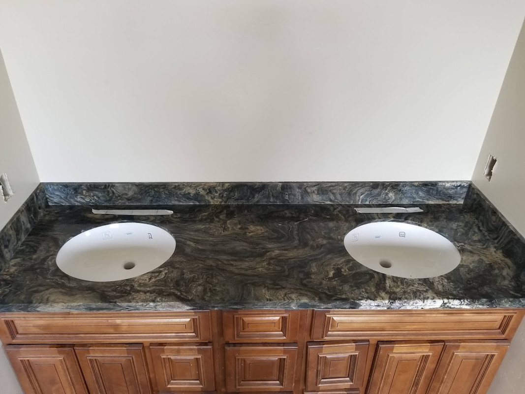

We found this cracked slab of Fusion Quartzite that is normally ridiculously expensive but I knew I had enough to get the laundry room and bathrooms done with it and with the discounted price, we couldn't beat it.
Shower and tub tile
This was the spare
Master Bath
Master Shower.
These tiles were 32" but i fell in love with them. I was a tile guy for one summer in high school but getting these down was a giant PITA. I wanted a big shower and I think this ended up being 92x42. The shower head on the other side looks identical. The floor tiles are the same slate/copper tiles that are inset here.

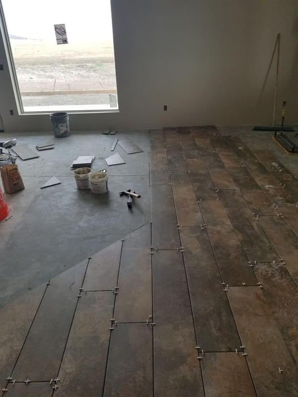

Found some slate look plank tiles that were discounted to a $1sqf, we both liked it and they had just enough for our job size.

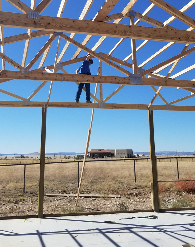

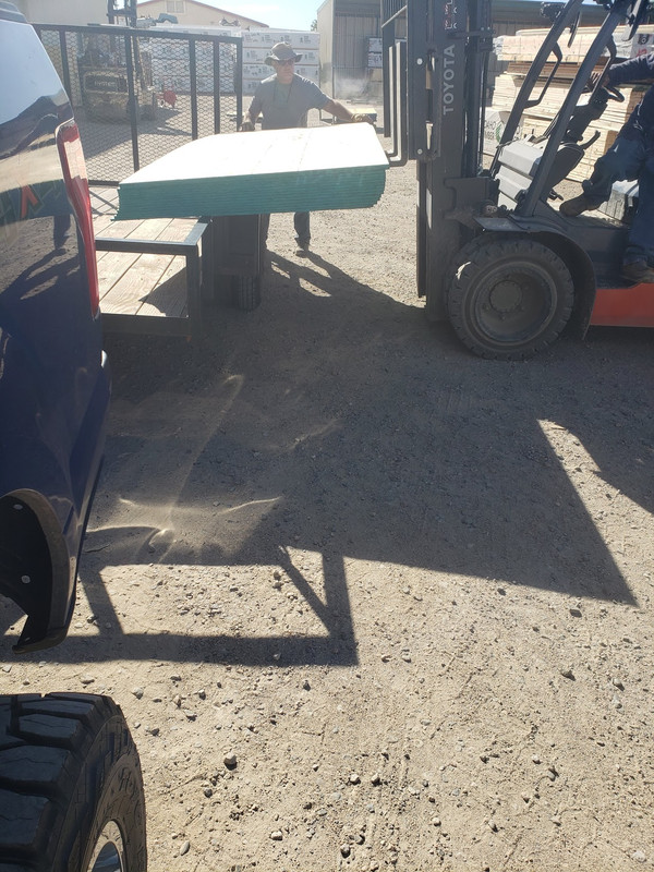

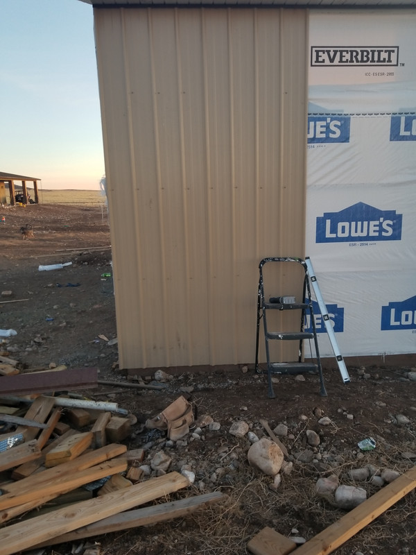

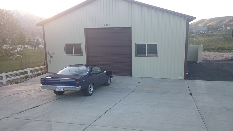

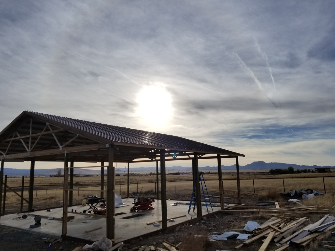

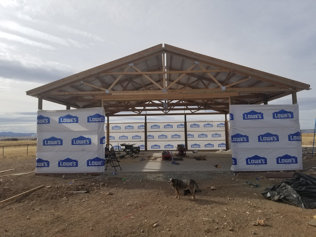

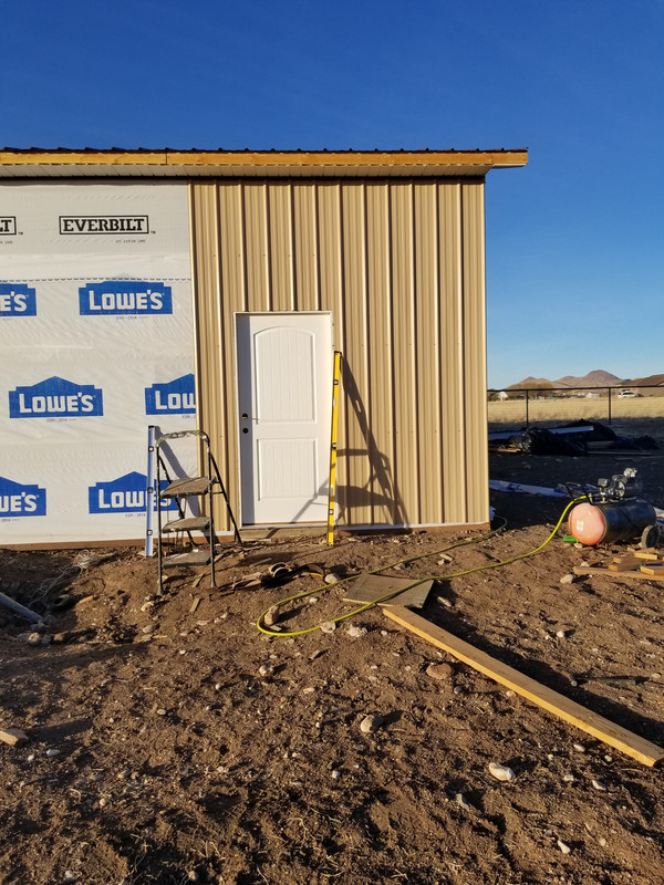

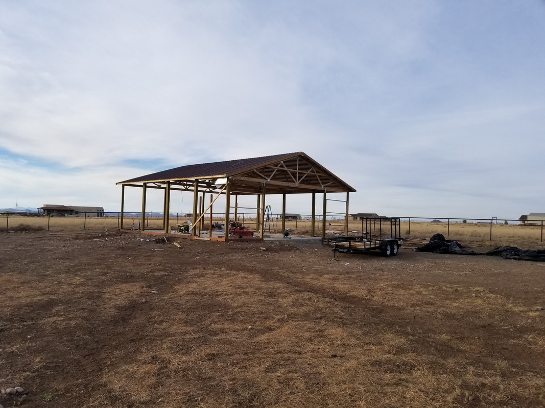

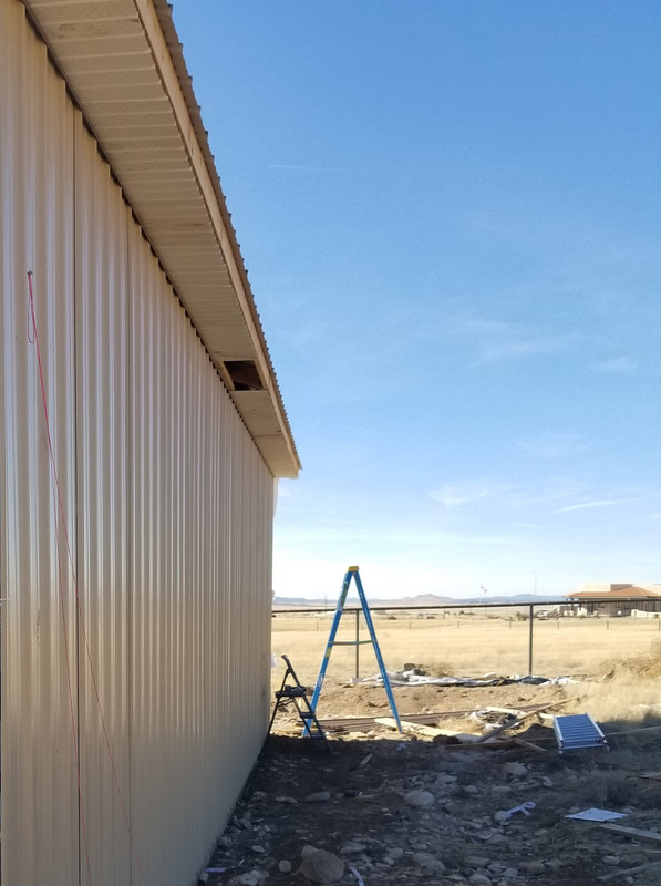

So I started the shop as I was building the house. After getting it framed up, I realized that I just couldn't do both at the same time and attempted to contract it out. I fired hired and fired two "crews" and decided it would have to wait for me to get to it so it sat like this for 6-8 months. We moved in on 9/1/17 and I didn't touch the shop for 2 months (needed a break)
My previous shop was 36x48 and for this build I decided on 36x40 but now wish i would have kept the same 48' length.
I didn't have any of the x bracing up and the weather was not kind so when I finally got back to it I had a lot of issues. The poles had all moved at bowed as well as half the roof purlins. I think if I had gotten the roof on before stopping it would have tied everything together. I ended up using 3 come alongs and let them sit with everything square for a week or two and then got the roof on.
I was a one man crew so lifting those over 20' metal panels was quite a feet and PITA

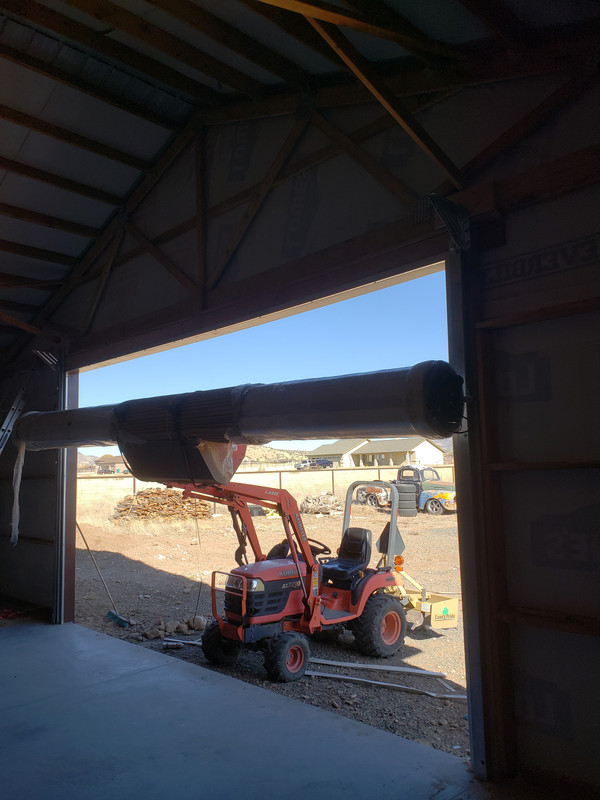

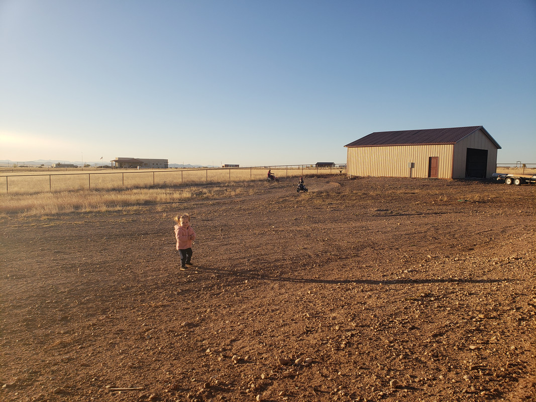

So beginning of 1/1/18 I started trying to get the thing dried in. I installed all the bookshelf style girts and installed house wrap.
Then I had this failed attempt at getting the garage door installed. I somehow thought I could lift one end up at time but i grossly underestimated the weight of the door. I ended up using one of the genie material lifts.
I didn't take any pics of it finished but here's one with it in the background with the wife and kid riding dirtbikes and my little girl watching.

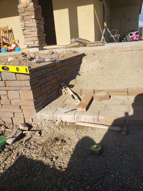

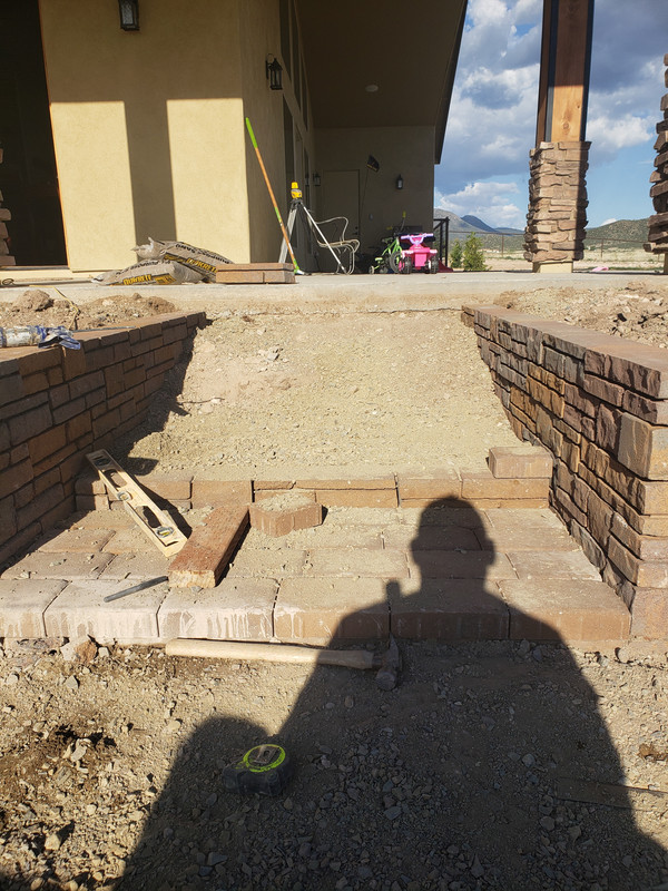

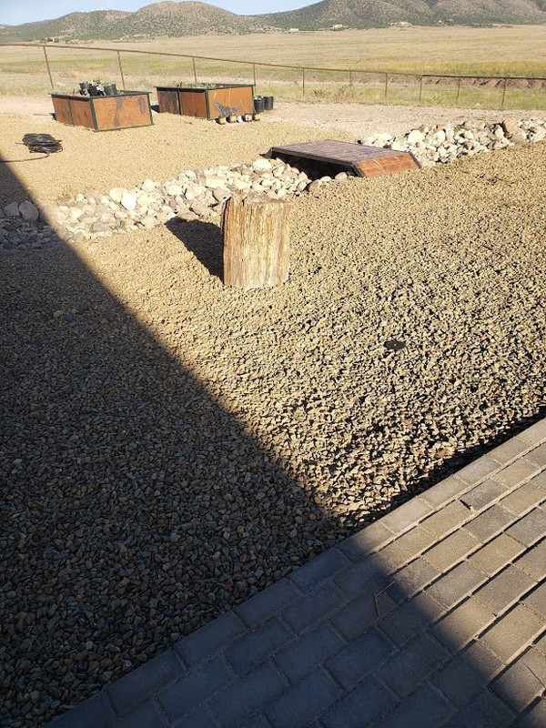

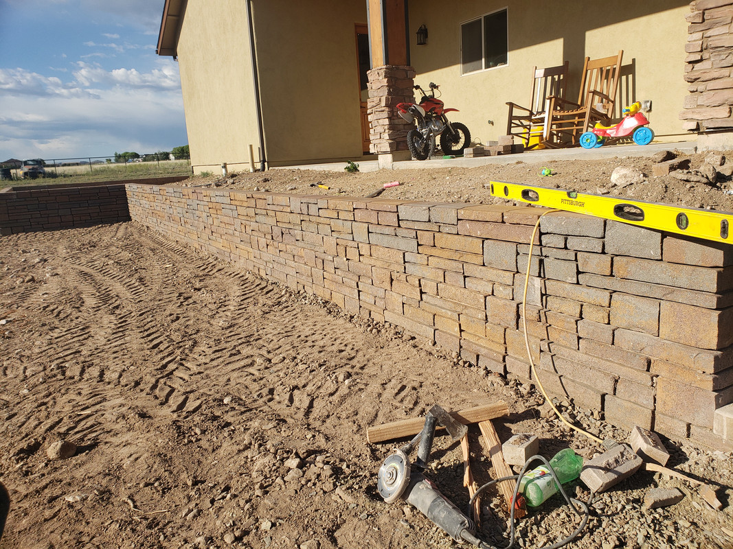

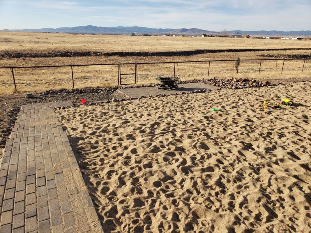

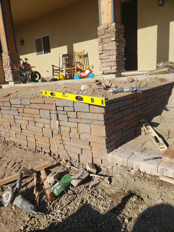

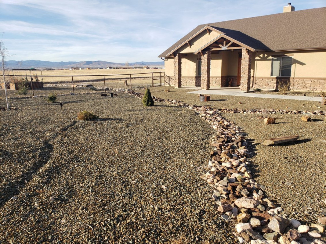

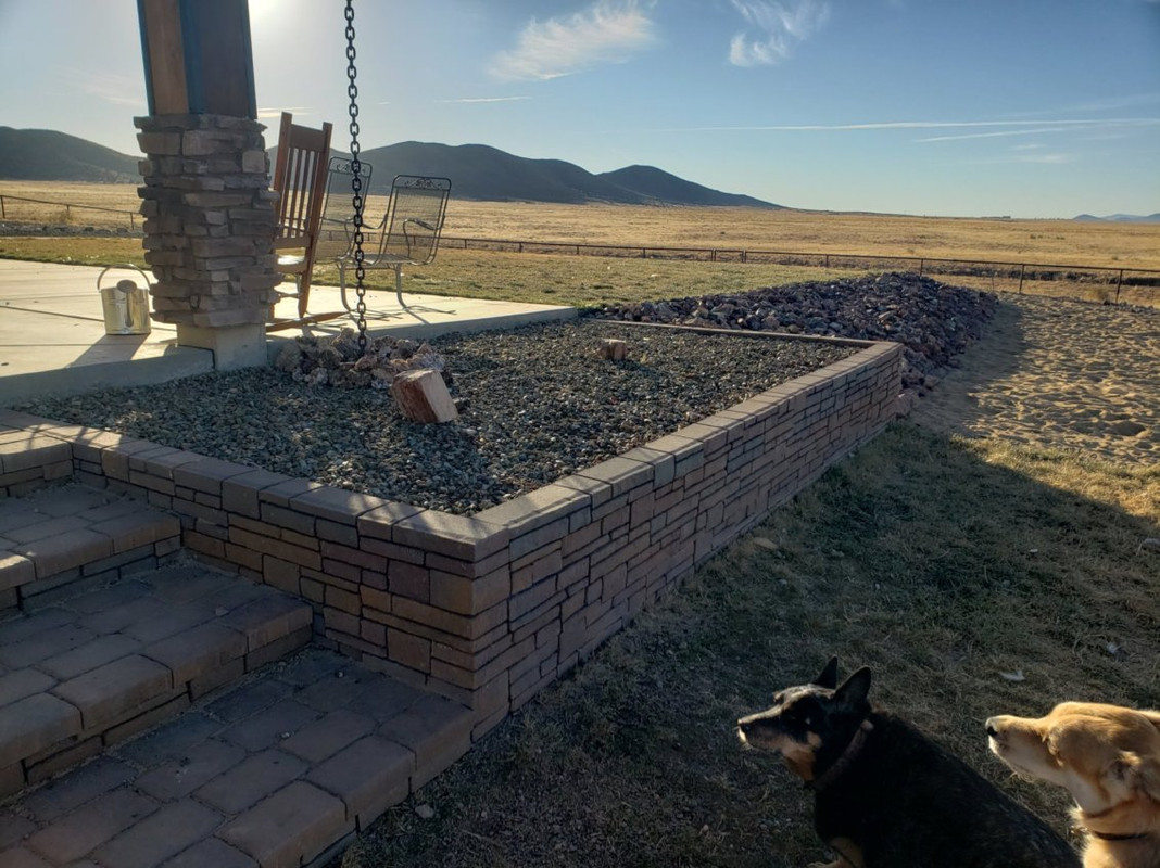

I'll keep this brief as this is a garage forum and i don't think anyone cares to see landscaping.
First big yard project was the front yard. We didn't go crazy with it but one of the cool features was the drainage "creek" we did. Every time we went out in the RZR, my wife would grab rocks that she liked and over a few months we had the front yard done. This is one of her hobbies and we have tons of petrified wood that she has found along with other rare "rocks" she has found.

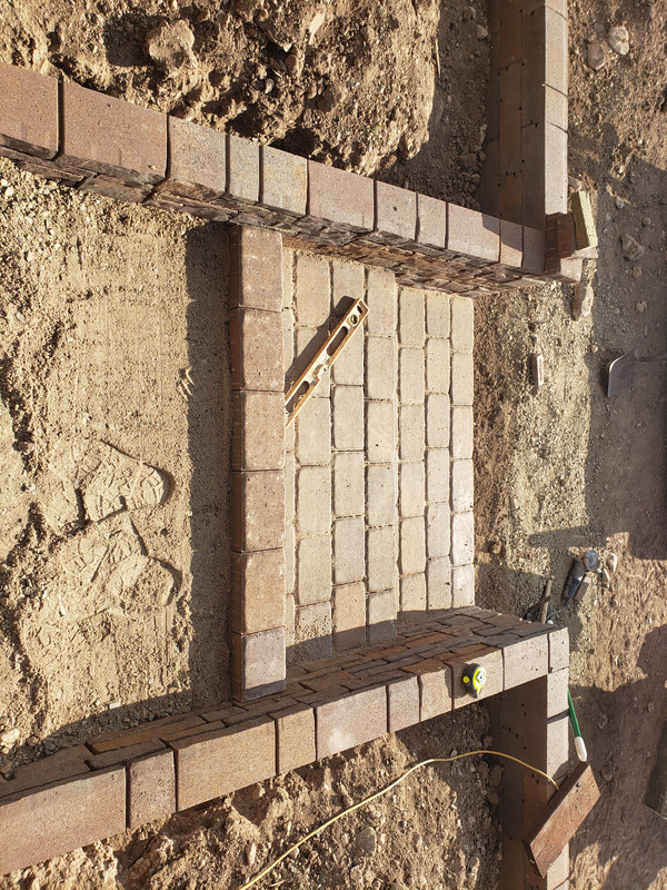

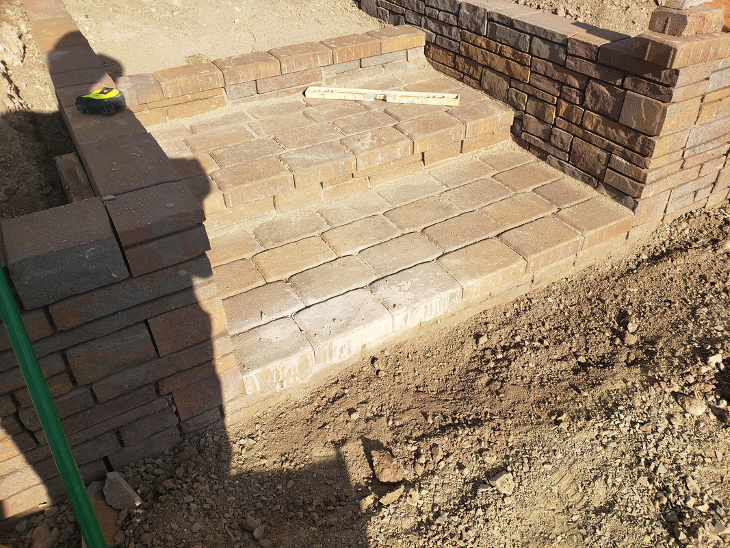

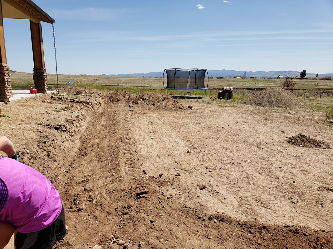

Then we moved on to the backyard to build a retaining wall and steps.

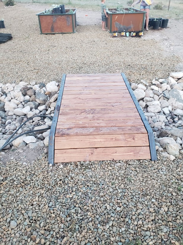

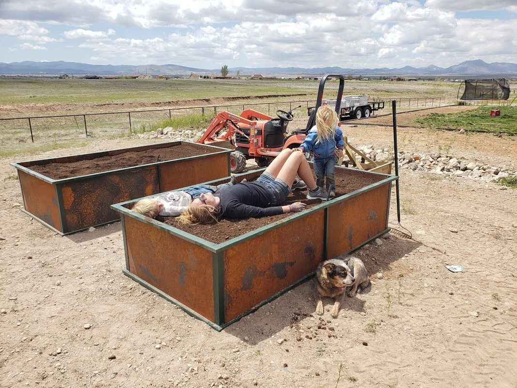

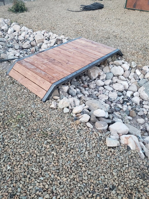

And then the wife wanted a few raised garden beds to go along with her regular garden as well as a bridge to go over the "creek"
The beds are thin wall 1x1, 1x2, and rusted 18 gauge panels and the bridge is 2 1/4 120 wall

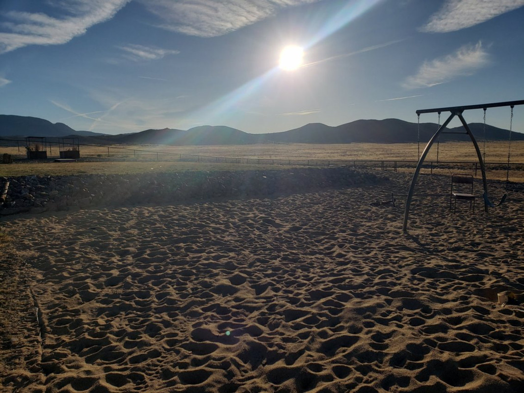

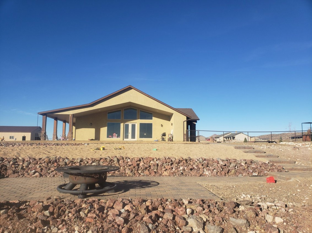

I ended up building up my side yard with a bunch of rocks that we dug up when digging the footers. My yard is very strange, the two acres that i have actually messed with is either never ending clay/loam or is caliche with boulders. I won't bore everyone with this process but it was a long project. In total for the yard i ran over 800' of drip line and PVC for sprinklers and planted over 20 trees.
Here you can see the rocks and then the fill dirt that i'm putting on top.
Here is the finished project including scattered sand toys
Here you can see how much i built up the yard

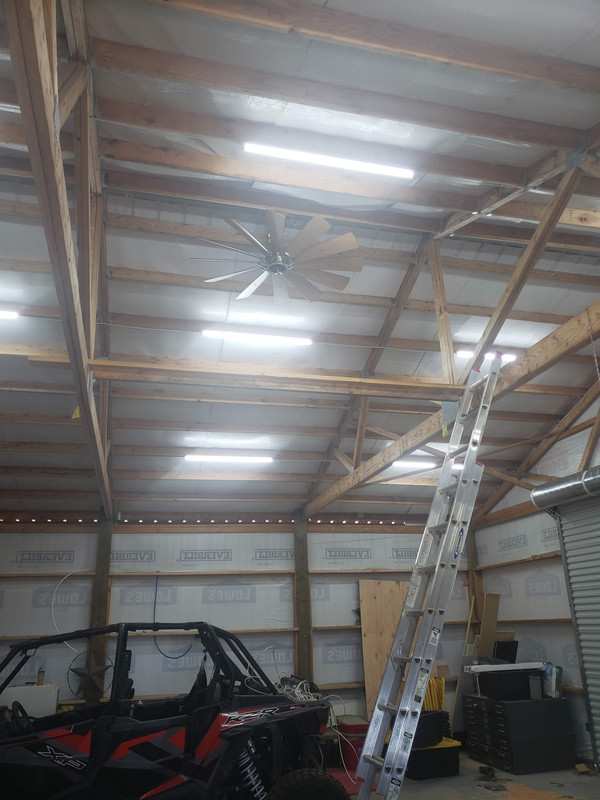

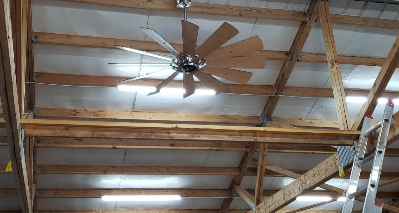

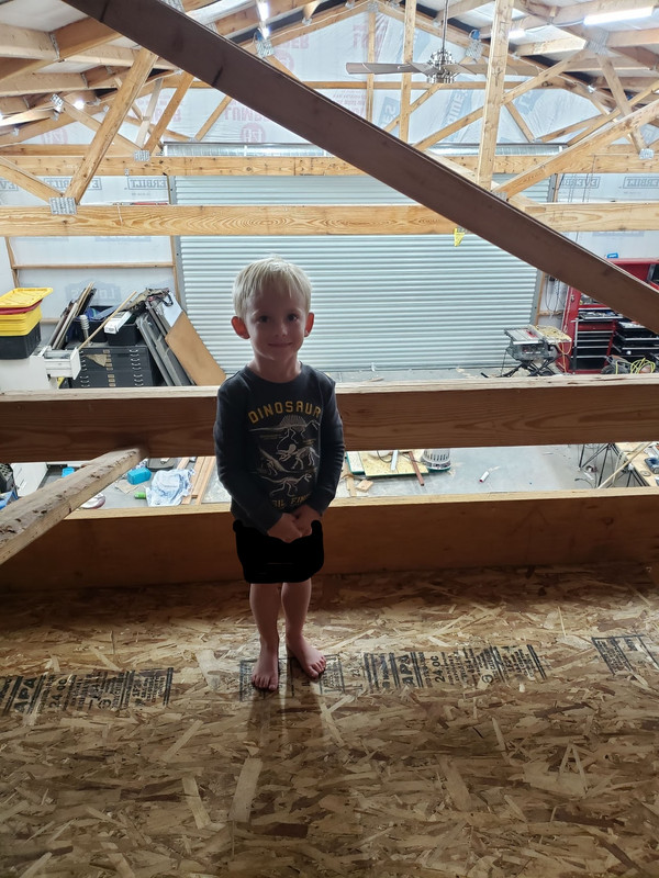

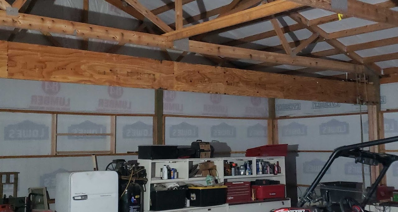

With the house projects slowing down, I got back on the shop. First thing I did was get the get the loft LVL up and frame and rough out the bathroom. Here you can see an interesting use of heavy duty ratchet straps. When you're a one man operation you have to get crafty.
The loft will be 10x36 with just over 8' of headroom at the peak and is set at 9' off the floor level. I had 8' in my previous shop and it always felt too low to me. It will used primarily for storage. The ability to tear a car apart and store the hoods/fenders etc. out of the way is invaluable. There is a 4x8 post at the 12' mark giving me 24' clear span. I went through span and load tables to size the LVL.
From there i realized it was probably a good idea to start pulling wire and install lights so I could actually see what i was working on. I had looked at the cheap 20w barrina led lights on amazon. They have really good reviews but decided i wanted a little more light. I ended up with 16 36w 6000k 4ft led lights and have been very pleased with them.
The fan was actually free to me. We have the same fan but in oil rubbed bronze in the house and one of the contractors broke the glass light cover. To order a replacement would have taken 6-8 weeks so the contractor just bought a new $500 fan for the cover and i kept the fan. Not shown here but i replaced the light with this LED light which actually puts out a descent amount of light.

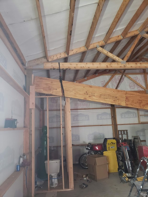

Some of these pictures are going to show a real mess but thats just the way it was when I didn't have anywhere to put all my tools. So the super clean guys might wince at some of these.
At this point i installed a couple windows. I think I had 12 windows in my last shop and the natural light was really nice but that amount was not needed. I knew at some point that I was going to add a lean-to but wasn't sure what side i would add it to so i have one window facing north and one west and i think its going to stay that way.
Then I ran the joist for the loft and put the flooring in. I think 3/4 t&g OSB.

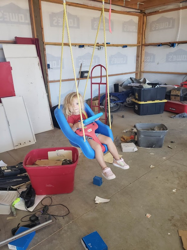

While installing, My wife and kids came out and he just had to get up here to see it. Seems like a bad parenting move but we were safe about it and that was the closest he got to the edge. He wanted a picture in his new room lol

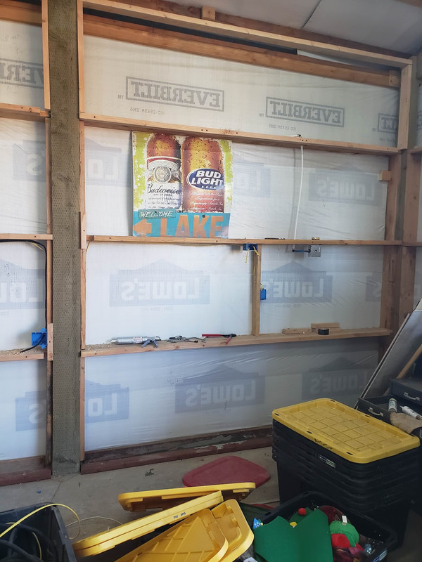

Next was running all the wiring, air lines, and water lines before putting up the walls. I went a little overboard with it but I never wanted to have to open up the walls once they were up or wish I had a more amps at an outlet. I ran
-3 50 amp 6g 220 circuits
-2 30 amp 10 gauge 220 circuits
-1 20 amp 12 gauge 220 circuit (mill)
-20 20 amp outlets and they are on alternating circuits so that no two outlets near each other are on the same circuit and they're on switches by the entry. I did this so I could turn off the outlets when the kids are out there with me. The fab side of the shop can be turned off when i'm not using that equipment

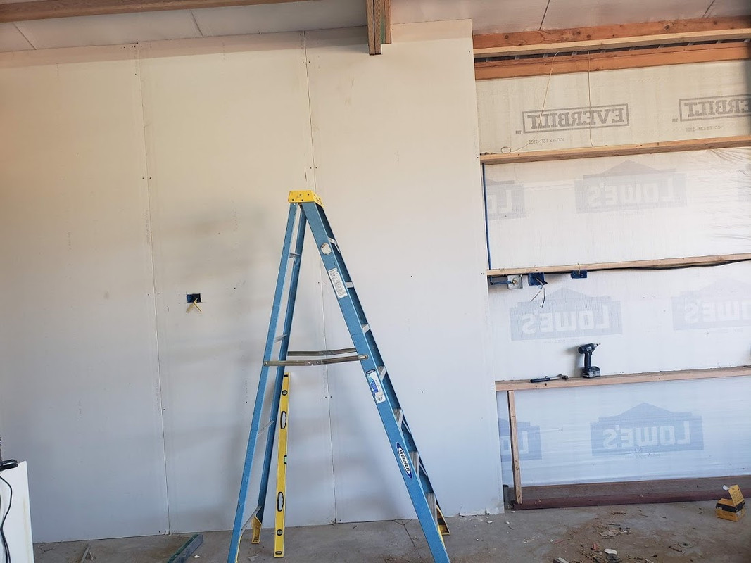

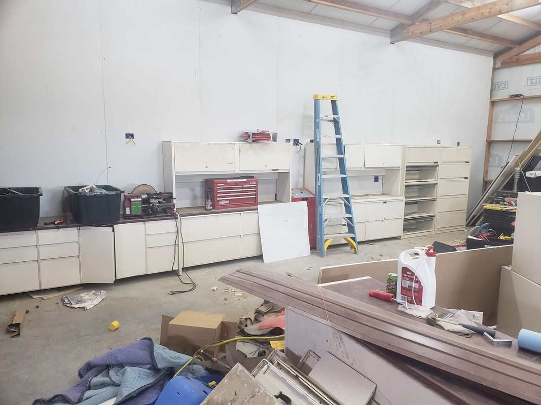

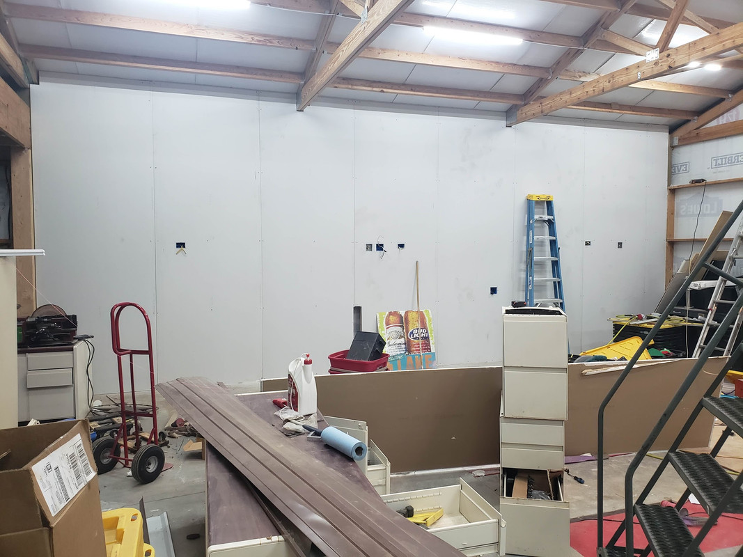

After all that was done I bought the material to finish up the walls. The original plan was for OSB throughout but learning from my last shop, I decided it would be cheaper and easier to do a mix and it would still work for me. The front half of the shop was done in OSB and the rest was done in drywall. hanging 12' sheets commercial style was too easy. The front was done with 10' sheets of 7/16 osb. Both were hung vertical "commercial" with only caulking at the joints so i was able to finish in a day. It felt really good to finally have those up.
I ended up furring this wall out so that it would be flush and not have the post exposed.
The reason why is that I had a bunch of cabinets that were going to live on this wall and I just couldn't come up with a way to fit them in-between the post.

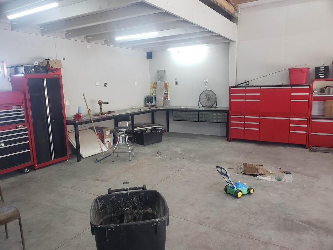

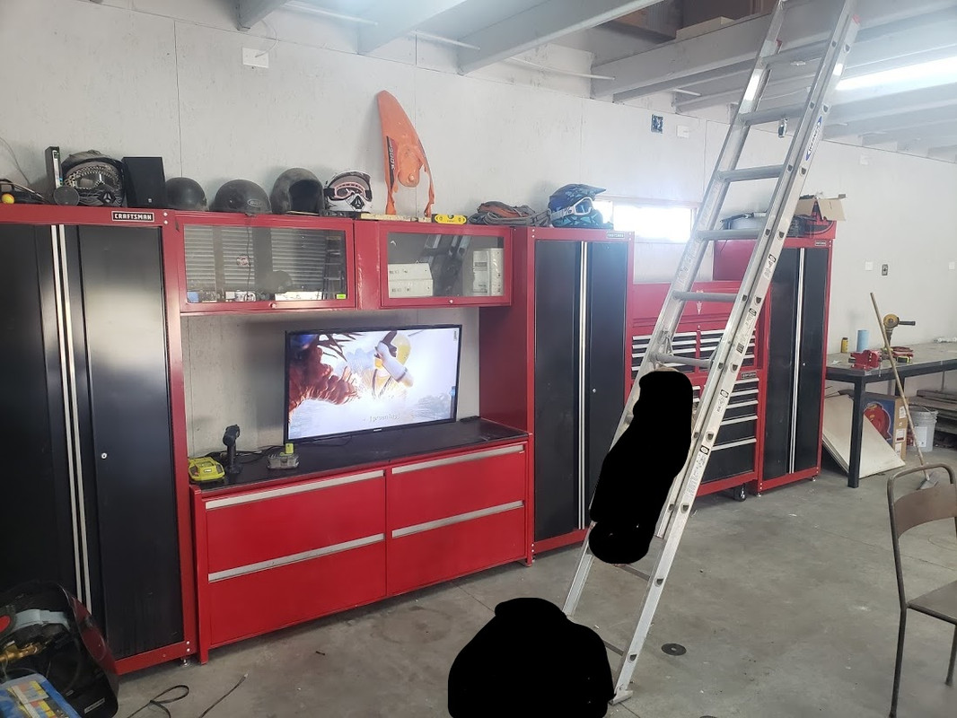

This is when things actually started to get a little more fun out there. I started with this corner that was going to be my clean work surface used for general maintenance and lay out of parts. When i take apart something intricate like a motorcycle engine or similar I like to layout all the parts in order they came off and having a big stainless L bench seemed like the way to go. This was built with 2 1/2 square tubing and 16 gauge stainless tops.
Like I stated before, this was when I was finally having some fun out here working. Being able to finally get tools out of totes and start to organize stuff was amazing.

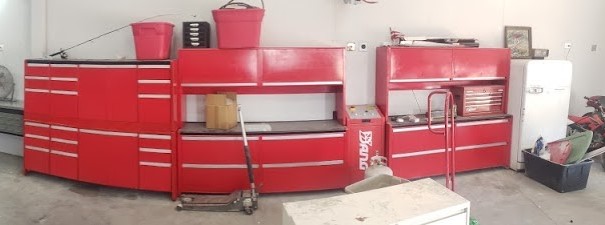

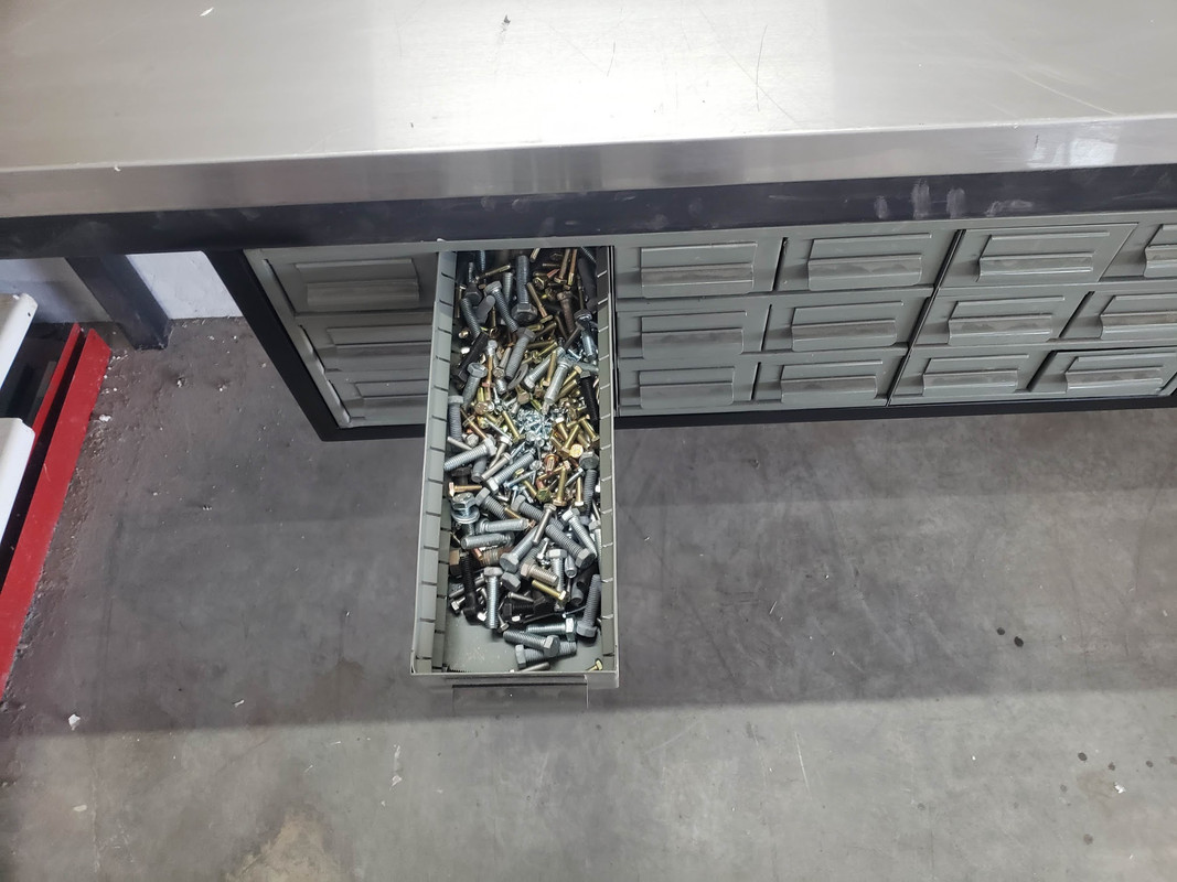

I had some of these hardware cabinets that I incorporated into the benches. I still have one more that I might cut down to fill in the last bit of the bench.
Before I started organizing the nuts and bolts.
I had seen some guys on this forum that had file cabinets in there garages and they seem to work really well for storage. I kept and eye out and i got a bunch of office cabinets that i bought at an auction for almost nothing. I sold a lot of it off and made some money on the deal. They are very heavy and i would guess 16 or 18 gauge and heavy duty slides. I sanded and painted them and am very pleased with how they turned out and how useful they are.
I used them above and below the tv here. I keep manuals and that sort of thing in the upper cabinets and all my corded,air,cordless tools are in the drawers in the lower.

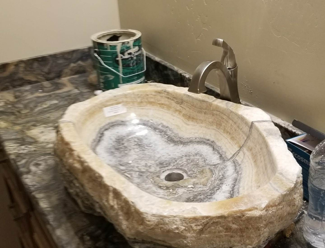

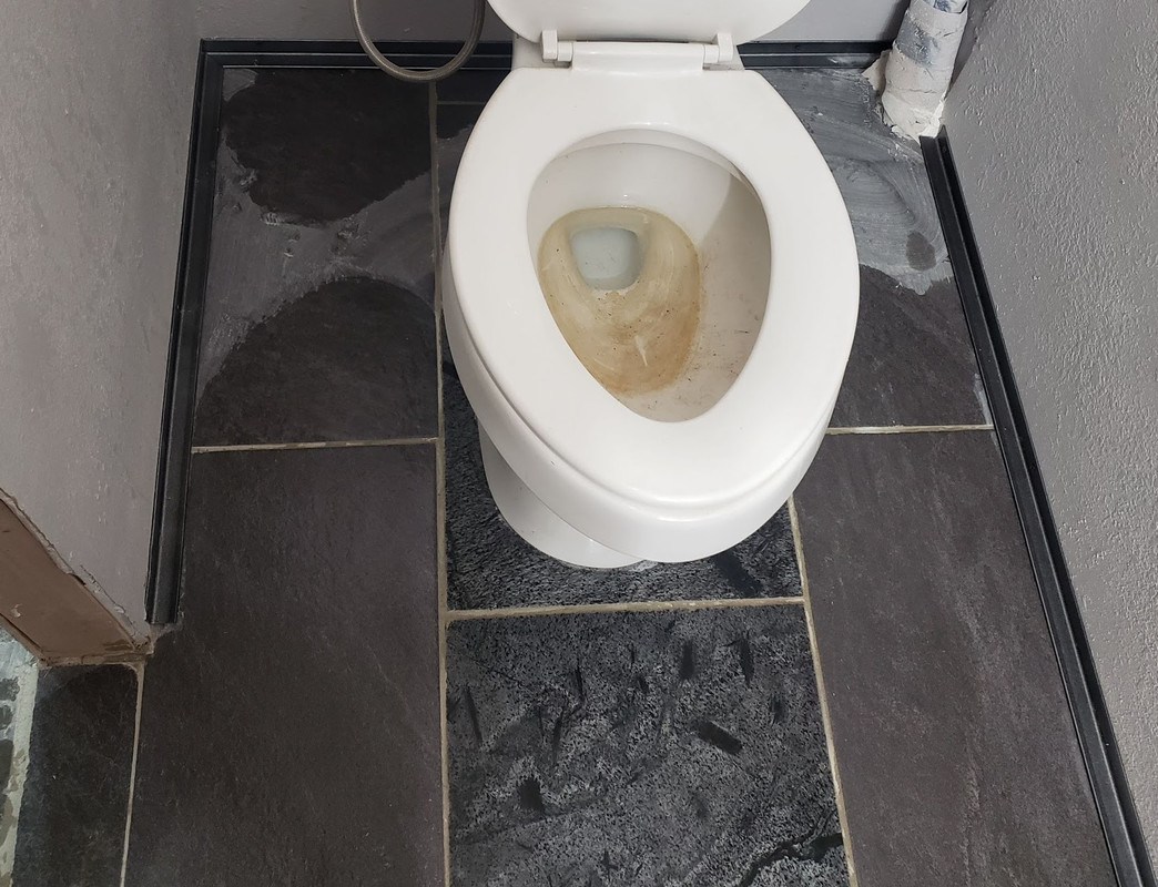

My next priority was the compressor closet (so i could finally have air) and the bathroom.
My hopper was acting up so my knock down texture wasn't the best but hey its a garage bathroom.

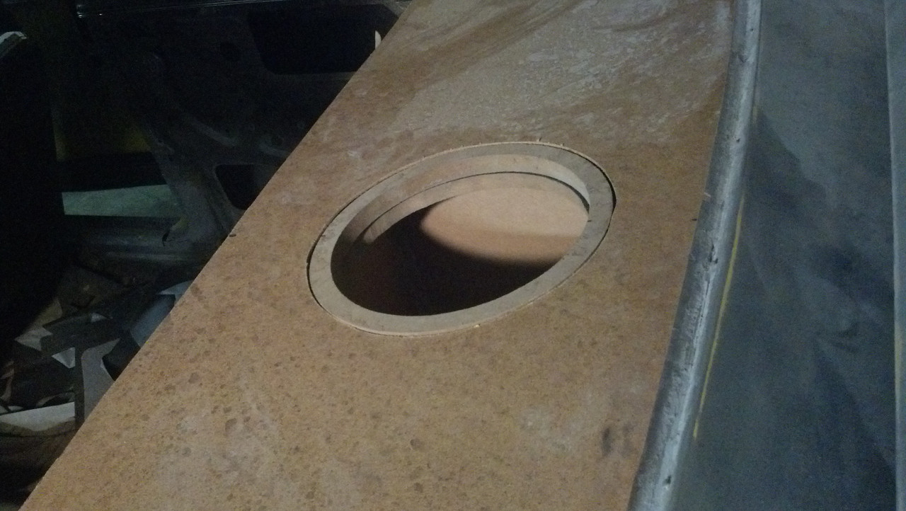

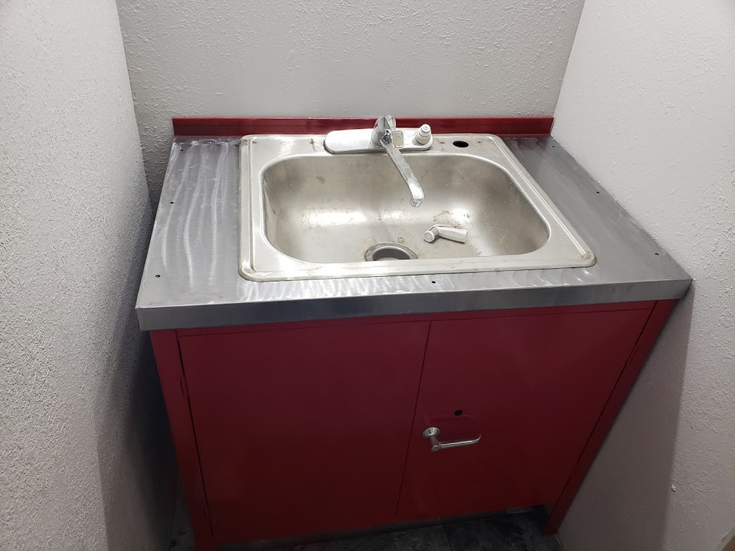

Some more of the cabinets i got from auction were put to use. I bought a sink and faucet off craigslist for 10 bucks and put this together for my sink
The flooring are some left over polished slate tiles that i had from a previous project. I use the open area to the left to hold a small mop i keep in there.
I ended up not having enough of the same tiles so i bought a few tiles that complimented the floor (more so when dry). Completed with angle iron baseboards with a little silicone underneath.
Snap On sticker makes this a luxurious restroom

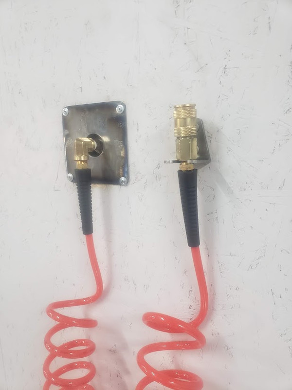

Then it was on to the compressor closet and doors.
Doors painted
I went with a lincoln hose reel with 1/2 hose and fittings here for when i needed full pressure and volume from the compressor. The other two reels are reelcraft reels with standard 3/8 hose and 1/4 fitting.
Here is the mount i build for the reel. Forgive my welds, when I did this, i hadn't tig welded in over 3 years.
Hose reel access
Then I built a little mount for my coil hose over my stainless bench.

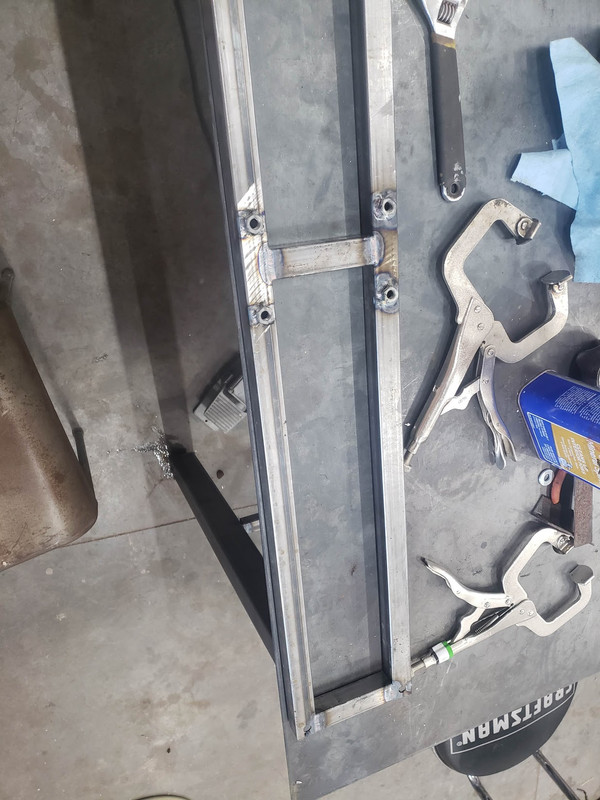

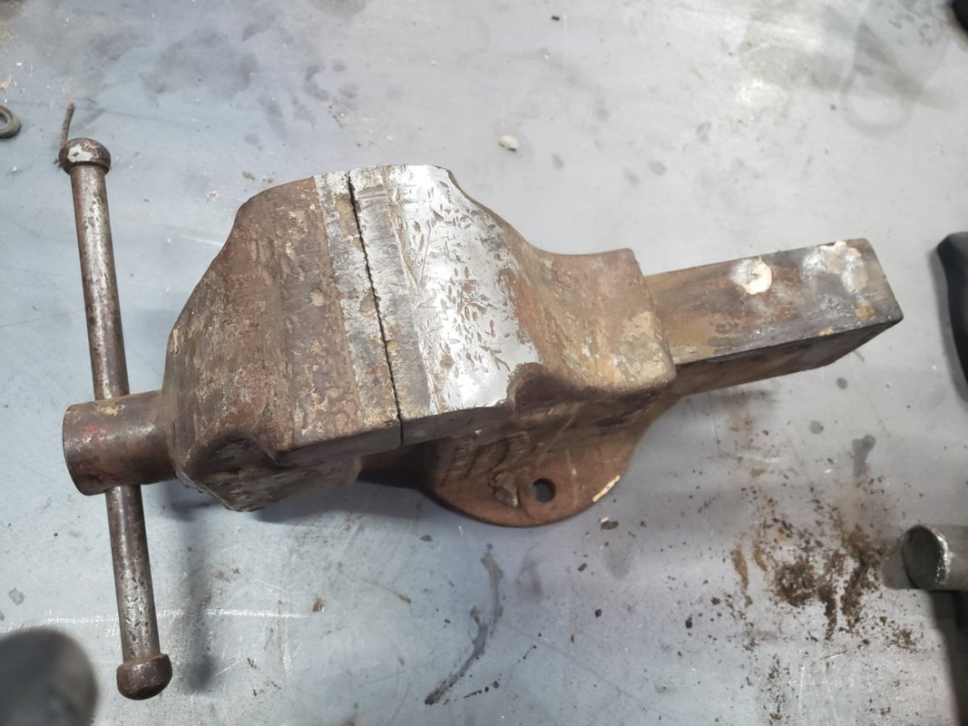

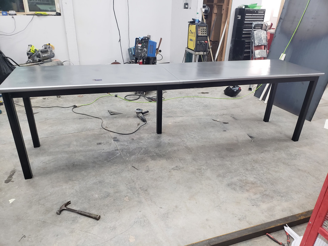

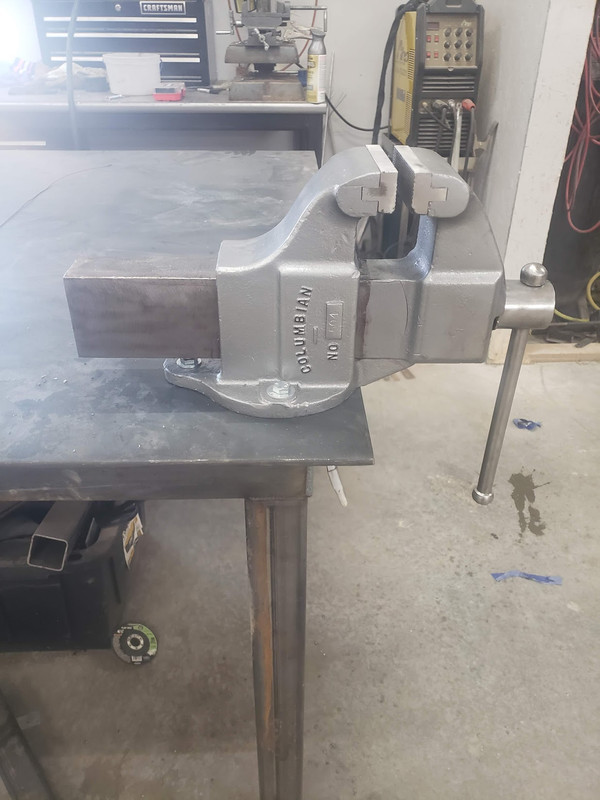

I needed to start on the benches and welding table on the other side of the shop. I think this bench ended up being 12' and I left a nook to the right for a welding cart and left room on the left for my lathe. I kept the bottom open so that my horizontal bandsaw and a few other things could live under it.
Then I moved on to my welding table. Its pretty simple 1/4 inch top and If i remember correctly its 42"x72". My wife knew i wanted a nice vise and this old columbian was her idea of a nice one :) it was still a very nice birthday gift. I decided to clean it up and fix the jaw inserts while i was building the table. Huge thanks to forum member balane for setting me up with some inserts that were in much better condition than what i started With.
I know some guys do amazing restorations on these old vises and won't be impressed by this but my vises get a lot of grinding and welding done on them and I didn't want to take it too far.
Starting to get somewhere on this side of the shop
Then i built this little shelf for scrap metal. Built out of a piece of 18 or 20 gauge i had leftover. I used a small dimple die and made some holes so i could keep the shelf clean but the shelf has quickly filled up and you can't hardly see the bottom.
I really need to motorize my bead roller because I had the wife on the hand crank and i could tell she was ready to slap me by the time we were done.

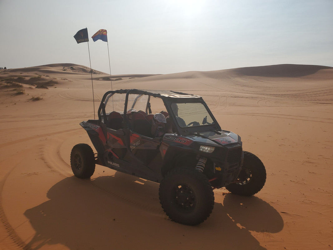

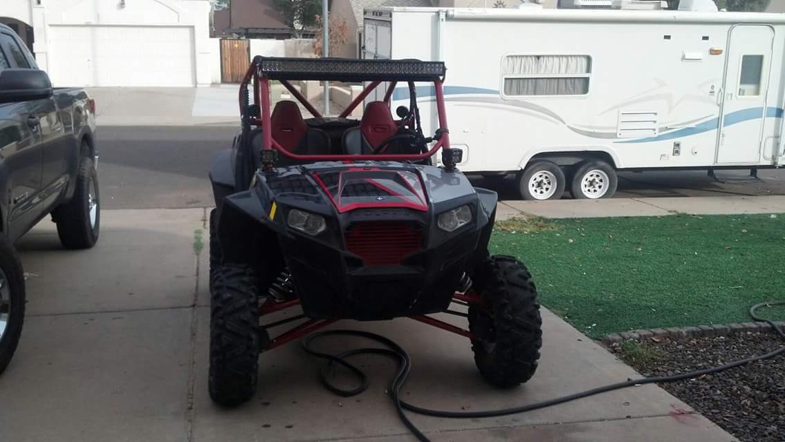

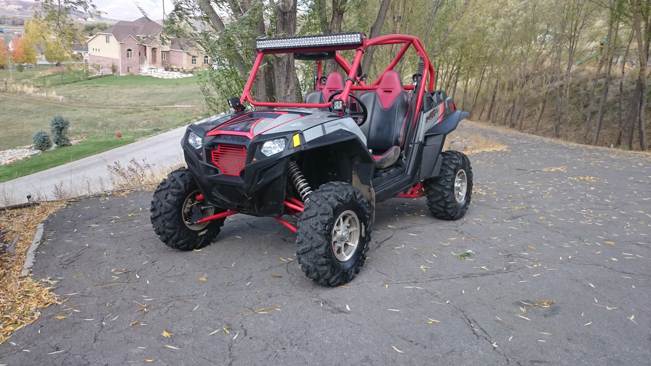

Then came a Teryx with an 840 kit, long travel, and Walker Evans shocks.
Then a RZR that had some goodies
Now i've just got an old man 4 seater that is completely stock besides a radio.

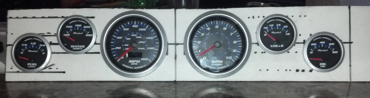

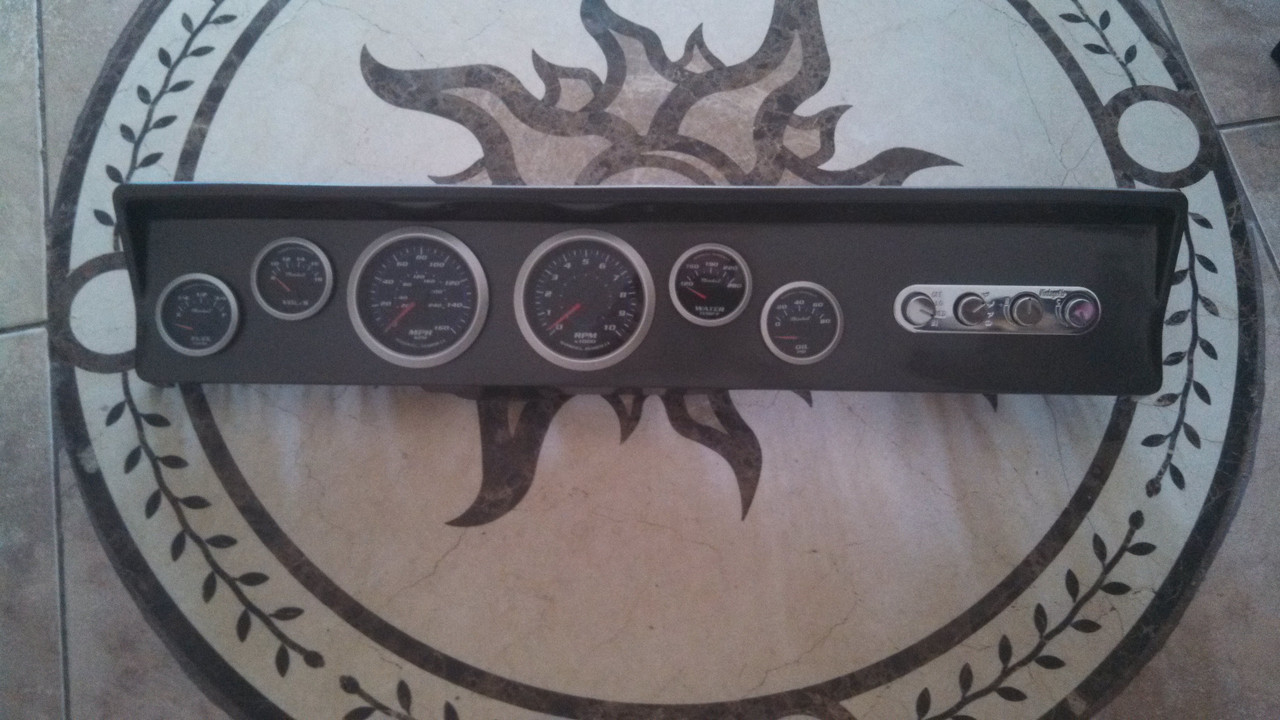

Another thing that went along with the A/C install was the need for a spot to put the controls.
I was missing many of the stock instrument so I had free range to do whatever i wanted.
I ended up making this with new gauges for Marshall. Started with a just a template from foam board.
Transferred that to masonite and fiberglass, body-worked, painted to match

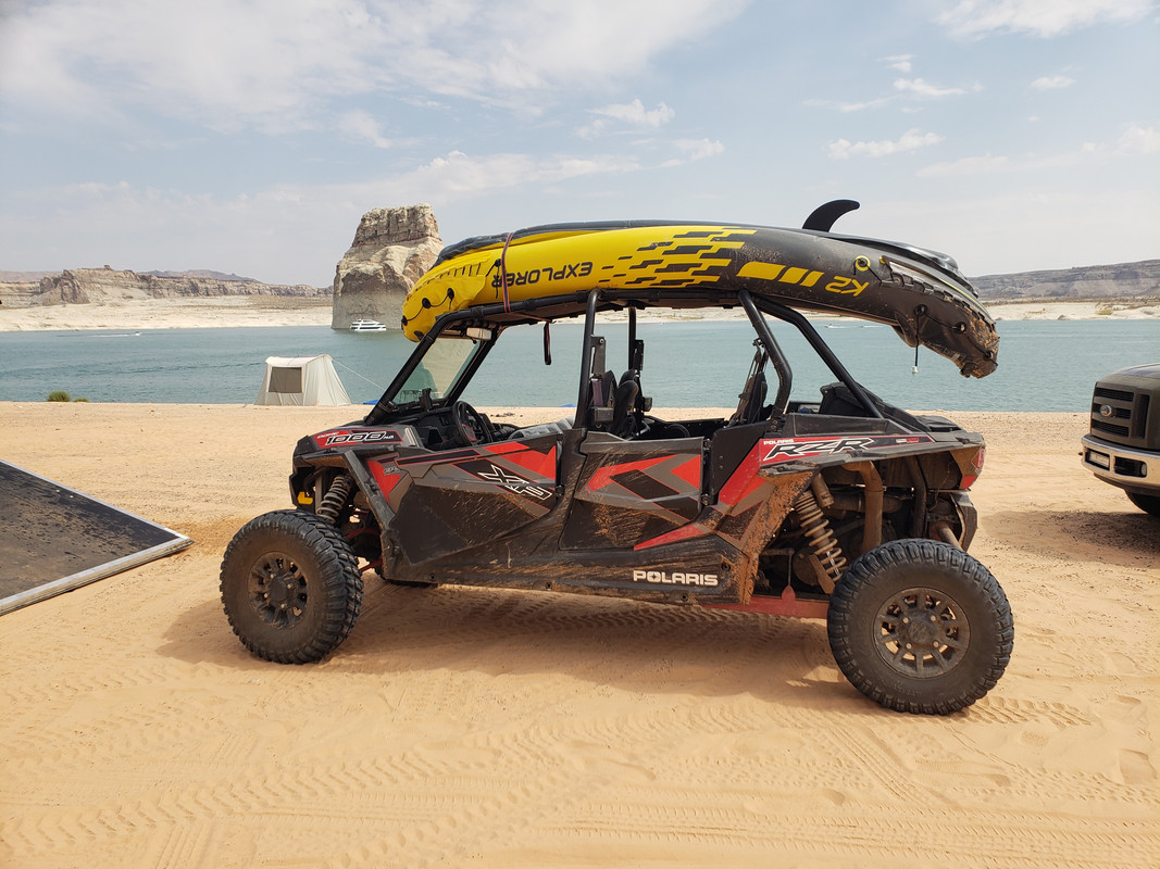

In pic with explorer, Is that saguaro lake in background? Butcher jones?

Good eye! My teenage years were spent at butcher jones and lower sycamore. I would say 50% of my summer nights were at the peninsula of the 1st cove. We would have 4-5 trucks parked on that narrow thing with all of us swimming and hanging out on a little ledge that was just under the water line.

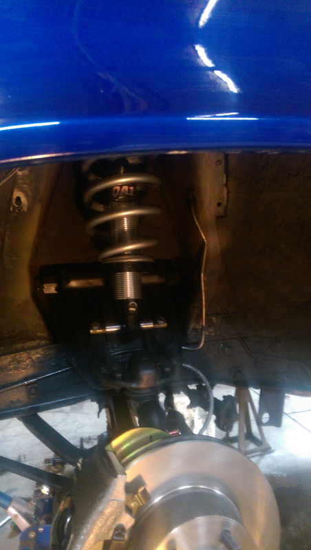

After driving the car like that for a few months I quickly grew tired of the sloppy handling and 3000rpm at freeway speeds.
I bought all new bushing for the front end as well as a much larger sway bar. Then i looked into just upgrading the springs and shocks but by the time I did all that it just didn't make sense for the money involved. At that time they did not make a coilover kit for these 66-67 fairlanes so I measured shock compressed and extended length, and also spring diameter. Then I started looking through QA1 website and found QA1 501C for 70-'81 Canaro/Firebird for around $400 with almost identical measurements. The problem was how the old springs mounted to the control arm. They use a spring perch like the old mustangs. I pressed out the stem and it was 7/8's and the poly bushing for the coilovers was 3/4. Thought about drilling out the bushing but decided on turning down the stock mount. Turned it to 3/4" 2/3 of he way down for a shoulder and then made a snap ring groove.
bottom is the stock mount that came with the new shocks
Old vs New
While its apart i might as well upgrade to power disc brakes and do the shelby relocation mod
