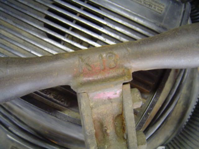

Does yours have any #'s on the handle or base?
Dagnabbit, that's what I forgot to look for, brb. :thumbup:
OK, it has *K 18* on the handle, nothing visible on the base
..but I haven't got it moving yet where I can see all of it. It's still locked up. The handle will raise enough to move the plunger doohicky in & out about 1.5in, but I can tell there's no pressure in there to lift the arm etc. Then it hits something *solid* internally.

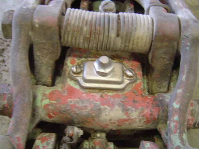

Removed a cover & found where i assume the hydraulic oil goes.. except there's ****** all in there...
So while I had the cover off I cleaned it up a tad... I think the little *** on the top is a breather?
& the handle where the K18 is...

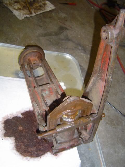

More progress.
This is where I'm at right now:
All the gack is off the parts & the next stage is a bit of bead blasting on some parts & aluminum oxide blasting on a couple of other bits.

Slight set back. Got the ram apart today, it's toast :(
So options are:
1: Paint it red, leave the handle off & hang it on the garage wall as art.
2: Have the extremely pitted ram welded up & reground etc...
3: Find another ram
4: Make another ram.
I'll have pics of the damage later tomorrow.
