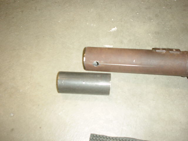

I've always shortened them in the middle, I find it easier to keep things square. I added length to this one-
I did a three pass weld at the end as this is on a 4x4 and doesn't see speed. On a road drive drive shaft I would do a nice single pass and have it balanced.
I basically clamp everything in two pieces of angle iron and tack weld in 4 places and then weld the gaps in an alternating pattern while everything is clamped.
I modified a shaft at the yoke and never had a problem.
Then I modified one in the middle without sleeving it and I got a nice crack through my HAZ after a couple years of wheeling. It got cutout, sleeved, rosetted and **** welded and was fine right up until the 1350CV blew up:mad:
The twist angle the shaft see from end yoke to end yoke isn't linear due to the changing cross section and depending on the wall thickness can be enough to fatigue a single **** weld is all I can gather.

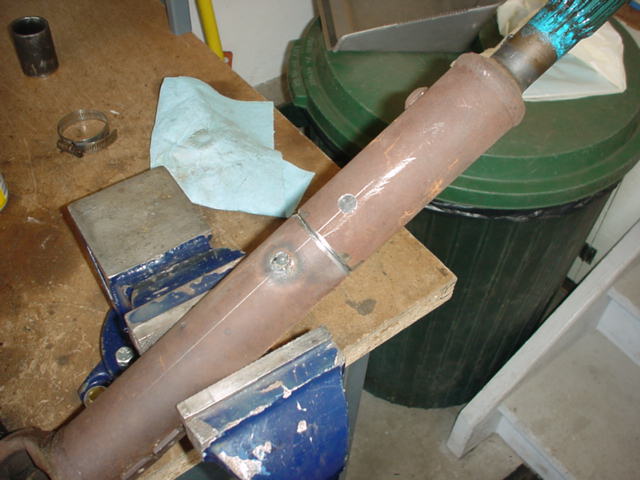

csp
Mar 23, 2010
5,719
Franktown, CO
I cut and shorten in the middle also with a sleeve. One thing I always do before cutting is to draw a line down the lenght of the tub so that it can be assembled back in the same phase that it was in before cutting.
