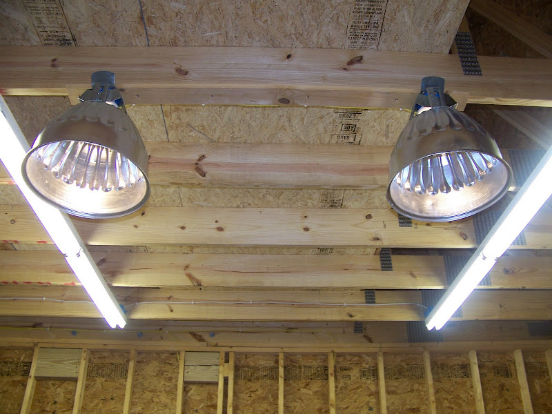

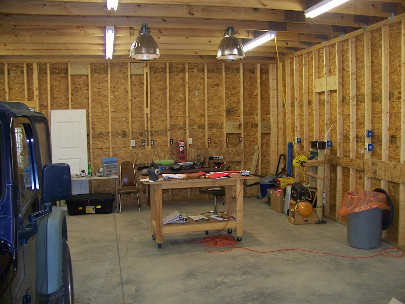

Here are my cheap workbench lights. I used some free highbay shades on standard 120v fixtures with a dimmer.
