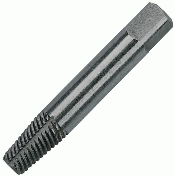

Square taper:
These are joint personal favourites, along with my Rennsteig "cross-taper type" (I just made that term up). These are Proto, but I have seen them labelled as Armstrong and others. Snap-on also makes some similar ones with a twist in the end and they work equally well IMHO.
Cross taper:
These are made by Rennsteig and I've had very good luck with them. Unlike the Protos above, these work in both directions.

how does that square taper one work? is it just a matter of pounding that in with a BFH. They look huge, what size bolts would you use that on?
Please see attached shoddy picture to give you an idea of the cross-section of that extractor:
The taper helps it 'bite', but also, as with all tapered extractors, can work against you. The harder you beat them in, the more they expand the bolt into the housing/flange/whatever.

The square tapers are the best in my experience, I have Proto (recently picked up 2 sets for $3) and Craftsman, not sure if Craftsman still has them but they used to warranty them when you broke them.

The "Spline" type seems to be popular over here:
"Belzer"
"Hazet"
"Kukko"
"Gedore"
"Stahlwille"
The "Wiha" ones look like the "Hex extractor" type

Monte,
How do you like using the Belzer "spline" type extractor set?
Are they the most effective bolt extractors you own or used?
If not, which bolt extractor type is the best you have used in automotive work?
Thanks,
Dave
Hey Dave,
until now i only used the screw type extractor (1 broke off...), pliers, welder and Torx bit as well as drilling out the complete screw. No hands-on experience with the spline type. I bought it because i got it for just 10.- €. Maybe later this year i can tell you something !
It depends on the broken bolt/screw which is the best method. A small, soft crosshead screw can be removed with a Torx bit where the splines of the bit can cut into the screw, on harder bolts this is not possible (grade 10 or 12 etc.) so the spline type with a prior drill hole might work. On a exhaust system heat could be used e.g. so a heated exhaust flange and a pair of pliers might work or a welded on nut. A stud puller might work sometimes too. But heat cannot always be used. So it´s the best to have several options. A welder, oxy torch, and extractors like the "spline type" or the Facom type makes the most sense imho. Conical "screw type" extractors can widen the bolt and press the bolt into the thread make it harder to remove and can cause the extractor to break.
So i would try out the spline type and/or the Facom type.
Facom drill bit
Facom extractor
or try these out: Schröder "Hi-Trac" with extra cutting edge. (in combination with the Facom drill bit)
