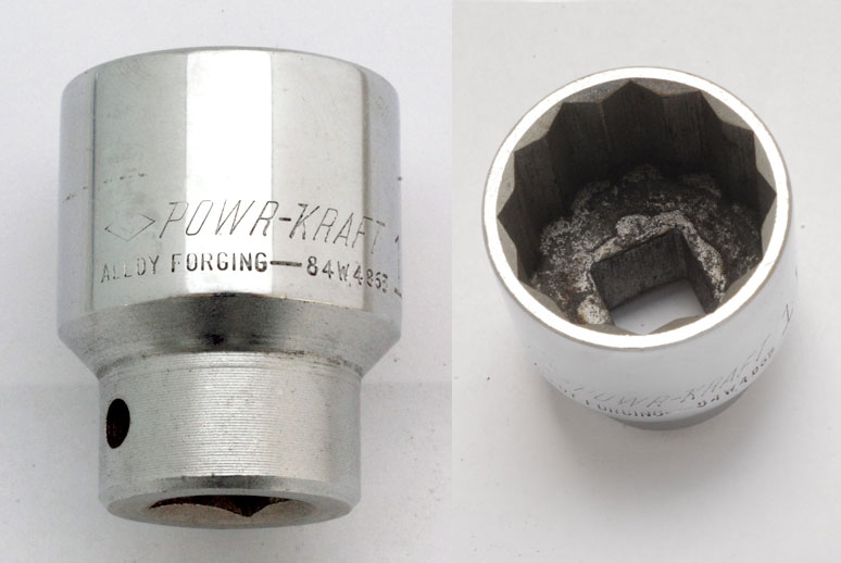

Are powerkraft sockets with the symbol picture below actually made by wright?
also what would a bunch of good non rusty powerkraft sockets sell for each?
thanks
sk farmer
Mar 4, 2009
5,574
nd
a very good chance but they also sourced them from other places i believe

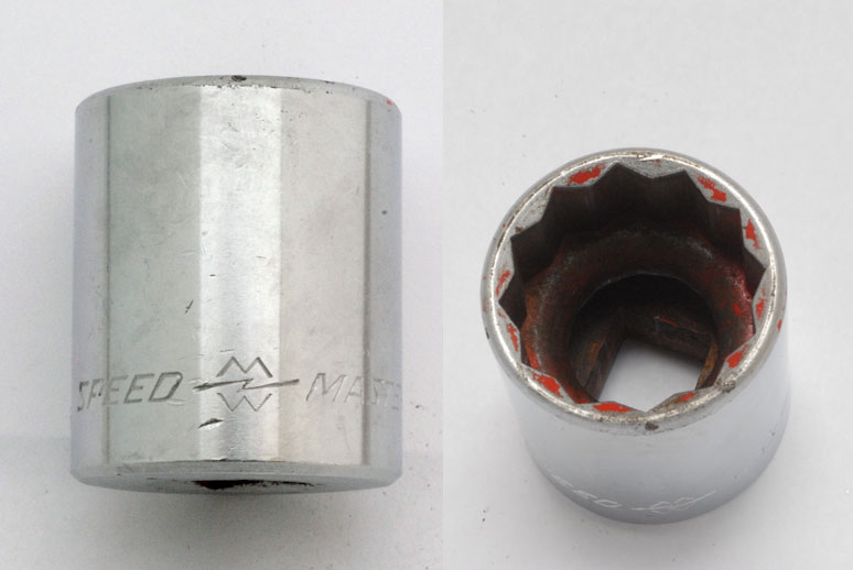

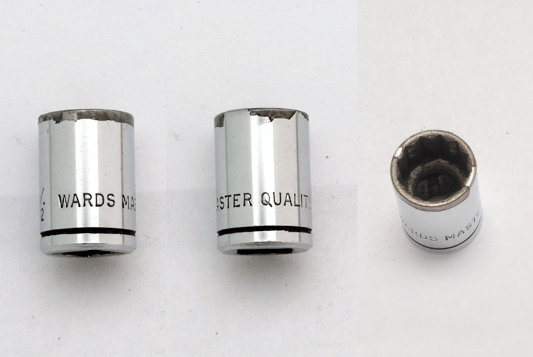

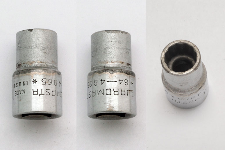

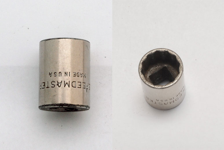

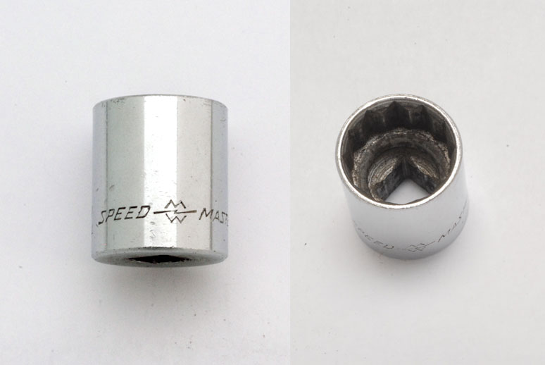

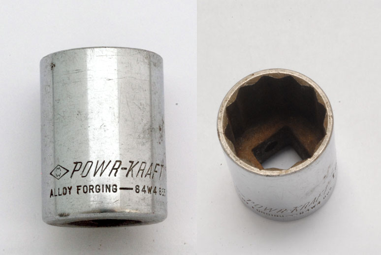

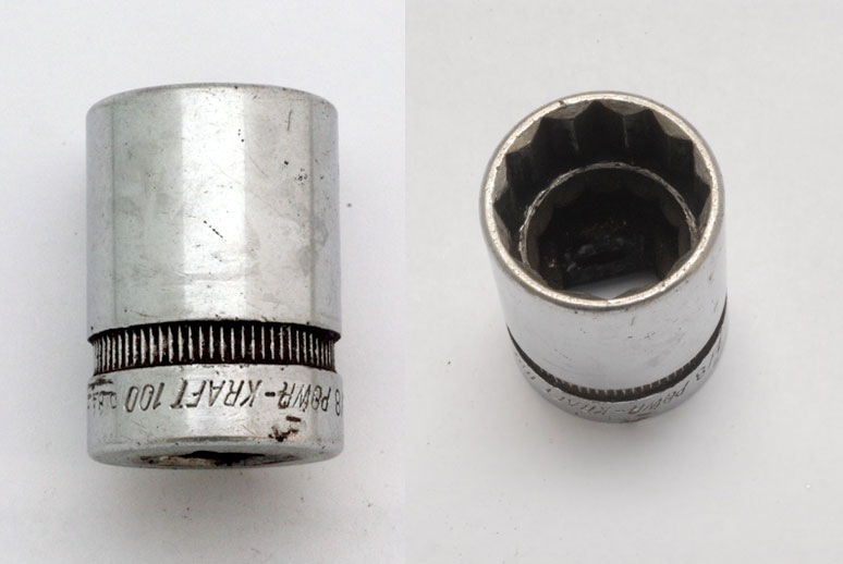

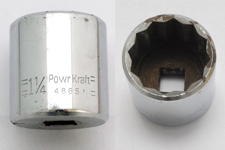

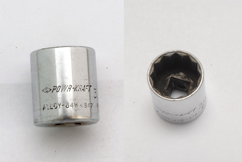

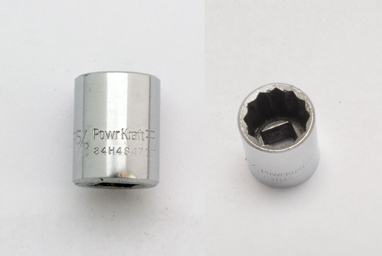

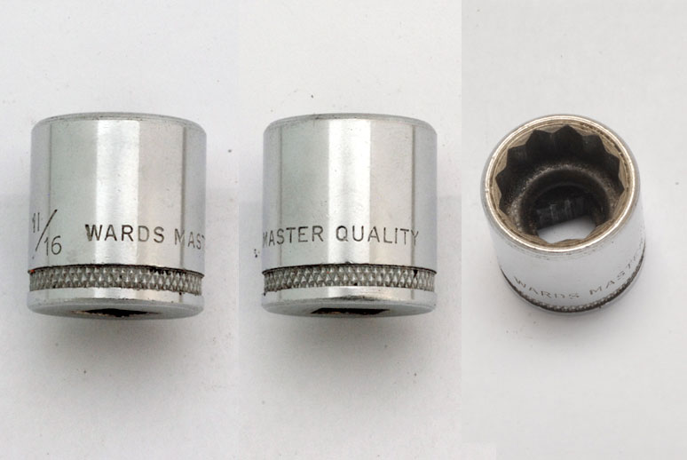

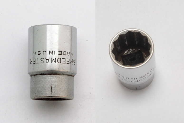

Here's a challenge for the GJ community: identify the OEM and timeframe for these Montgomery Ward sockets
MW logo PowrKraft
MW logo SpeedMaster
SpeedMaster Made In USA
Wards Master Quality
WardMast'r
Powr-Kraft 100
newer PowrKraft

I think the "newer PowrKraft" is OEMed by Thorsen, based on similarities of the chrome finish and the size/brand imprint.

I took some picture while doing my favorite thing, sorting sockets :mad:, forgot to take a pic of a Bonney, I'm pretty sure the the knurled ones are Bonney. Here are some wild guesses and a few pics. I think it's really hard to tell, even the same manufacturers changed design/style from year to year (look at the Wrights).
Powr-Kraft 100 = Duro-Chrome/Indestro?
WardMast'r = Stanley?
Wards Master Quality top one = Bonney?
Wards Master Quality bottom one = SK or SW?
SpeedMaster Made In USA = Stanley?
MW logo PowrKraft (bottom ones) = Stanley? I think I've seen Wright in that style, not sure, Anyone know?
MW logo PowrKraft (Upper) = Wright?
MW logo SpeedMaster = Wright?

My thoughts are in RED - I'm not gonna attempt a time frame without many catalogs. It seems to me that Wards jumped back 'n forth several times and/or sourced from multiple sources at the same or overlapping times. The earliest ratchets I've got (I believe) are Duro/Indestro (pressed head), followed by Wright (Speedmaster slide button), then a jump to Proto/Penens (Penens style pear head) - or maybe reverse the order with the early Wright - back to either Wright (round head) or Duro/Indestro (round head) - or vice-versa those two as well - and ending (US production at least) with Thorsen (round head).
MW logo PowrKraft Wright
MW logo SpeedMaster Proto/Penens
SpeedMaster Made In USA Wright
Wards Master Quality Top Duro/Indestro, Bottom Proto/Penens
WardMast'r Wright??
Powr-Kraft 100 Duro/Indestro
newer PowrKraft Thorsen
