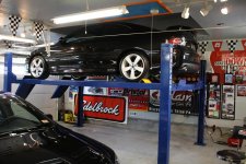

Here are some pics of my new HD 9 lift!
And my ceiling that I vaulted, waiting on the parts for my high rise door track. Enjoy!!

Nice new lift. It doesn't look like you can go up too much with your door maybe 12" or so from what I can see in the picture. But how much usable vertical space will you gain in doing this since you have the limiting factor with the vaulted area that you created.
Also, just curious are you getting your door parts online? I had a tough time finding the garage door parts online that I needed.
If I gain 8-10 inches that will allow me to park the G8 underneath!
I had my local garage door guy order my parts.

Updates, Jeff at BendPak hooked me up with these nice aluminum approach ramps. New Liftmaster opener. And SharkFin antenna for my G8 for clearance for my lift.

Can you give details on how you did the ceiling?

I love this idea and could see myself doing it if we never move. I'm almost 6' tall. How much room do you have under the car at full lift? What was the cost in redoing the ceiling? Thanks.

Hi Chris can you tell me how high your ceilling is not the vaulted ceiling the ceiling under the hood of your car.
Matt
I am 6' tall and if I spread my feet a little I can stand up.:thumbup:
Thanks Howard
9' 3''

Hey Chris I'll be reading as much as I can on the topic, thanks for the info. I have a 10-0 ceiling, and would like to stack 2 fairly short sports cars. Everytime I get excited about the possibility of getting a lift, reality sets in that it can't fit 2 cars.. without some changes.. so I'll be studyin up on it. Let's see more on the door and tracks. Mine are hung in the usual spot, a couple feet or more down from the ceiling. So getting the door up higher would be required.

First off I had high rise track install for my garage door, it makes your garage door stay closer to the ceiling. Then I added a Liftmaster jack shaft opener.
I think that you can see them in some of the pics in this thread, if you need better pics let me know.

My GTO roof height is 54.9 and that leaves me about 59 underneath. However I think with a little more tweeking of my garage door I think that I can go up to the next notch so that would give me 4 more inches underneath.
