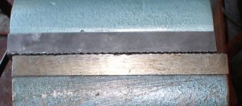

I took my chances picked it up at a garage next to a gas station. I didn't know what it was at that time because it was covered by a horrendous amount of grease and metal shavings. no brand casted into the body, also the jaws were broken and pipe inserts were missing. the only hint I got was the brass end cap at the back of the vise looked like a Wilton. it turned smoothly and didn't make any noise.
I got it back to the shop, scrapped off about 1/2 a coffee cup of grease, took it apart, then dumped everything in the solvent tank for 4 hours. at the same time, I dug out a piece of scrap 1/2" 6061-T6 aluminum plate, made a pair of jaws on a band saw and mill.
here are the pictures after I put it back together:

It sure looks like a Wilton, maybe a knockoff. But for $25.00 it's still a good deal, nice job on the jaw pads.

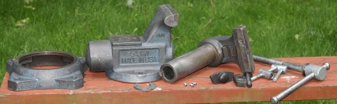

My 1750 taken apart for a thorough cleaning.
Nice comparison photo, a later production Wilton that was made here in the middle/later 90's that Wilton discontinued. That newer generation Wilton is today's style. They eliminated that back cap housing and moved it inside the tube. One excellent find!
