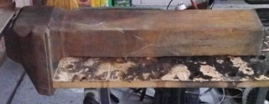

After 20 hours in the tank, the handle is 99% rust free and I think I am going to try and polish it back to silver then seal it with Flitz.
The main body is in the tank now... it will probably need several turns and a few days to complete.
I'm new to this... should I keep posting pics of the progress?

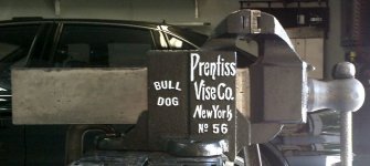

Here is the static jaw all primered and painted... still need to do the lettering.
The sliding jaw/beam should be done tomorrow and then I'll be working on the garage mount.
I decided to leave the scars on the vise... it does give it character and shows it has a long story.
I did not find a date stamped on it anywhere... but I still need to check the sliding jaw closely after it's out of the electrolysis tank.

I already had to weld the heck out of the slide... It was beat so much it had a 12" crack in it that was 3/4" wide at the end of the slide. I spent 4 hours pulling it back straight again, pre-heating, welding, and slow cooling the beam. I just did not know if I could fill in some more of the sag (caused from the history of abuse... beating on the slide as an anvil). Currently the sag is less than 1/8" and only in the area outlined in red. I am happy enough with this since it does not affect operation one bit, and the beam is lined up perfectly.

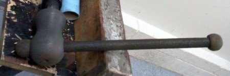

Another late night with my vise...
White lettering is done.
The handle is starting to turn silver with a lot of work... but I like the results so far.
The sliding jaw is out of the tank and waiting for some touch-up welding / flap wheel, then paint and polish...

Finished with the vise!
The 3rd pic is my celebratory beer.... I don't drink much, but this was a special occasion.
Last night even my wife said it looked good. Up till now she thought I was crazy to put so much effort into a "hunk of rust".
