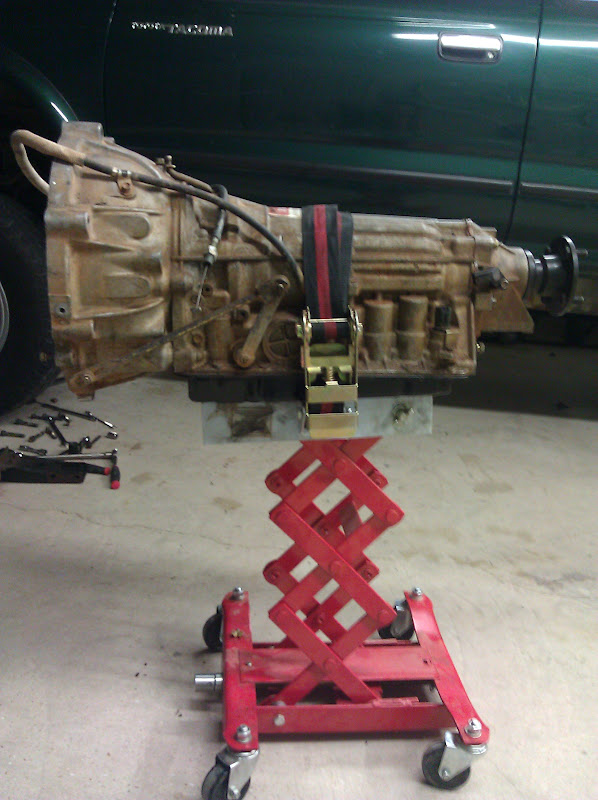

I bought the Harbor freight 1000 lb lift table. I then drilled holes along the long sides and then attached 2x4s along the top sides. They are secured with screws up from under the table. Once those two pieces of wood are attached you can add or make any type of cradle quickly.
I used this to pull the ****** on our 99 Mustang Cobra to swap clutches. Worked like a charm and its about the right height. I also intend to use it to make a cradle for the Corvette rear assembly when its time to do a clutch on it.
I recommend it. The only draw back is its a little wider than a typical ****** jack.
