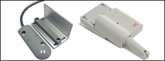

I've always just tied my garage doors into my home security system using senors similar to those posted above. It works, but it's admittedly clumsy. The wireless outfits ar...

Loking at the video, this might be another reason for jackshaft operners, such as Liftmaster 3800. Not only is it a "non standard" opener, it also puts a locking pin in the way of a roller.
I have used the magnetic sensors just like the first one's shown for over 10 years. Never had a failure or false alarm. Mounted on each side of the door so it can not be pryed from the corner without detection.

here is mine
Description
The Garage Door Sensor is specifically engineered to monitor and secure roll-up garage doors. Placed on the top inside panel of your garage door, the device sends "opened" or "closed" signals to the Control Panel based on the sensor's pitch passing 45 degrees. Installation of this sensor is very easy - simply "peel and place."
Features
Mounts on Top Inside Panel of your Garage Door
Wireless Transmitter Means No Wiring Required
Reports Open and Closed Status to Panel
One-Second Delay Helps Prevent False Alarms
Security Cover to Protect Against Tampering
