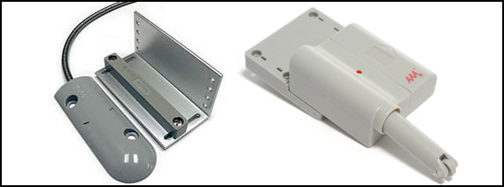

Garage Door Security
I’ve always just tied my garage doors into my home security system using senors similar to those posted above. It works, but it’s admittedly clumsy. The wireless outfits are scary simply because they are battery powered. The wired units seem more industrial and I have had decent luck with them, but I’ve always wondered if there is a better way… or perhaps a more secure backup.
What do you guys do to secure your garage doors? Extra locks? Alarm sensors? Something else? Fill us in without giving away your security.
See Comments on the forum.

I have used the magnetic sensors just like the first one's shown for over 10 years. Never had a failure or false alarm. Mounted on each side of the door so it can not be pryed from the corner without detection.

I have installed 100's of the magnetic sensors and most of the call backs are because of physical damage. Rarely is there a problem with false alarms as long as they are installed properly. The best location for a mag sensor is actually at the top of the door, not on the floor.

here is mine
Description
The Garage Door Sensor is specifically engineered to monitor and secure roll-up garage doors. Placed on the top inside panel of your garage door, the device sends "opened" or "closed" signals to the Control Panel based on the sensor's pitch passing 45 degrees. Installation of this sensor is very easy - simply "peel and place."
Features
Mounts on Top Inside Panel of your Garage Door
Wireless Transmitter Means No Wiring Required
Reports Open and Closed Status to Panel
One-Second Delay Helps Prevent False Alarms
Security Cover to Protect Against Tampering
