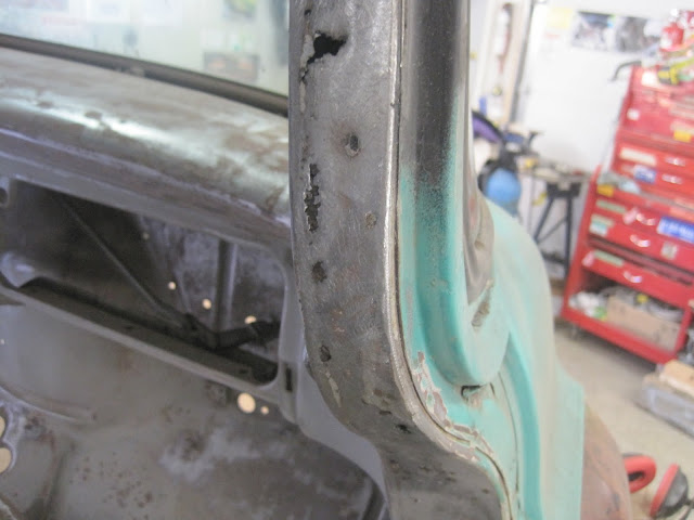

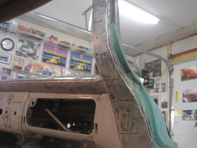

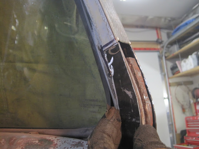

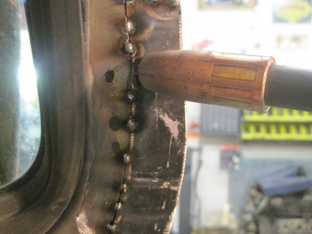

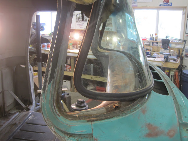

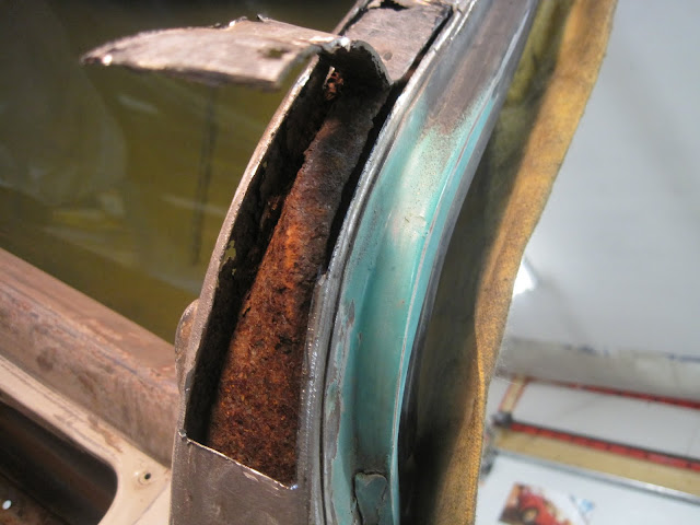

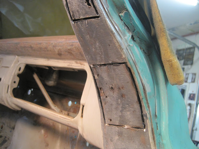

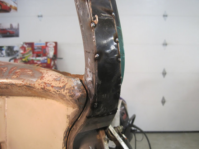

Can I play?

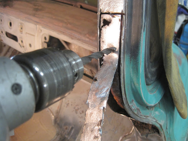

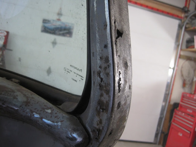

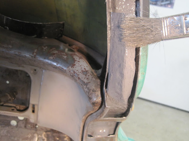

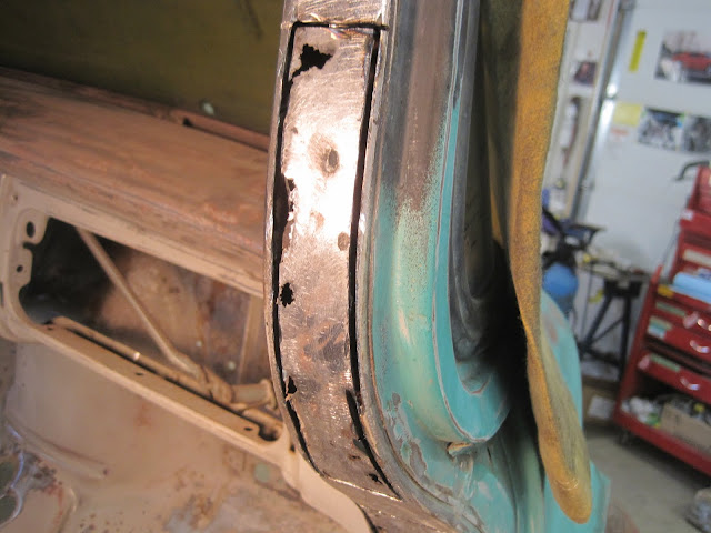

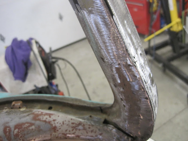

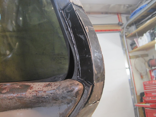

a W/S pillar -
I brushed POR15 into the inners as far as the brush would go, but now I've found Eastwoods Internal Frame Coating, whcih has both Zinc and oils and an 18inch long apllicator nozzle that spraysout at 360 degrees! I'll be able to apply it now from under the dash, but it would have been nice to use it here!
