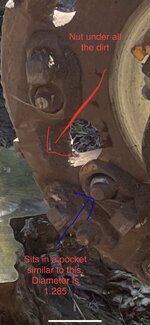

Like the title states I’m looking for a 1/2” drive 15/16 swivel impact socket. Shallow. Thin wall. Used to replace stump grinder teeth, the nuts on the backside of the teeth sit in a pocket and a regular impact won’t fit. Thin wall impact and chrome fit inside fine. Most of the teeth are a straight shot from the side with a regular impact gun and aren’t an issue. The teeth on the leading edge of the wheel are tricky to get to. . Thanks in advance for any help !

How are you going to get a swivel impact socket to stay still in the lathe? I have never used a lathe so it may be simple, but seems problematic to me.
It’s only about 3/8” in length that needs the reduced diameter. So I was hoping to be able to grab A little of it in the chuck and just reduce turn down the end a bit. The Hopefully this pic clarifies a little.

The larger 3/8 impact universals like that have service survivability issues for some reason (they die easily) plus being that large of a fastener on somer like this 3/8 may not cut the mustard power wise

If you have access to a lathe or know some one who does turn down a standard swivel impact or do what I do with no lathe and use a grinder to make it thinne

Torqued to 150 ft lbs.
