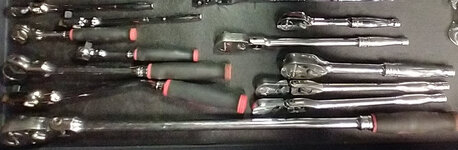

Maybe I made a mistake but my 1/2" setup is:
SF80A 18" flex 80 tooth ratchet
paired with a SN24C 24" Breaker Bar
I also have the 10" SK 42470 round head which I got mostly to round out my set of all three drives in the classic MiUSA SK ratchet while I could still get them new a few years back before they are offshored. If I were doing it again I'd get the Quinn from HF sealed ratchet MiTaiwan. I'll probably get one anyway to complete the trifecta of those since I got the 1/4 and 3/8 and like them for what they are and the price.
My theory is while I could have gotten a single 24" flex SO ratchet, I opted to get an 18" ratchet with a 24" breaker bar. I'm skeptical of the claims that the 24" ratchet is as strong as a breaker bar. Maybe it's 90% as strong but it can't be equally strong, and as a home gamer, I can't count on warranty and I dont have multiple duplicates or coworkers in nearby bays to borrow tools from.
If my ratchet breaks, that might be a very expensive series of Uber trips or a tow and downtime from my life and job.
I figure 18" will get into more places than a 24" can so it's more useful. And if I need more leverage, I got the 24" breaker bar. I can even use the breaker bar for more length, if needed.
And if 18" is too big, I can probably use my 10" fixed head 1/2-drive or a 14" flex 3/8" drive" with overlapping sized fasteners.
I haven't bothered getting a smaller flex ratchet because if it's a confined space on a fastener at 19mm or under, I should probably be using 3/8 drive, but if I am using 1/2 it's because I needed extra torque that 3/8 couldn't handle and using a flex head will cut into my torque ability and frustrate me.
If I need to us a stubby 1/2" drive flex head because no larger tool will fit and because 3/8 lacks the torque, then it's probably a fastener I can't remove by hand anyway.
