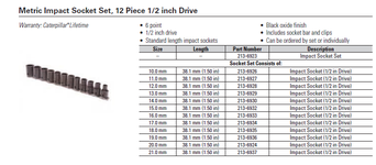

If you are OK with 12 pts, CAT chrome sockets are reasonably priced. 199-6156 should run about $85-$90 from the dealer. They don't have 6 point chrome sockets in 1/2" drive. You have to get impacts for that, but the CAT set, 213-6923, stops at 21mm which is kind of weird and its around $115. They have 1/2" 12pt impact socket set, 575-2413, which is more complete and should be around $125.
